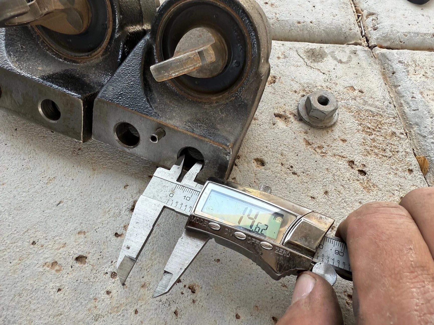

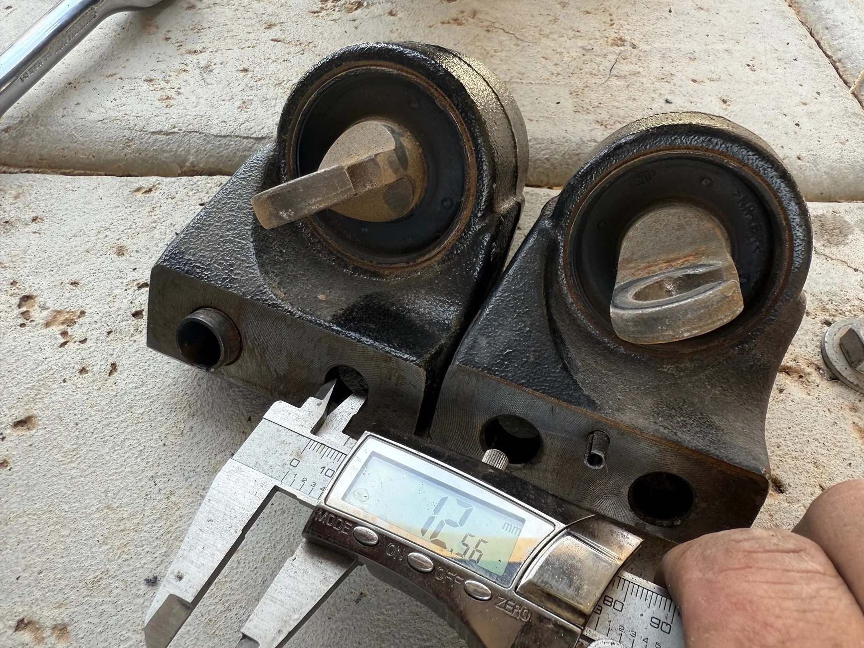

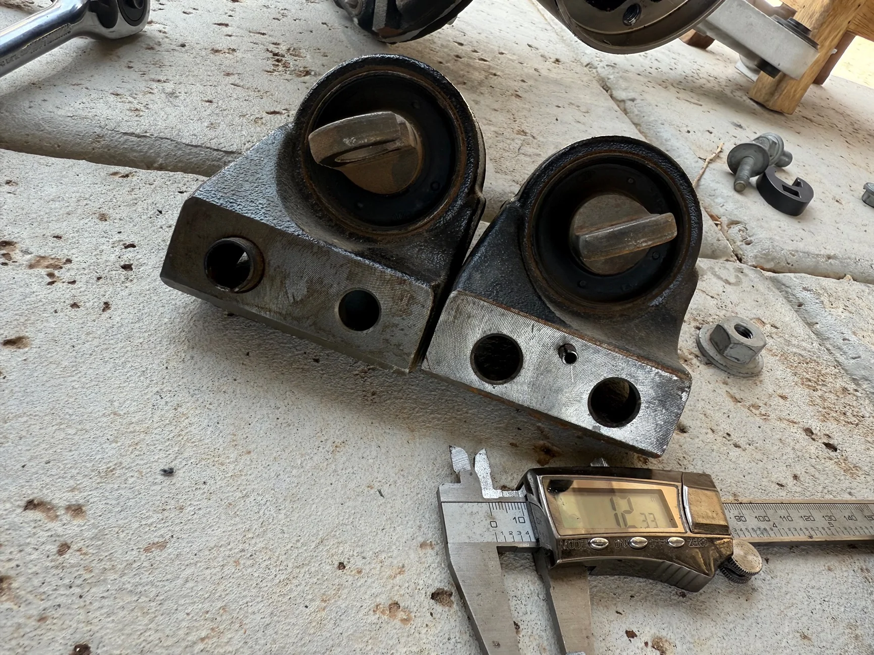

It’s bigger than M210. I found out the hard way
Ford Bronco Differential drop options? IMG_6884
Ford Bronco Differential drop options? IMG_6886
Ford Bronco Differential drop options? IMG_6887
