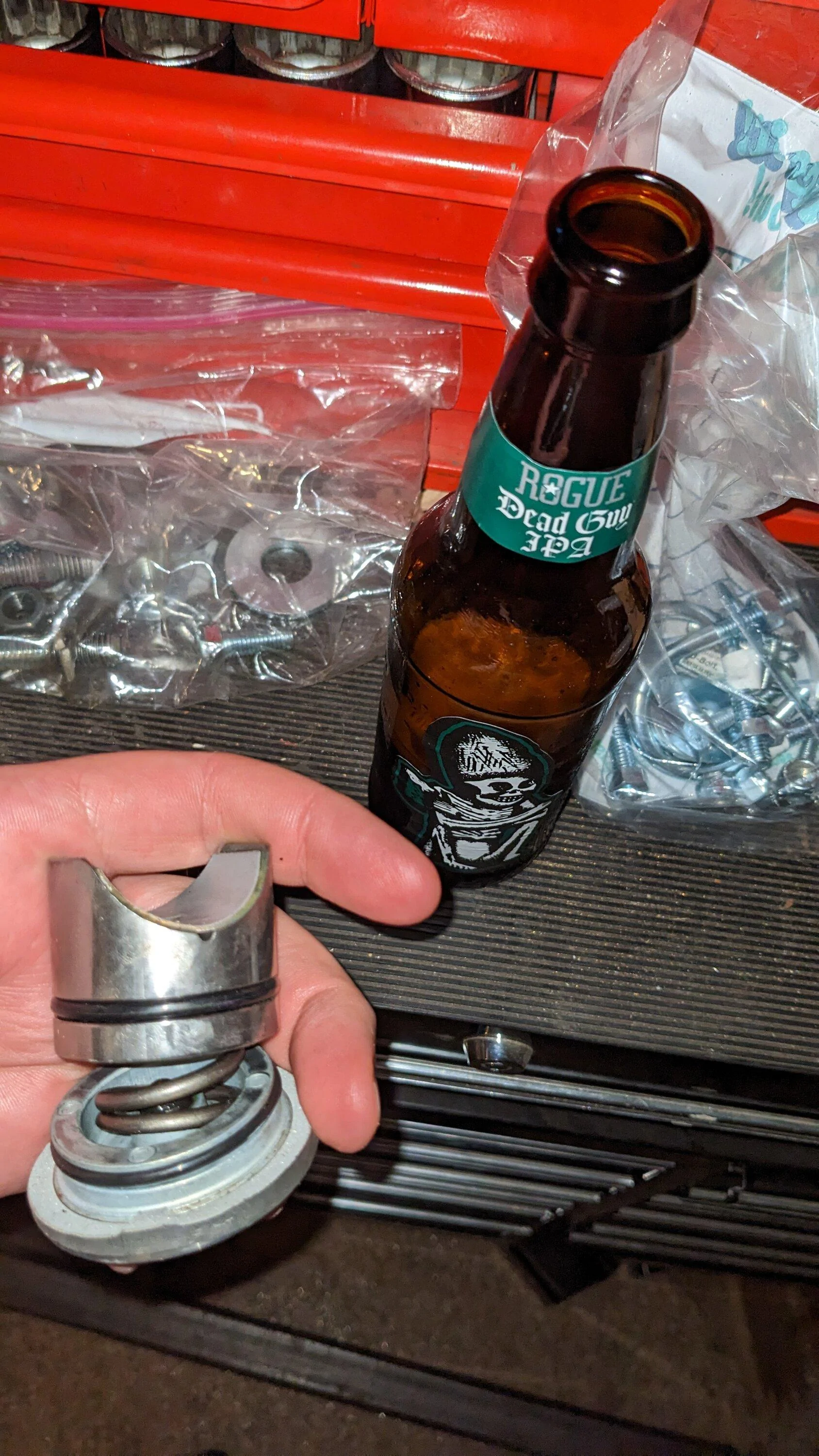

It's more of how you take the load off the pinion tensioner and transfer the load to the housing than what the housing is made of.
Nothing new in that video for us cool kids... I got one of those too...
Ford Bronco 74weld steering rack coming! PXL_20230129_010205526
