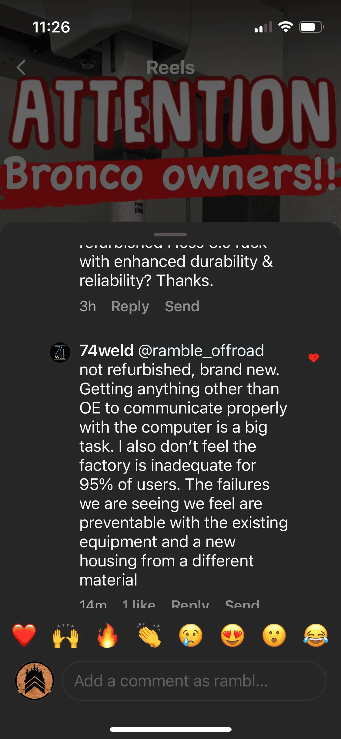

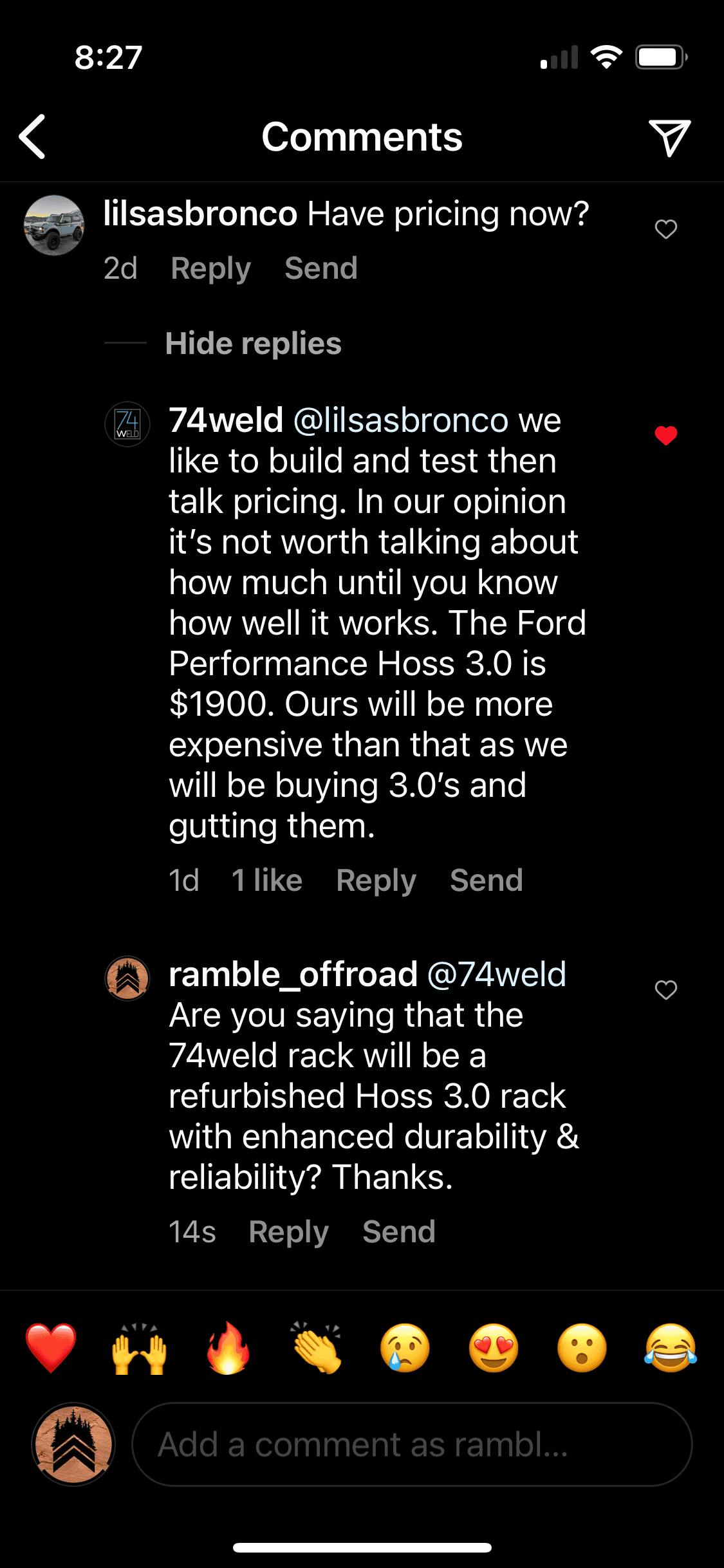

Sounds like 74Weld may have a prototype on display at KOH, so if anyone is planning to attend go check it out, chat them up and report back.
Another comment / screenshot from IG.
Edit: I posted a question.
edit #2: further clarification from 74Weld posted below. All new components.

Nice, so that answers the big question. Use the 3.0 for the mechatronics and then put all the fancy shmancy parts in some beefed up chassis. Curious if they will reuse the rack/ball nut assembly and just beef up the housing.
Potentially yes. However some simplified programming / plug in “how to” would still be advantageous. As it stands the programming voodoo to force non-Wildtrak trims to accept the H3 rack is beyond me.
tie rods is a question also. If true, and 74Weld plans to refurbish the H3 rack what’s their plan for tie rods? 74Weld had previously commented on IG that their design plan included tie rods, but as we all know this is all subject to change. (Edit, see below feedback from 74Weld on IG)
To be honest, the fact that 74Weld is communicating with us now is above and beyond standard SOP. I work in product development and our status quo is no public chatter before go to market launch. So thanks to 74weld for being cooler than I am. 😎

Sooo...the 3.0 rack isn't $1900 unless you want to buy two of them. That leads me to think they're priming the market for an even higher price than that, I'm betting their rock bottom target price is going to be at least $3500, with $4500-5000 being my guess as to what they'll actually charge. That's fair, but for that I'd expect something above and beyond the 3.0 in performance, something professional racers would actually rely on in their vehicles, as opposed to CNC parts and an explanation on how small business economics works for a niche customer base. $3500-5000 is hydraulic power rack territory...

If they're cannibalizing 3.0 racks to make theirs, sure. You'd be out a rack and a bronco for who knows how long in the meantime though. Maybe they'll offer a core exchange instead.

Clarification: new components

If we have a WT with HOSS 3.0, think they could just take our exisitng HOSS and gut it vs getting one from Ford and gutting to save costs?
Good question. If I was running the show I’d say no, because I’d want to start with new components, eliminating unknown wear & tear variables. Total speculation of course.
