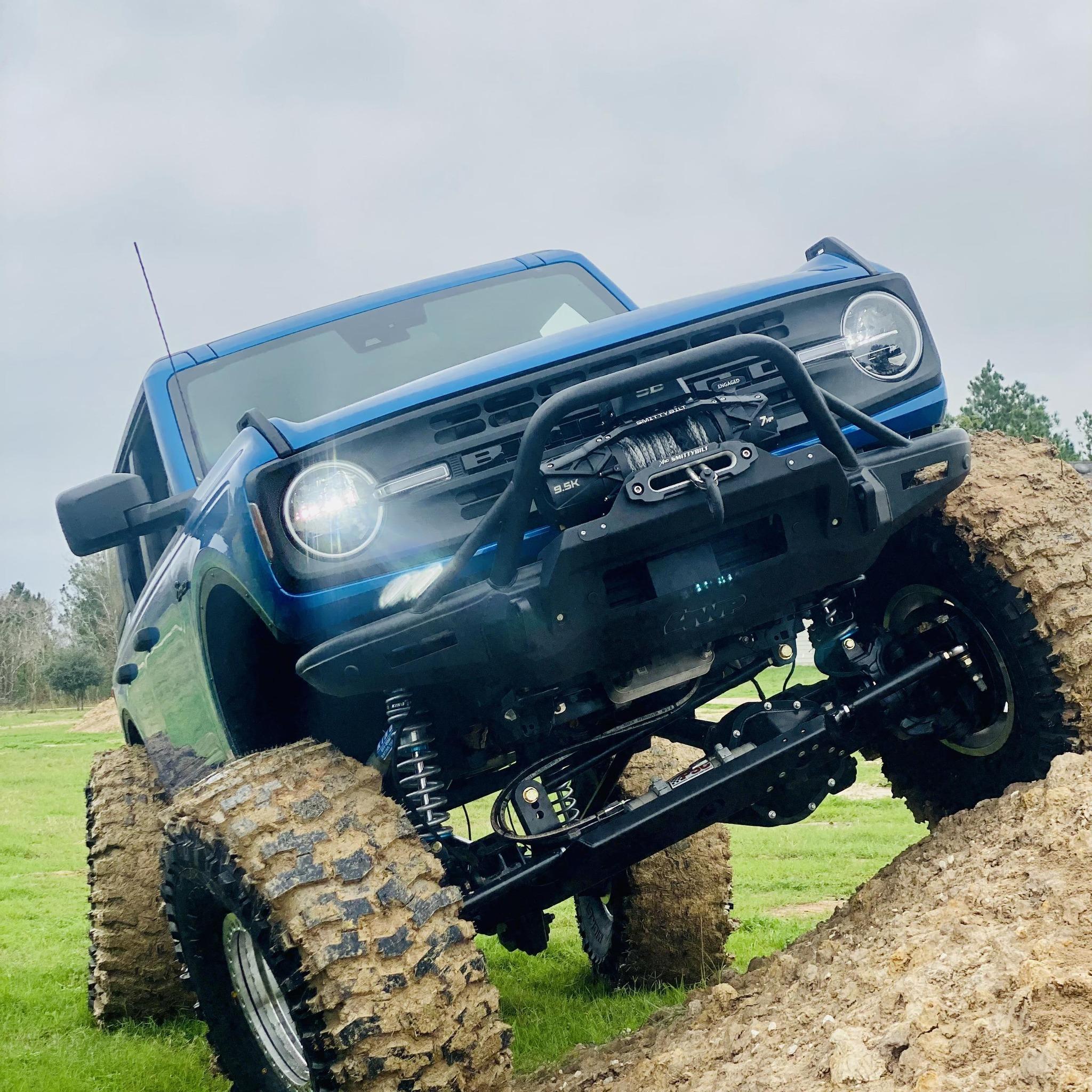

Lonestar Ring and Pinion looks like made up a kit to convert over to SFA for the Broncos. Not sure on pricing and availability but gives an option to those wanting to do some hardcore offroading.
source: https://www.facebook.com/Lonestaraxle
Ford Bronco Solid Front Axle for Ford Bronco by Lonestar Ring & Pinion nc_ohc=LHcP1ZjNwZcAX_e_Szv&_nc_ht=scontent.frnd1-1

Two things:
That panhard bar on the front looks super short so there will be a lot of lateral axle movement through the travel. It's probably a good thing they did hydro steer or else bump steer would have been unavoidable.
The rest of the suspension links sure hang down low everywhere.

I would be impressed if they posted a video showing it driving down the road with no lights on the dash. Must be Christmas light show every time they start it.

Would be nice to see someone come up with SAS with a real steering box that isn’t lifted excessively high.
