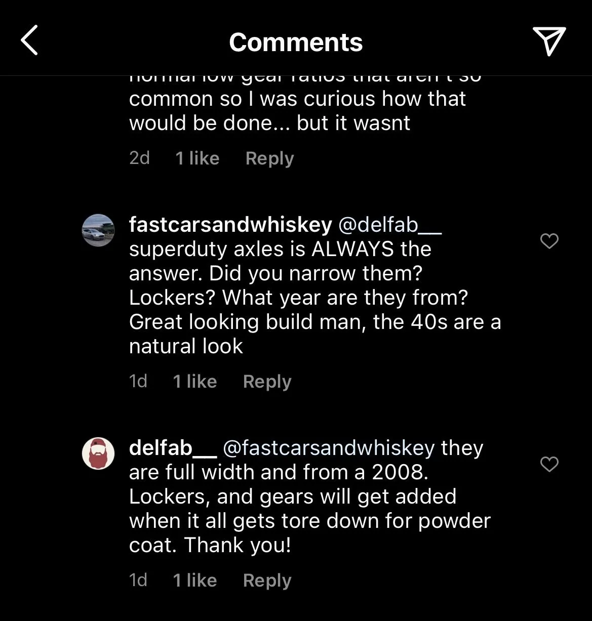

Ok I don’t know much about solid front axles but don’t they need gears to work?
so it’s a front axle from a 2008 super duty? .
Ford Bronco First 2021 Bronco solid front axle (SFA) swap + 40's! 8F3B8AE4-5D49-4F5B-8B30-FA8EFE4AC3E6

Yes they do need gears, he said they will be installed after the fab is done, and the axle is removed again to be powder coated.
