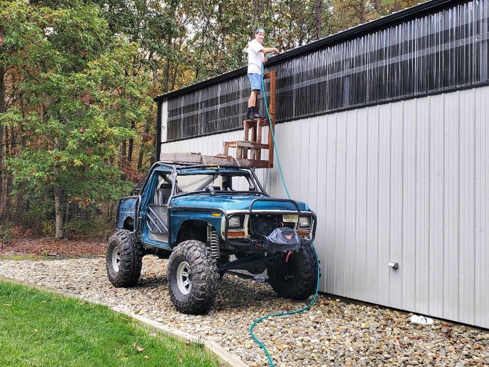

Exactly. Did I really need a wood platform to clean out my pole barn gutters?
Maybe not, but it took a couple hours, wood was left over from pole barn build, I have
a bobcat with forks to put it up and take it down. Those of us that can slap this kind of
stuff together, literally in hours, are usually bored with what many think is "crazy".
