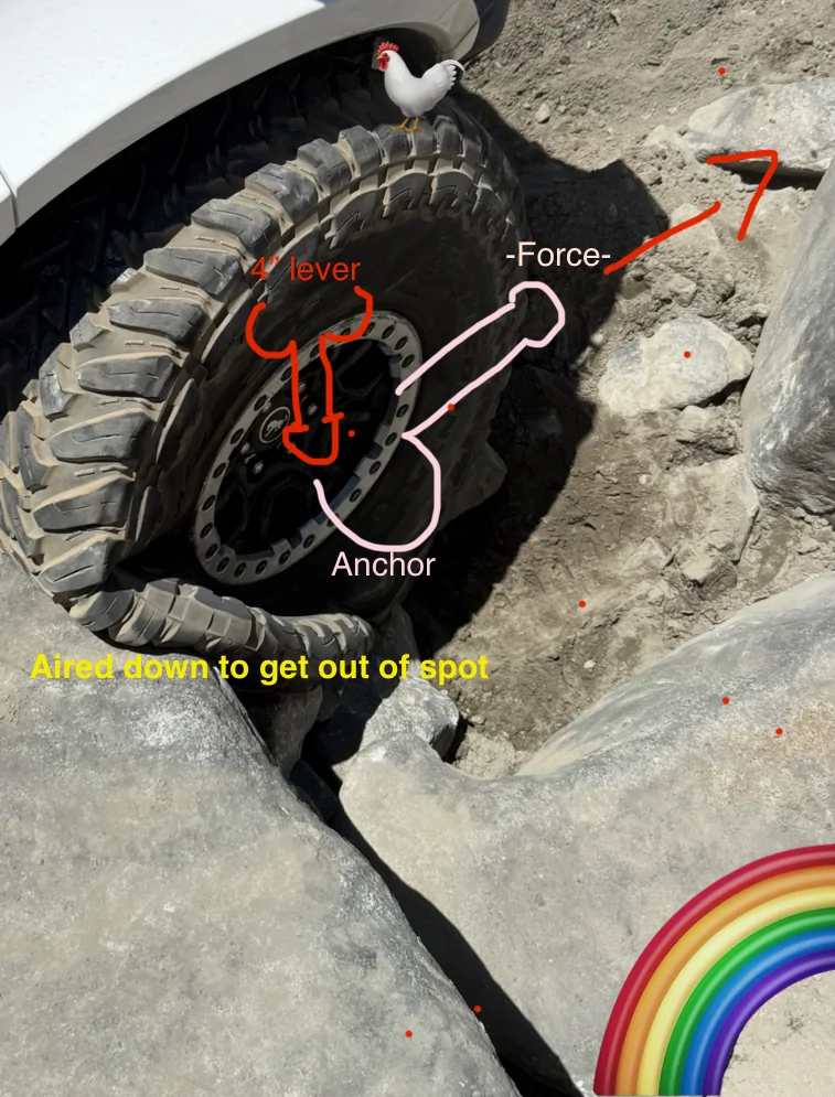

Ya, who knows what kind of logic Ford has programmed for the rear wheel sensors. I imagine the same thing would happen if you broke a factory rear shaft.
I can report, the front does fair better. When I broke a CV, I was able to put the broken stub back in the wheel bearing, pull the center shaft and CVs (including tone ring, broke right where the stub shaft begins to widen on the wheel side), put the good stub in the diff side, and it worked fine in 2wd. Wouldn't let me go into 4wd at all, cruise didn't work, ABS and traction control lights all the way home, but I got home driving 2.5 hours on the highway.
I wasn’t clear-there were no issues with the tone ring or ABS system with the stub in there to plug the portal and keep the tone ring functional. This was due to how the vehicle behaved with the portals on the rear but without power being sent to one side. It acts like an anchor when trying to climb anything and going slightly uphill. Think trail turn assist on 11 but you’re wanting to go the opposite direction or straight, but it’s not letting you. That shit was not cool. Not to brag, but I made an excellent diagram to depict how the suspension is affected.

LMFAO, got you. And yes, that is an amazing diagram.
It was nice to at least have 3wd, even having to tow an anchor. When I broke and lost the tone ring, no 4x4 at all, no lockers. I was about 50 yards from the main trial but the trail I was on, called "Rocker Knocker", has a car-sized boulder as a gatekeeper. Had to literally get belly drug over the top because if you don't run the absolute perfect line on the one side (where the Jeep is in this pic) you will fall down on your side and wipe out your doors. So that was fun.
Really annoying that these modern vehicles don’t have an option to override the computers. Just do like Tesla and say “are you surrrreeeee you want to do this?”
