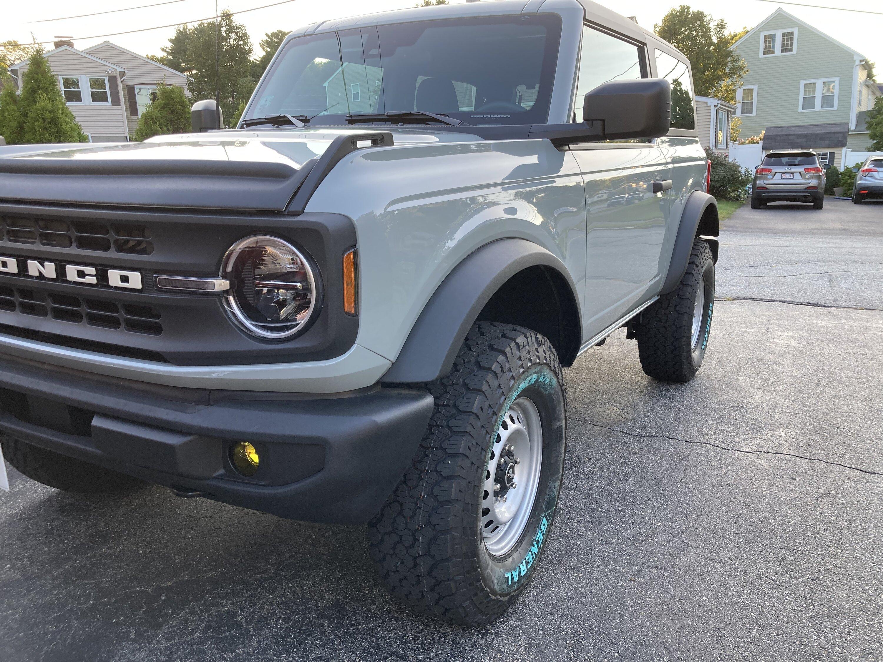

Not a fan of that style. Looks like Rough Country.
I went with Ready Lift.
Solid Billet Aluminum for a decent price.

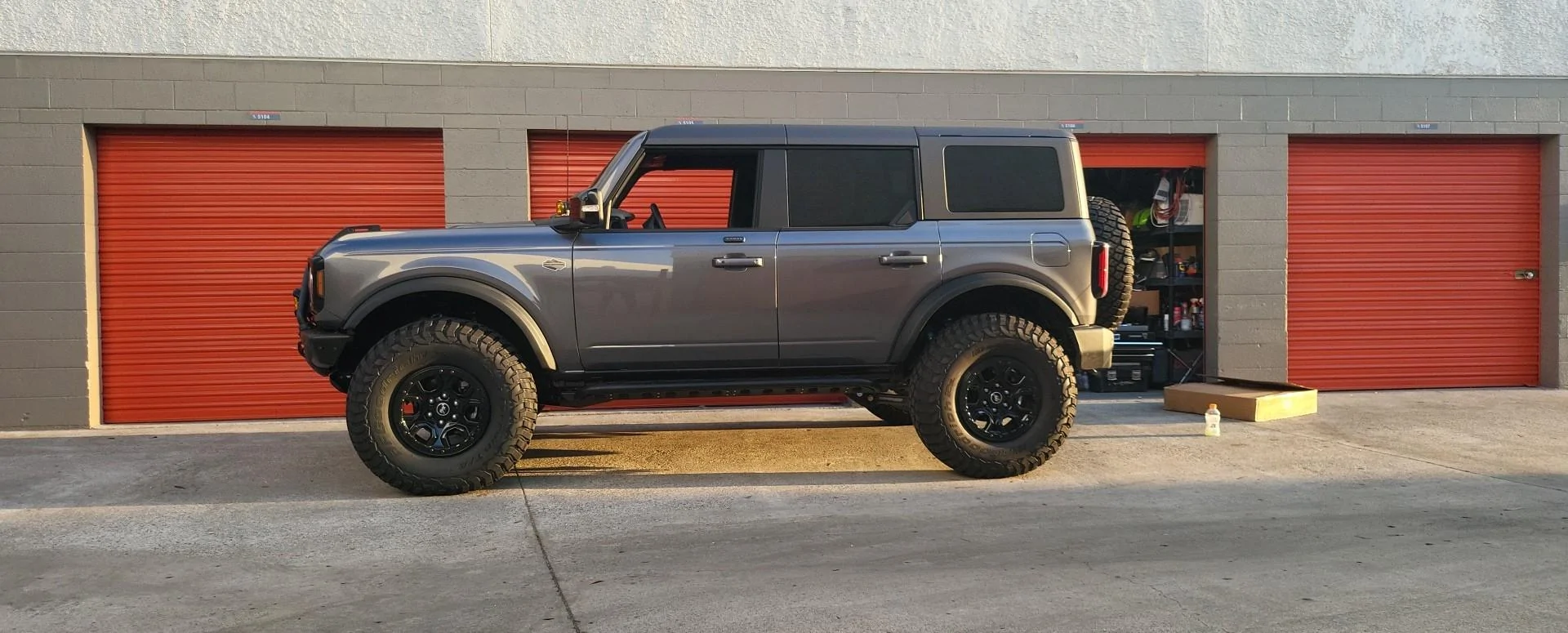

Don't waste your $$ or your CV's.

if youre going 2 inch do ready lift solid billet as stated above. Your talking 200 bucks more for a solid product imo. Ive done so many things twice. Ive learned now to do it once,correctly. Although some will argue a spacer lift is incorrect. I can see both sides of that argument
