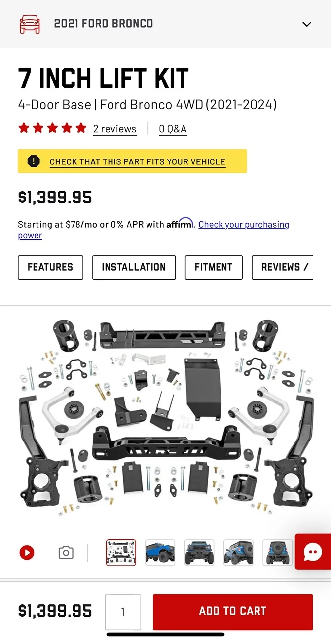

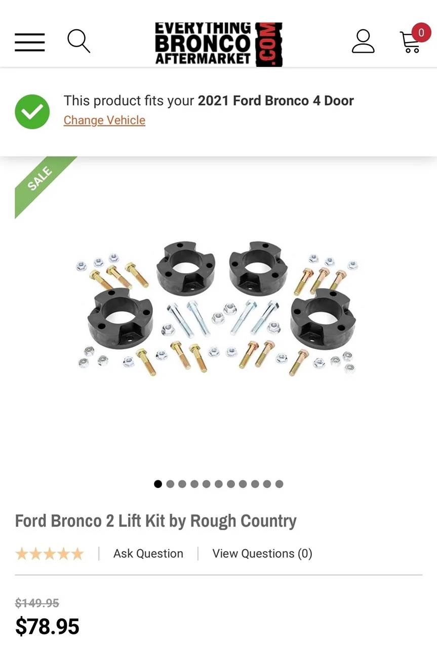

I was thinking about something like this
Ford Bronco 5" inch lift? IMG_8548
Ford Bronco 5" inch lift? IMG_8547

Brian has asked the best first question. Keep in mind that's a craddle drop kit. So some existing skids (depending on what you may have) will not fit. Once installed, you will see the craddle from the front, as it will be lower than existing.
Are you looking to fit bigger tires? Are you looking for more overall clearance?

Cheap "lift kits" are,...well, CHEAP (made cheaply). They are made for "looks" and look horrible.

You can run 37s with a 1.5-2" lift on your Sasquatch (they won't even rub if you get some wheel spacers and do some work on your inner fenders). Running anything bigger than 37s on stock axles is HIGHLY recommended against. You will break, YOU WILL BREAK.
At 5-7" of lift, your center of gravity is compromised and I, honestly, wouldn't drive at highway speeds. One big swerve to miss something and you're doing cartwheels at 70MPH.

The best route is limited suspension lift 1-2" max to retain ride quality, IFS suspension travel (extension mostly) and not wear our CVs.
Heads up! The forum hates drop bracket lifts. But it truly is the best way to achieve "good" geometry with factory CV and tie rod angles with greater than 3" lift. I'd do this before Portal axles.
Look at higher quality options as Rough Country is mostly junk.
https://fabtechmotorsports.com/prod...overs-rear-dirt-logic-resi-coilovers-k2395dl/
https://www.belltech.com/products/4...nd-rear-trail-performance-coilovers-152602hk/
Belltech probably has the best componentry. I especially like the frame mount track bar drop (by far the best solution - compared to raising the axle end). They have a ton of bling. But parts look solid.
Buying a "complete" kit with tuned shocks is the best idea as they will have dialed in the wheel travel to function properly.
