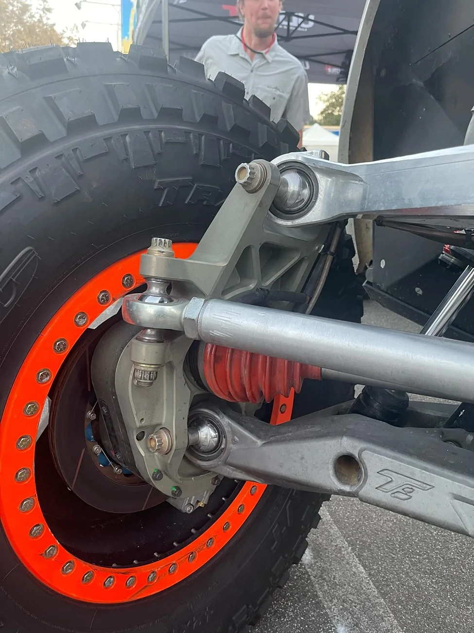

There's a massive difference in winning a race (less than 1,000 miles) and having longevity and durability for lasting 200,000. Most aftermarket parts tout "strength" at the expense of longevity and on road ride quality. Also it should be noted the "Portals" being sold to the pubic are nothing like the "race portals". Compare for yourself.
Hmmmmm…now that you mention it…these do look a little different than the consumer version
