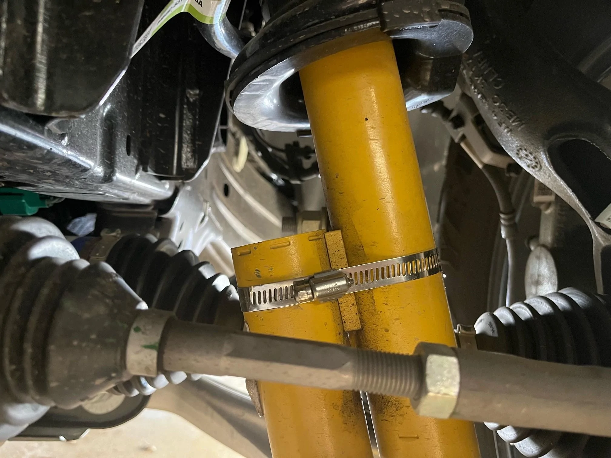

A few hose clamps on each reservoir should be cheap insurance holding them on!
I just realized that's what happened, the remote reservoir literally is missing :curse:
I know some people think this is funny or are unwilling to take this simple step. I think it is a good solution that doesn't require any further maintenance and will likely allow the shock to reach it's "normal" life expectancy. And then I can replace it with whatever tickles my fancy at the time...
Wouldn't some decent zip ties also work? I'll be under this weekend and will take a look at mine.

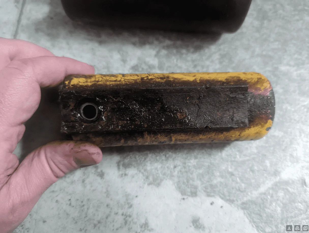

That won't stop any leaks. I never lost the reservoir. But the connection between that and the shock is where the rust occurred. Enough so that all the fluid leaked out. In my opinion, these shocks are complete garbage.
Possibly, I felt like the stainless steel hose clamp was the best option to handle the conditions there. Plus they will have more “force” than you can apply with tie wraps.
You can’t say that with certainty. I’ve seen 2 of the reservoirs leaking that didn’t come completely off but both were not fully seated as they came from the factory. It’s just as likely that that is how the rust got in to yours…. You don’t have to do it.
And yes, I think the factory Bilsteins are just OEM garbage. But for $8 I believe I will not have the problem that many others have had. Hopefully that will get me to the point I decide what I want to do for shocks…. Not a huge fan of what’s out there so far.

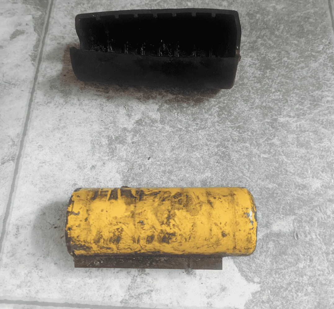

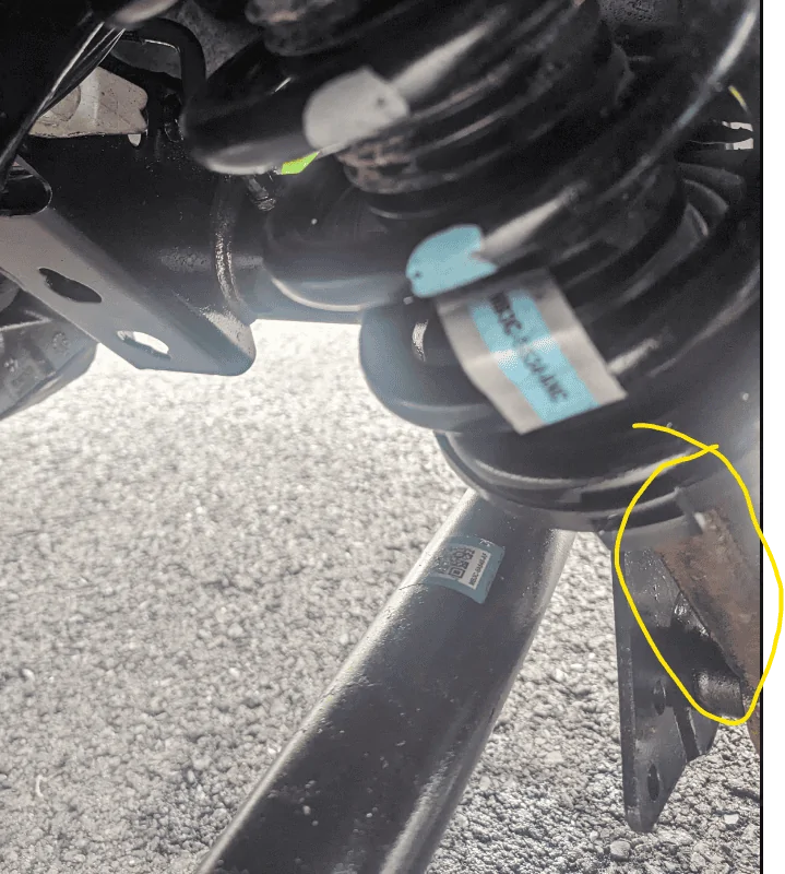

Guess what I found when I was riding my motorcycle home from work:
Crusty Rusty. At least you found the piece of the puzzle. Not sure that will help your case. If I was bringing the Bronco in, I'd also be bringing a box of donuts for the service advisor in the hopes you catch them on a good day.
It's clearly not due to abuse, I can't imagine what grounds they would try to deny it. The only damage to the reservoir is from it falling off my Bronco.
