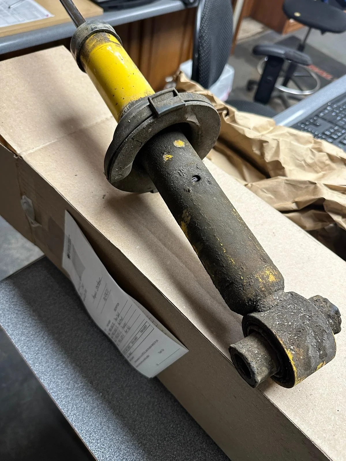

It's clearly not due to abuse, I can't imagine what grounds they would try to deny it. The only damage to the reservoir is from it falling off my Bronco.
Am I the only one seeing the rust? Am I crazy?

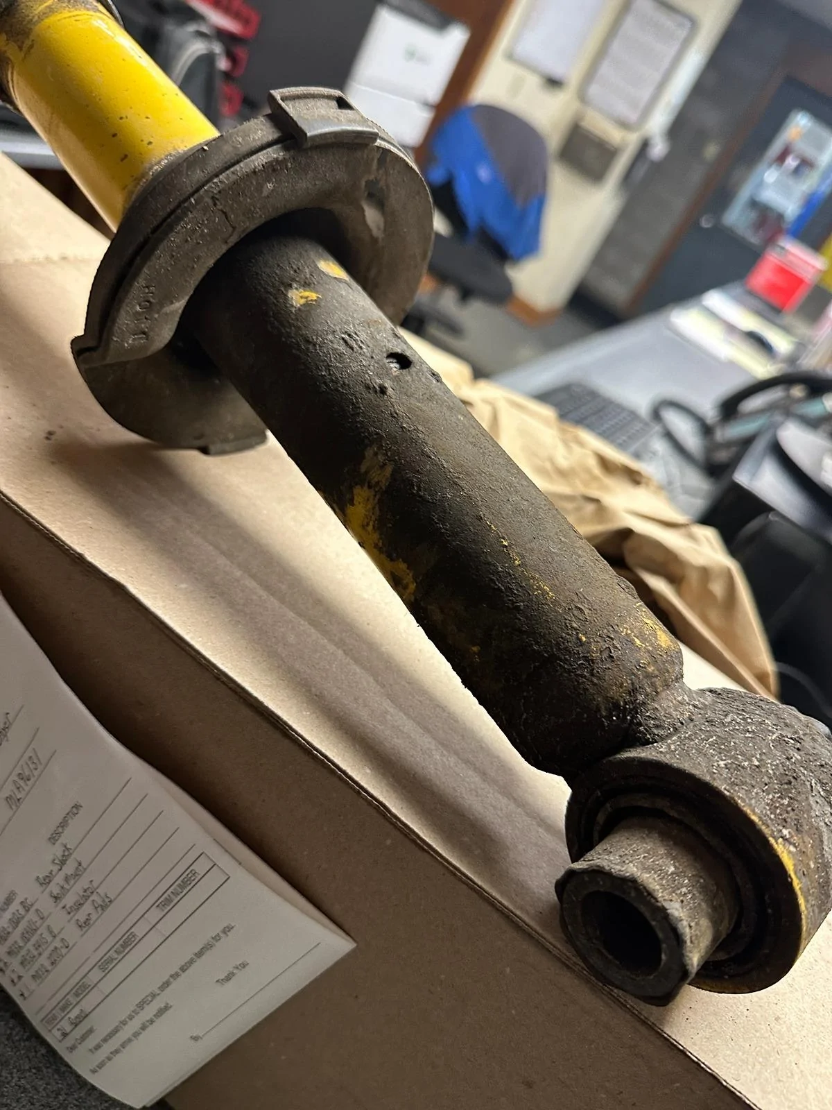

See all the parts of the reservoir that AREN'T rust? They're the parts that face the outside of the assembly.
See where the rust is, that's the part that is supposed to be sealed to the shock body, it's not supposed to be exposed to the elements.
I guess I'm the crazy one. Ignore the second picture where the rust is on the internal mating surface. The first picture clearly shows rust.
You seem to think that isn't rust. Good luck convincing the service advisor.
Bring coffee along with the donuts.

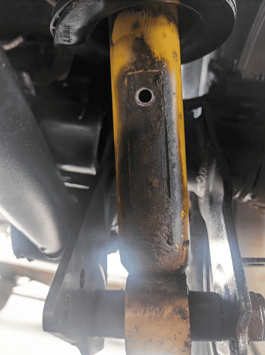

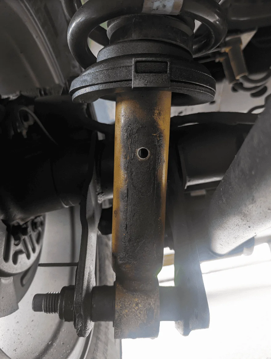

So it stopped raining, I went out to check the passenger's side.. They're both missing! (I thought the issue started before where I found the reservoir yesterday, so one went and then the other)
Passenger side:
Ford Bronco '21 Badlands rear shock failure 1715362154089-la
Driver's side:
Ford Bronco '21 Badlands rear shock failure 1715362183293-k2
Passenger side:
Driver's side:
Yup, junk. Good luck getting them covered.
