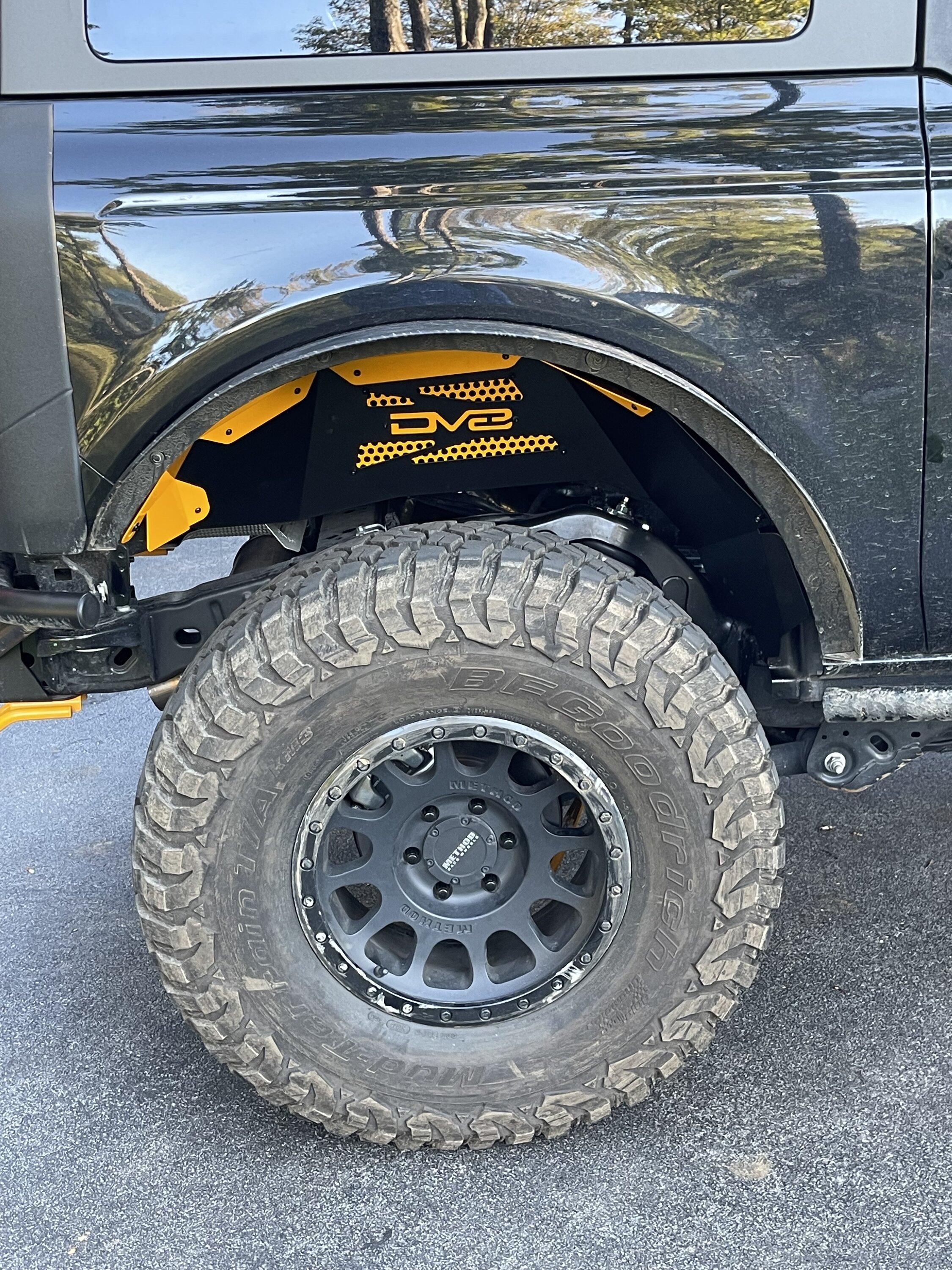

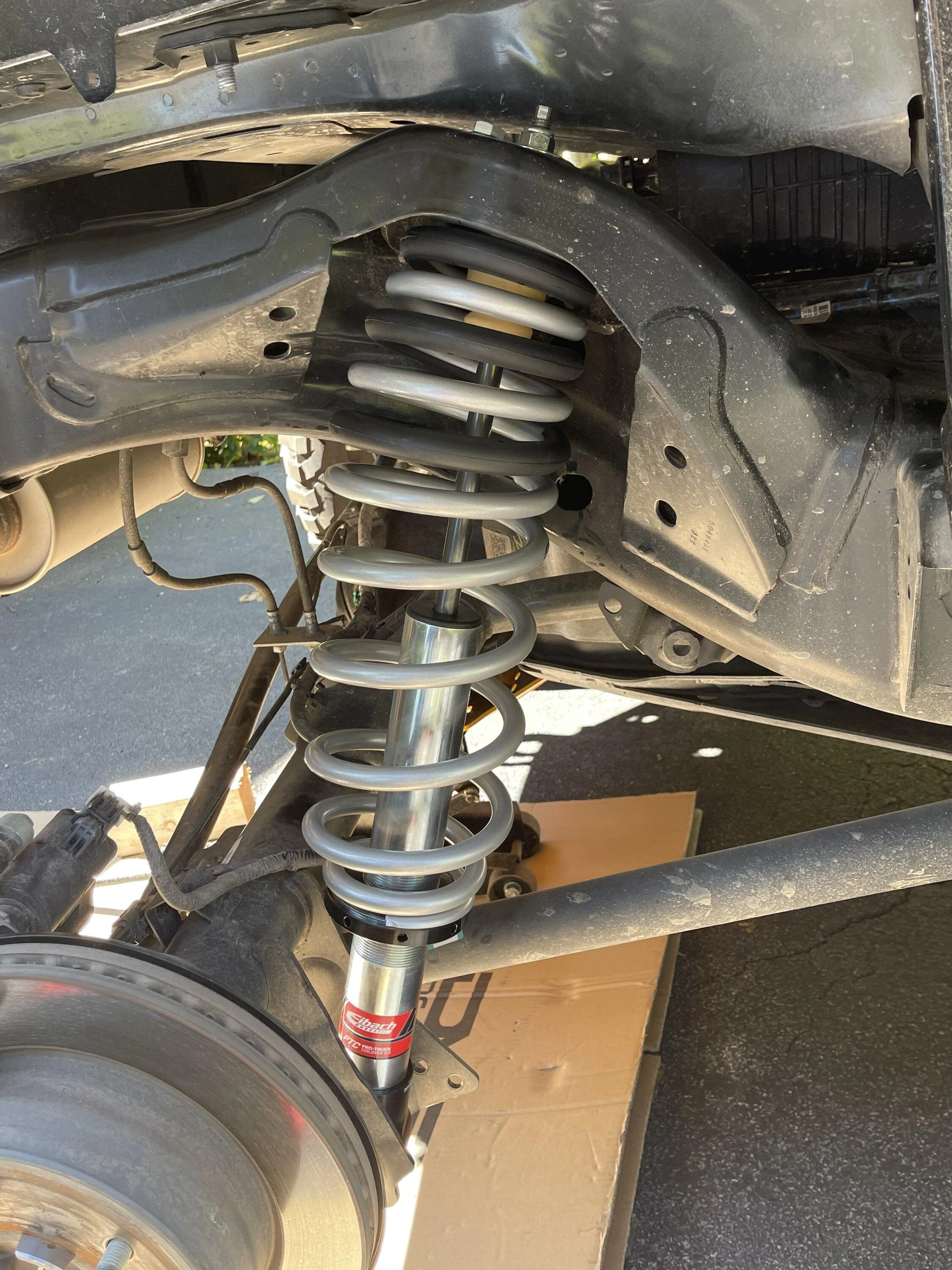

Had a similar issue.. Went with Eibach 2.0 coil overs all around and couldn’t be happier…

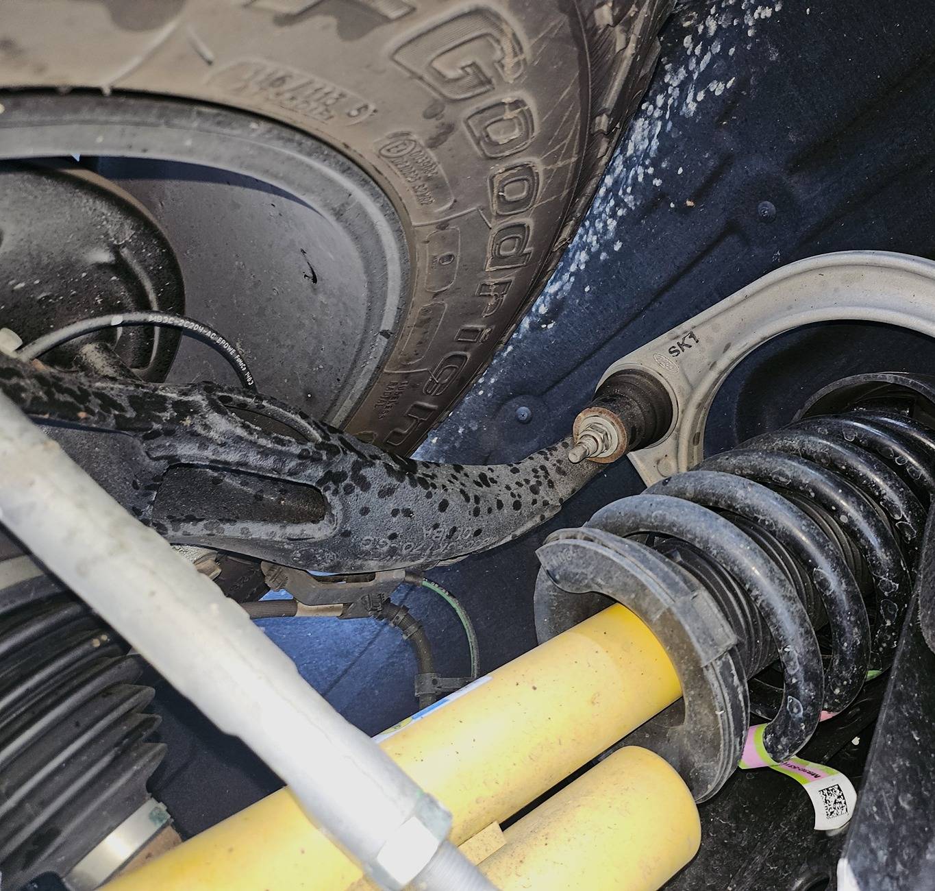

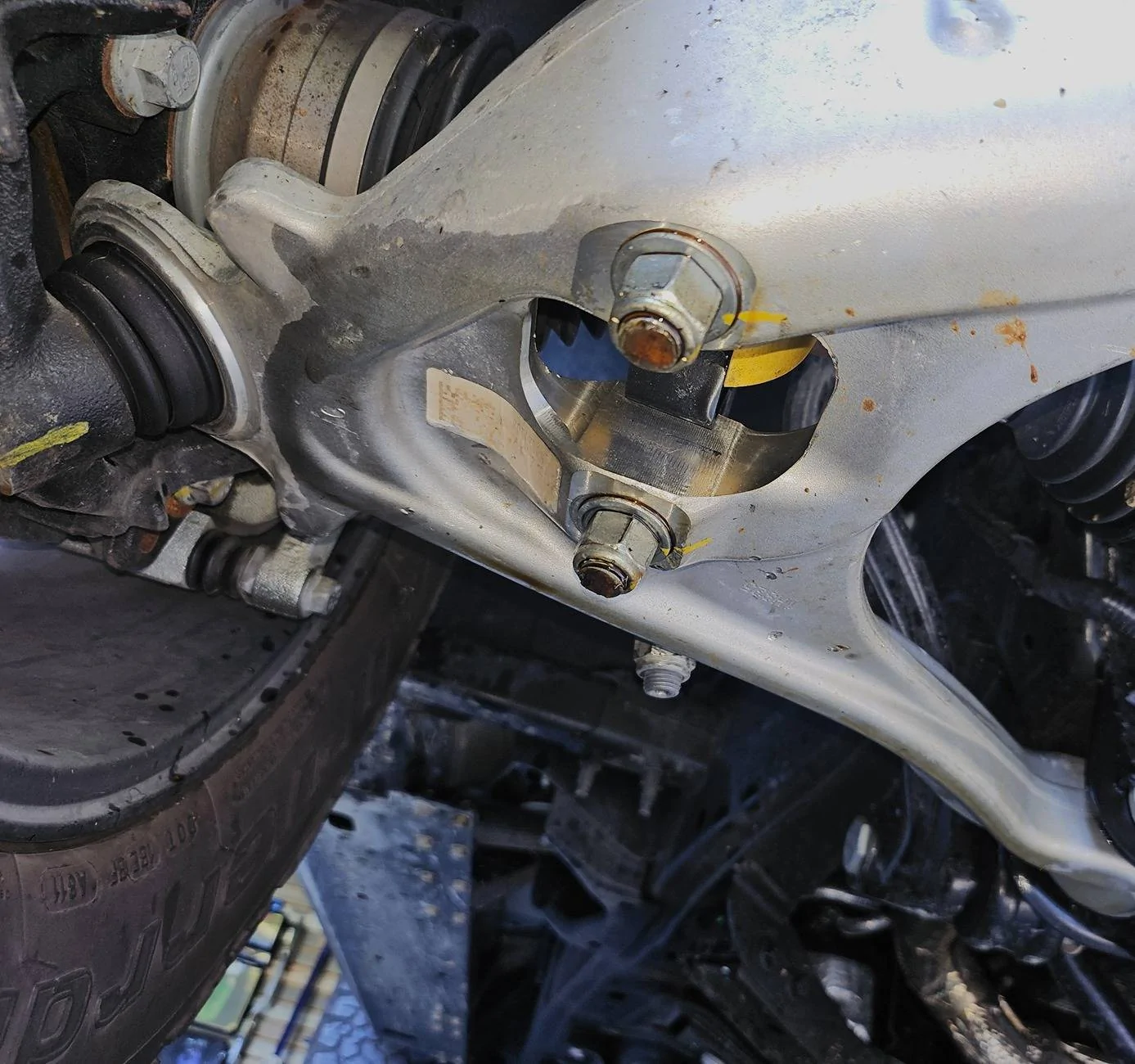

I have noticed a clunk sound from the front for about 2 months now. I did look at the suspension behind the wheel/tire when I first noticed it but did not see anything out of order and I did not crawl underneath to check further. I have been battling a case of shingles for the past few weeks so that has kept me from investigating further. Today I carried it 60 miles to my dealer from who I purchased it from to get the oil change and they do an inspection along with it. Everything was checked OK including the section marked suspension/struts etc. After getting back home I crawled under it and noticed the oil and splatter from the front right Bilstein right away. I did not think to mention it to the service writer since this dealer has a separate business next door that strictly does oil changes and alignments. They do not do any type of warranty work as that has to be scheduled thru the actual service center at the dealership. It amazes me that they so called checked the boxes during the inspection that the struts/suspension was ok though. I guess another appt and trip is in order :(
QUESTION : I installed a front leveling spacer on the bottom of the shock and a set of aftermarket wheels about a month after picking the Bronco up in May '23. I'm still using the factory 33's . Has anyone here done similar and had the shock fail, and did they give any grief about the spacer/wheels as far as covering the shock under warranty?
I did a lift and the shock reservoir broke 6 months later. Dealer replaced the shock. no issues.
