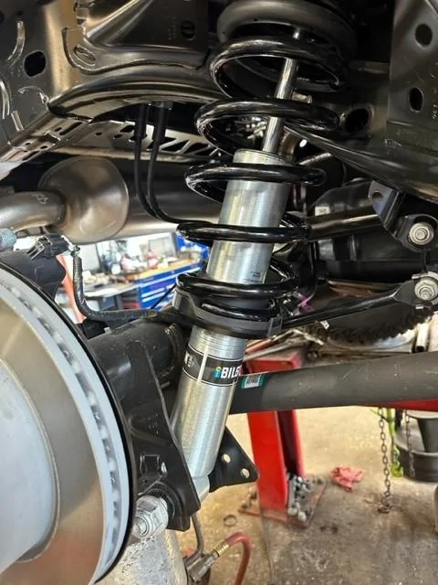

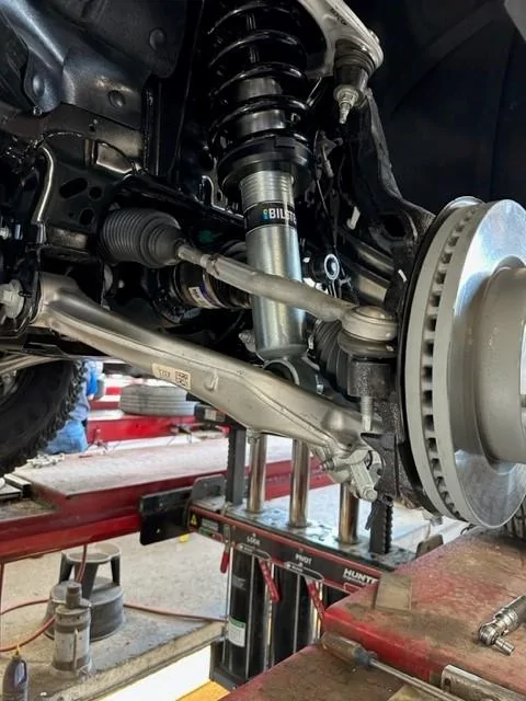

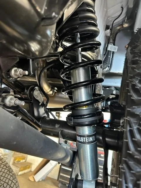

I did not measure my before or after but it feels like at least 2" (that's what she said). Regardless of what others have done, I suggest taking the axle nuts off and pushing the stub out so it doesn't hang or have the chance to pull apart internally. No reason to tempt fate.
Front & rear upper insulators (4) MB3Z-5415-B
Front & rear retainer nuts (4) W720199-S440
Rear upper cap nuts (6) W520213-S440
Front upper cap nuts (6) W715135-S450
Reuse rear lower shock mount bolts but apply thread locker during reassembly. Do not need dust cover/bump stop as they aren't reused on the Billy's. I suggest using new nuts I listed above and when you take off tie rod nut, upper control arm nut, sway bar nut, caliper mount bolts, axle nuts, you put some loc-tite on all the them on reassembly if you don't use new.

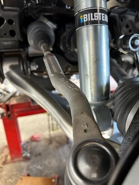

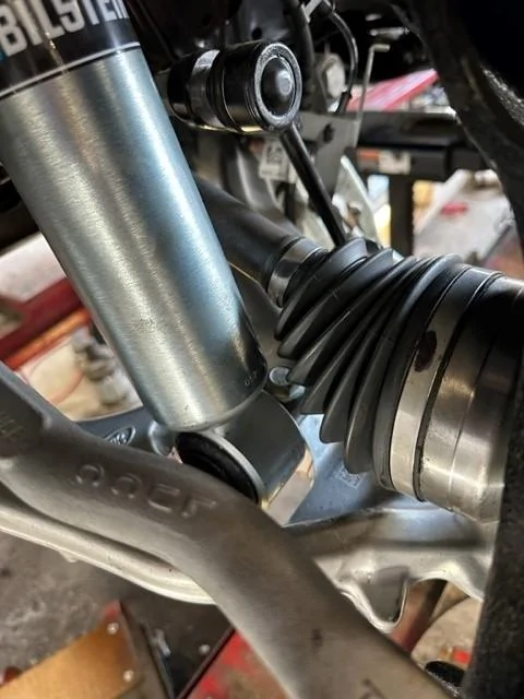

Great, thank you Sir! The Bilsteins look great, there is not a spec of dirt anywhere on that Bronco. CV angles look really good as well, nice setup. Thank you for the information.

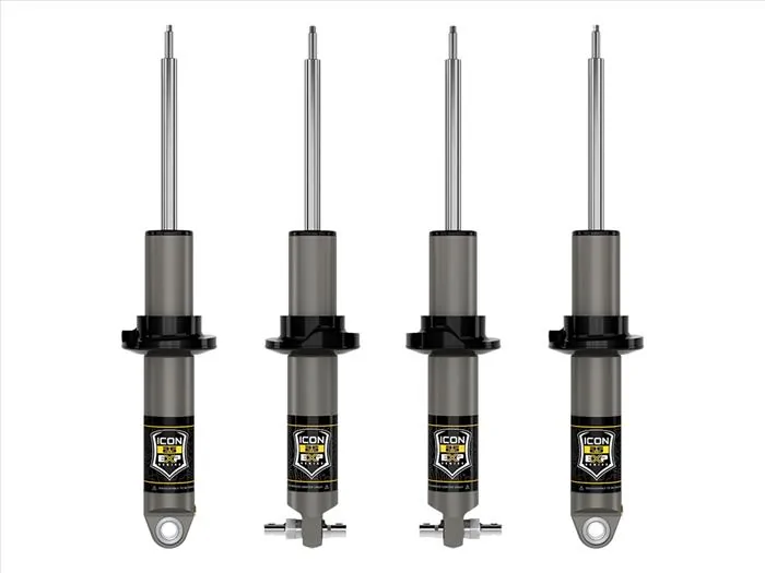

The Icon's I mentioned above are terrible. They have been removed, back to stock. I have Bilstein's like you have on order. I am going to copy what you did. Thanks for posting your pictures.
