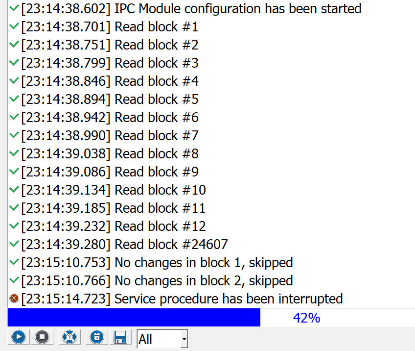

As I feared, I still am unable to program the IPC. It gets past block 12, then goes crazy, every time.

What year is your vehicle? I know 2022 was having issues and needed to be on the beta version of ForScan (link has been thrown around here before). Otherwise you may need to re-load the profile when you first connect to the vehicle (select new vehicle instead of your saved one). Usually that helps this issue if it isn’t related to 2022.

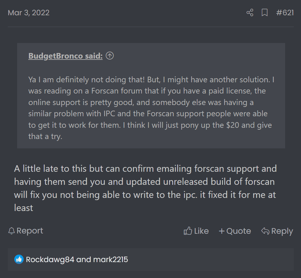

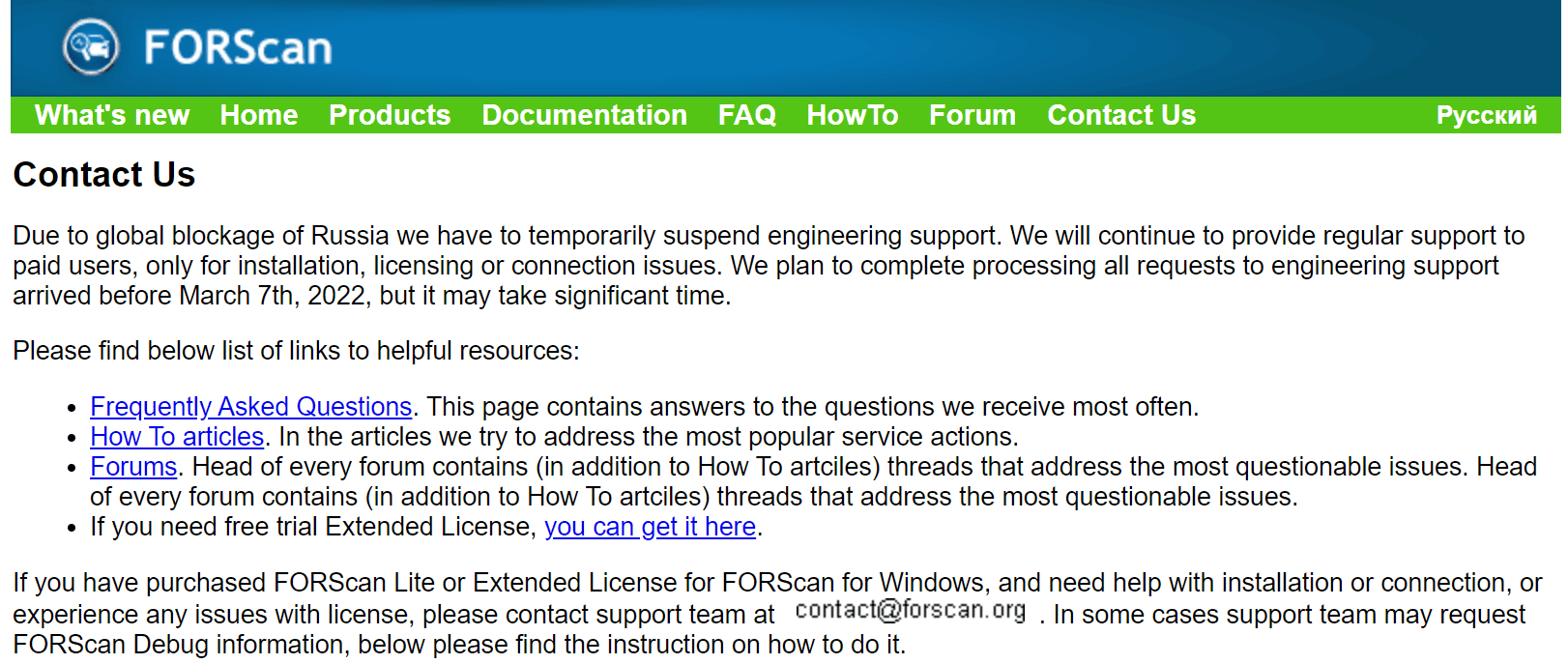

Well, I chose the wrong time to get into this. It seems that emailing Forscan for an unreleased copy of the software allows IPC writing, but it appears I can't email them without a paid copy and I can't pay for a copy due to the current global issues. I may be waiting a little while.
I said this in my first reply above but there is a link floating around here for this. Let me see if I can find it faster than you and will update this post lol
And we luck out on knowing values because of Livinitup’s hard work. He master decoded most modules for the F-150. I use his 2021 F-150 spreadsheet to correlate my changes. Some aren’t always the same though but it’s the closest thing we have. Helps cut down on trial and error time a lot.
I have a '21 with the 2.3L and M/T.
I will try from a fresh session tomorrow and go straight to the IPC with fingers crossed.

Well, armed with that, I need to go give this one more try for the night. At least that will let me sleep. lol . Thank you for all of your help!
Good luck. Be comforted knowing that there isn't much that will be affected by not making the IPC changes. It's all just for indicators on the dash that you're towing a trailer. Nothing urgently important since it's kind of hard to miss that you're towing a trailer. I don't have the TBC so I don't know what displays when you're towing, the setting appears to be on by default if you have the TBC, probably to make adding it seamless. I assume it just shows the current gain setting.
That did the trick! Went through with no issues.
