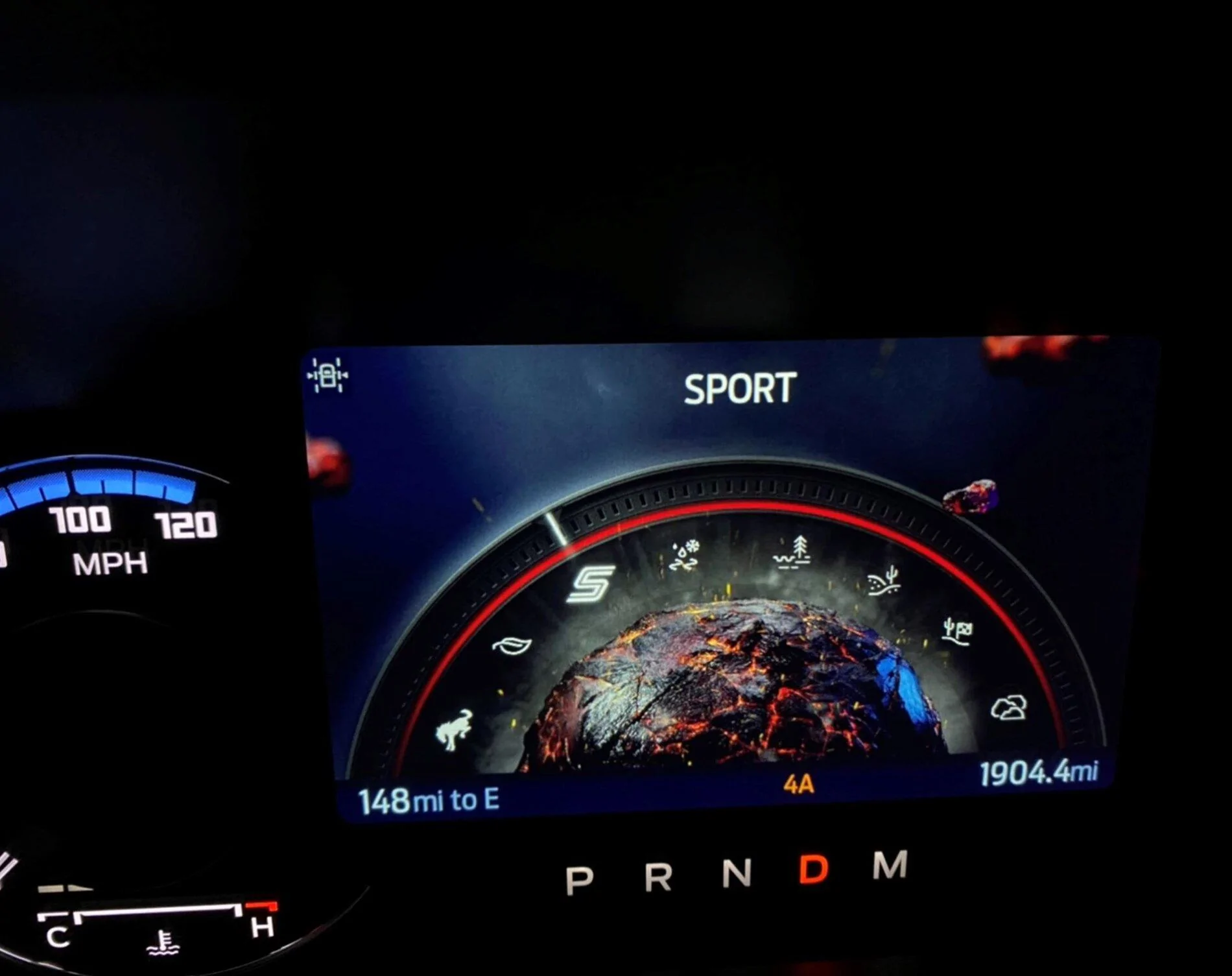

I enabled sport mode on my 2.3 manual badlands today. Its a small but noticeable change, the response an torque available when first opening the throttle has improved. Even with the SAS wheels and tires I have on, it feels pretty spunky, and has made me decide to hold off any throttle booster purchases for now. I will test the other modes during the week, but all 8 of them show up on the screen now, not sure why they did not do this from the factory.

Barely tested it but I have enabled Sport Mode on a Badlands. What's curious is that it shifts to 4A when you enable this. . Also I have only just enabled it, drove 20 feet and then went back inside. It appears to work but I will confirm soon. I do now have all 8 modes in the SDM. I can't confirm the options listed below are guarantees I just compared a VIN for each trim and correlated the factory G.O.A.T. mode choices to the As-Builts. Seeing how Sport Mode was easily enabled I am fairly confident this is the DIY for all 8 modes on any trim.
I have updated the table with potential ability to turn off modes if you so desire. I have not tested them yet. Flashing the ABS module will throw many codes in it and you will need to clear DTC's. For many who might be new to ForScan and even those who are not, it's my recommendation to clear codes before you write a change (if present) and definitely after each write of a change you make. You don't want to lose communication with a module and not know it until you've finished doing other things.
