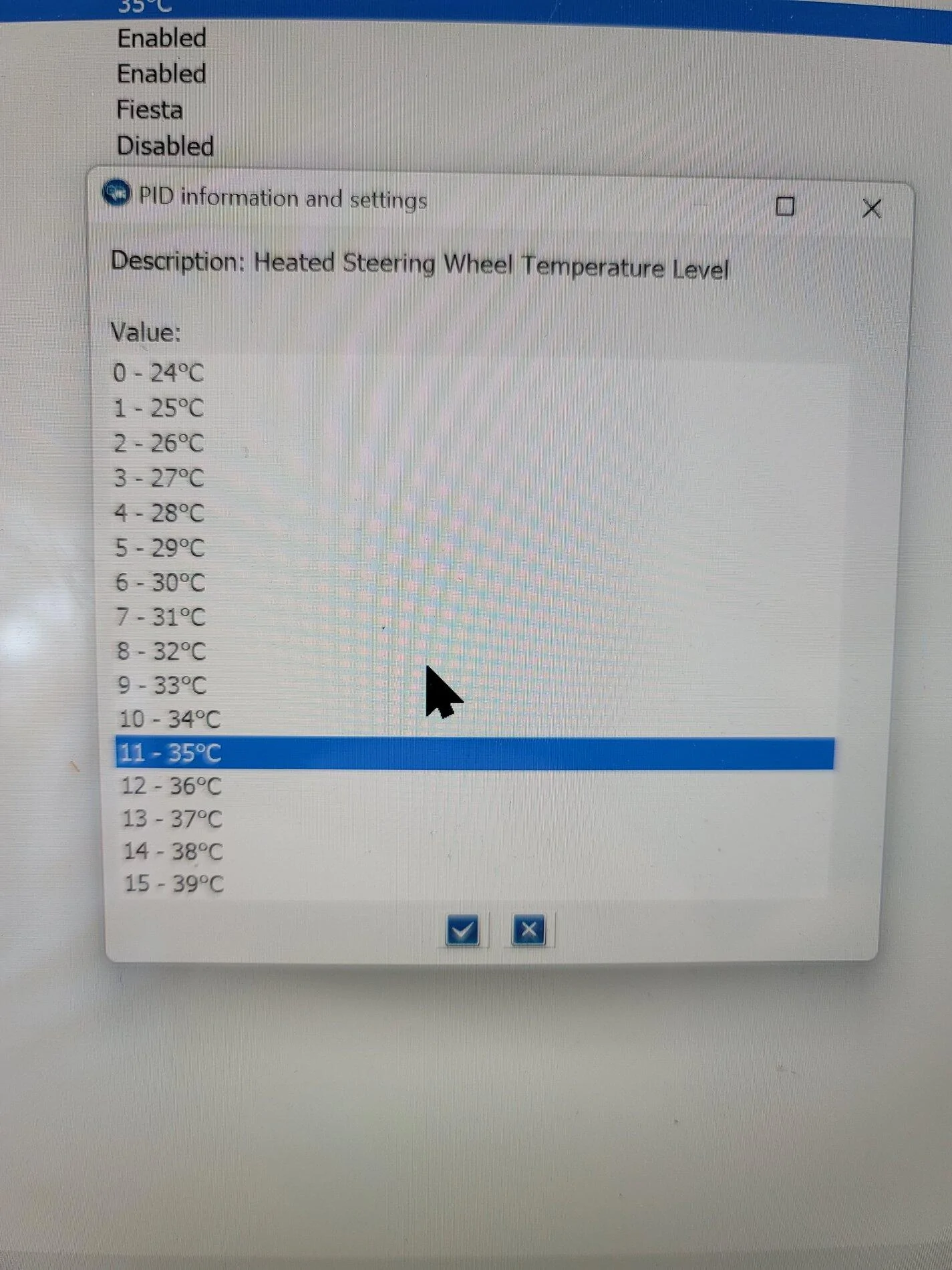

Has anyone explored attempting to change the temperature of the heated steering wheel? I read this was doable on the F150.
Noticing my heated steering wheel is lukewarm at best now that it’s getting colder out.

I posted in another Thread about that that it is listed with a pull-down menu for a choice of temperatures I am fine with the temperature of my wheel so I did not change it

35 C = 95 F, You madman!!!!
This is great, I actually think mine gets to hot and turn it off after only a minute. When I get Forscan setup I will adjust this down for sure.

thanks. Initially I plugged in to check for DTCs since I didn’t clear them when adding goat modes. Nothing related to the sport mode change. There was one error about no signal from right spotlight indicator or something but I tried it and it turned right on. Maybe something left over from when I took my doors off. Ended up turning up my heated steering wheel a few degrees while I was connected. So far so good.
