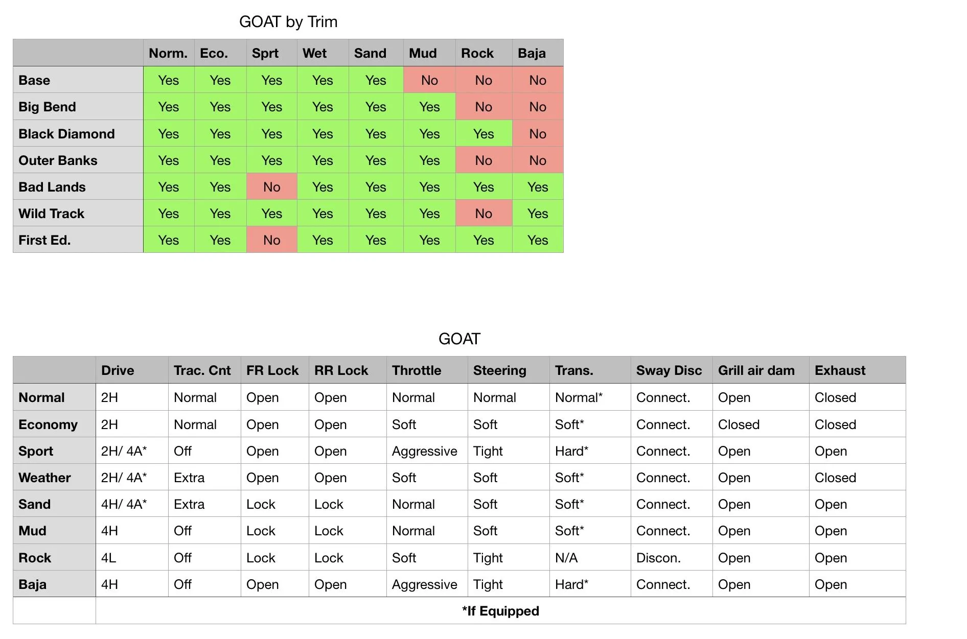

Holy shit. Sport mode on badlands? I'm doing this tonight. Keep up the good work! I would love cameras while moving. My kids get a kick out of Baja mode because of the front camera but I prefer not using it on-road.
Would also be down for stop-n-go and lane centering. I already have ACC if that makes things easier.
Has anyone determined if Sport mode is any different than Baja mode and then switching to 2H?
Is it worth adding? Or is Baja already giving us the same thing?

Yes this would require ACC already. I believe I could help reverse engineer ACC for those that don’t have it, as I’ve seen that done in the past, but it will be quite the project for those people.
I haven’t gone back into Baja mode since adding Sport but the last time I used Baja I remember it really holding out the lowest gear possible. Sport mode behaved way more normal and seemed much more daily driving friendly. I’ll compare the two again soon just to confirm.

Ahh ok that would make Sport worth adding. Baja mode definitely wants to rev higher than what feels street drivable....

SPORT MODE! I know what I'm doing later this week!
