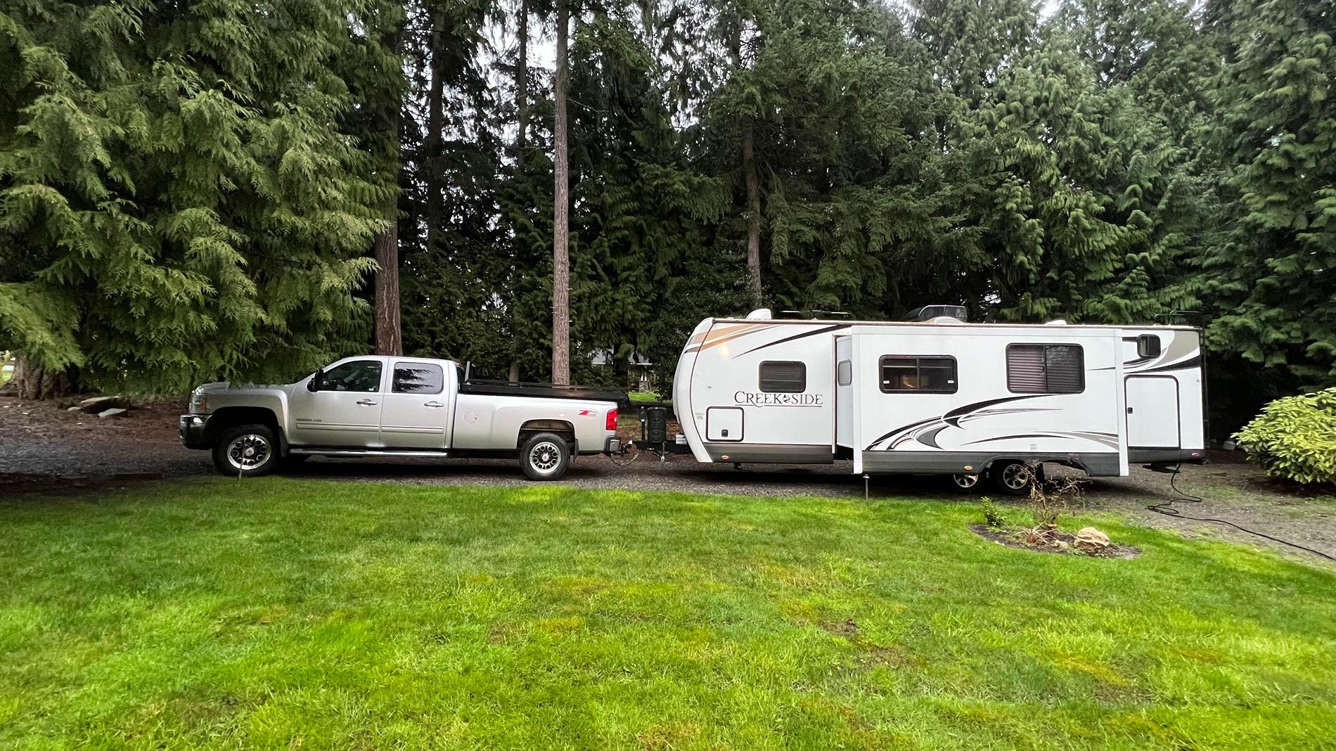

If I pass a 2dr pulling this trailer, expect to see me doing this 🤦‍♂️
Uh no. I'm pretty sure it'd break my Bronco just hitching that in the driveway!

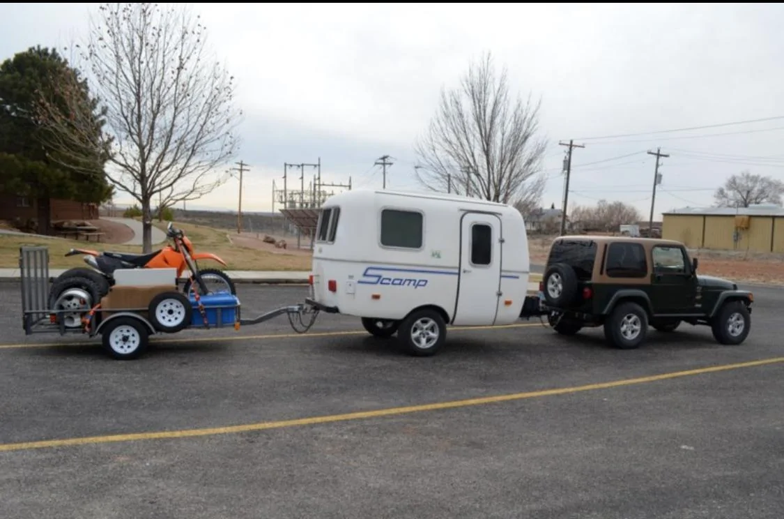

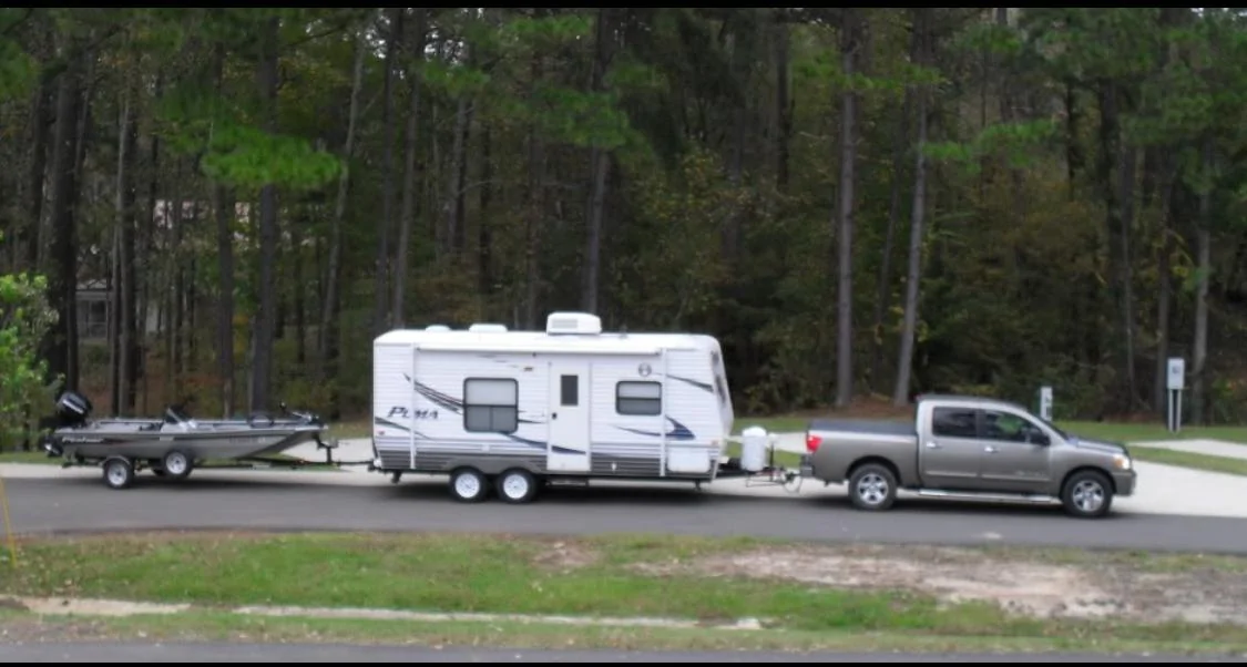

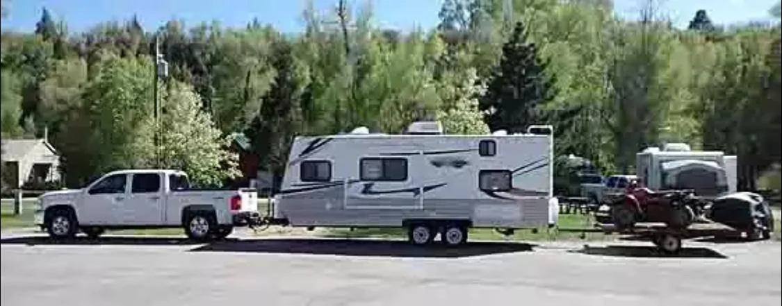

Actually, maybe I’m looking at this all wrong. A guy could simultaneously flash his mancard while passing you with this setup behind a 2dr:
Ford Bronco 2-Door Towing - Safe and stable? IMG_0975
or this
Ford Bronco 2-Door Towing - Safe and stable? IMG_0976
Or this perhaps
Ford Bronco 2-Door Towing - Safe and stable? IMG_0974

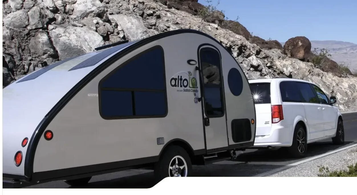

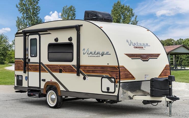

Thanks, this sounds positive! No plans to go over limits, I'd install a brake controller for sure and an anti-sway hitch. The trailer I picked can be towed by just about anything and has electric brakes. The one she wants weighs too much IMO. My pick is the Safari Condo Alto (1991 lbs and very aerodynamic), she likes the Coachman Vintage Cruiser 17SCD (2800 lbs, too much like a standard camper). I'd think the Alto would be no problem, I'm not on board with the Vintage (except the price). Based on the feedback the Vintage isn't a good fit, maybe she'd go for the Alto if we get it wrapped to match her HEL Bronco...that we don't own yet. We don't use our current RV anymore, over 50' bumper to bumper, time to downsize to 2-person setup.

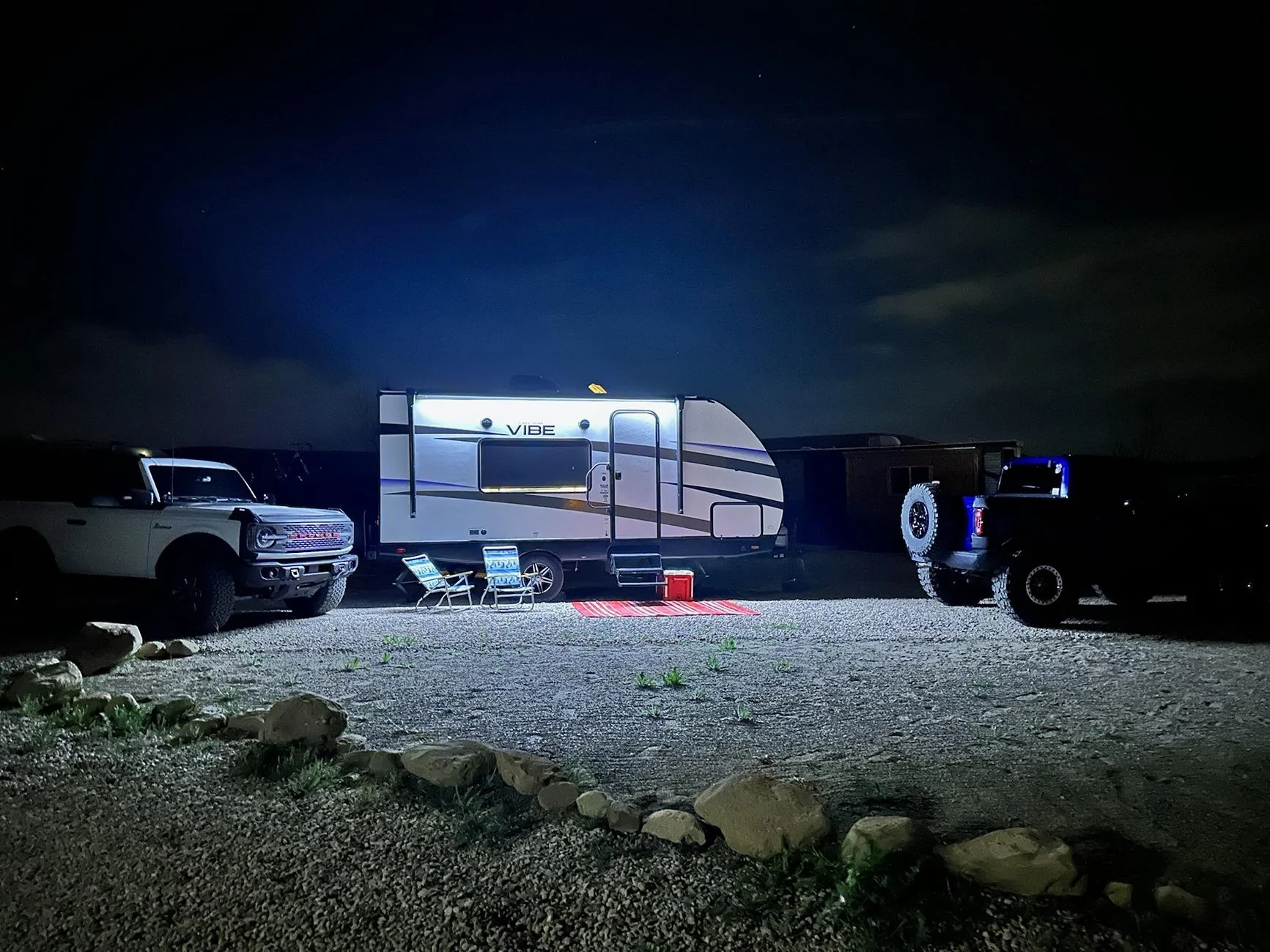

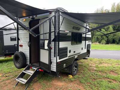

My camper is about the same size as the 17SCD.
Ford Bronco 2-Door Towing - Safe and stable? 66a2895c584d65030a4f84d4
Essentially what my trailer looks like.

In Oregon we can do THREE trailers...ROFL

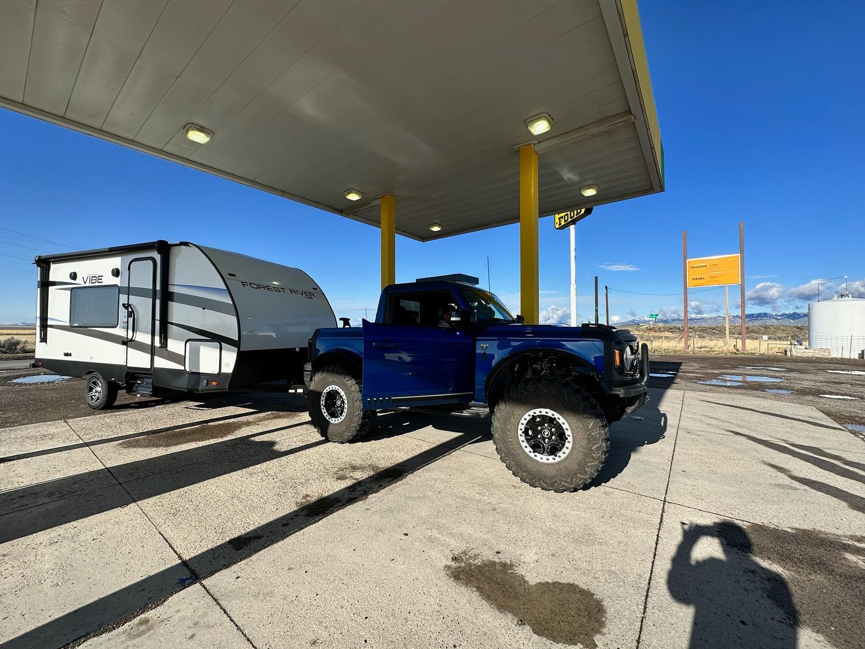

On the other hand I've towed more than ANYONE with a 2dr...I've hauled a 21 ft camp trailer from Oregon to Moab, UT...weight is about 3800lbs...no issues.
towed out my 40,000lbs peterbilt while smoking all 4 tires on dry pavement!!!

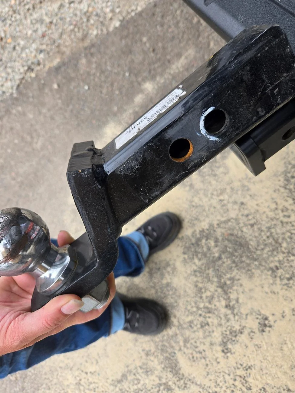

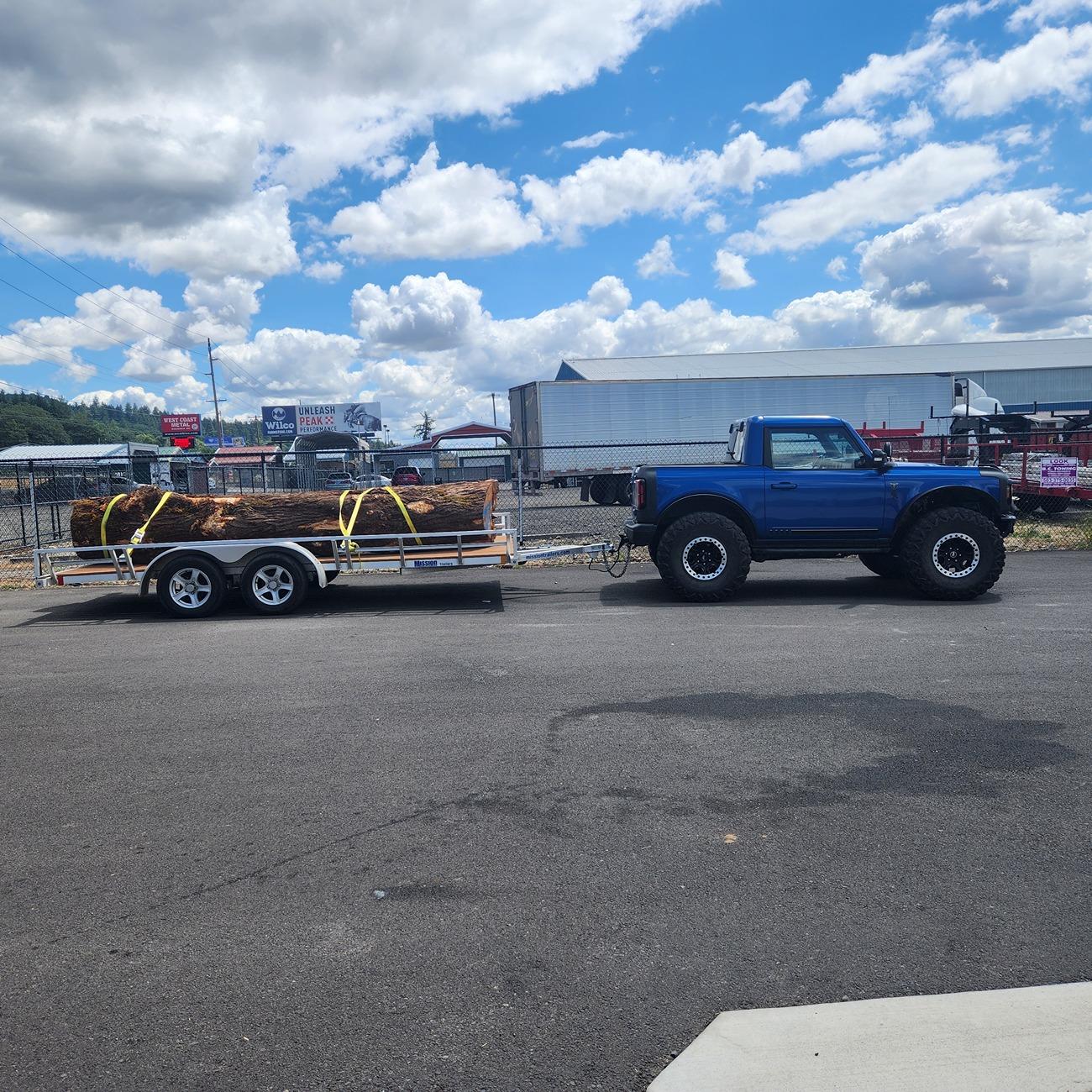

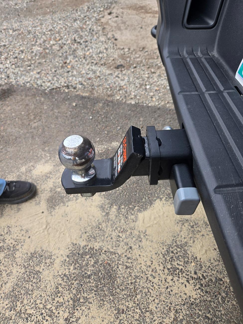

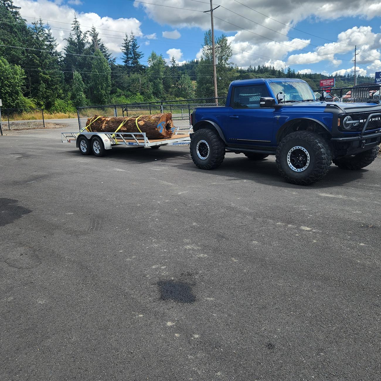

I also tow a small aluminum trailer with heavy logs on it from time to time up to 5,000 lb short distances less than a hundred miles. Today I was looking at a removable fifth wheel hitch for my half cab pickup in all seriousness. The dealer has one that was removed from a purchase truck at a discounted cost off of some other F-series and I intended to get a price on it simply because it was quickly removable with two latches which I like a lot. And because when I really want to tow something heavy I could use a fifth wheel trailer and have almost no tongue weight. With the Dana 60 rear end and some upgraded heavier Duty brakes, I feel like I can haul 10,000 pounds no problem with the two door setup with the fifth wheel in the back similar to a pickup truck. The biggest issue I see is most people have their hitch way too far out from the rear bumper I actually drilled a new hole in the 2-in plug that goes in the receiver and a closer position so that the ball sits nearly right against the bumper instead of 5 in away. This makes a difference on a two-door. Anyway here's a few photos

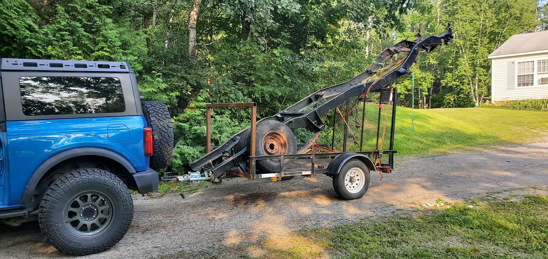

This was a terrible experience...
...but... everything about this is WRONG lol 😆
I knew that before I drove 150 miles to get the damn frame.. it was just too good of a deal to pass up.
48mph the entire way home on the freeway.. thankfully there's no traffic that far north at that time of day lol.
On the other hand I've towed…
Picturing three trailers behind a 2dr anything just made my day. And we both know there’s someone out there oblivious to the risk that’s probably tried/done it.
You sound like you’re not short of towing experience and while I agree with most (not all) points you make here, not gonna lie, right now the curiosity of how your truck will look with a gooseneck trailer is killing me. Now you have to do it! Haha. You even have me picturing where you could mount airbags to level it out. Haha
@mpeugeot , very nice. I've been looking at several trailers with this floorplan, ideal in my mind. Currently I have the motorhome and tow the Bronco, but if I ever switch it up this is the way.
mpeugeot
May 14, 2021
9,147
18,928
I lived in it for 3 months straight, and it was a pretty damn good trailer. It can sleep upto 4, but really it shines best as a couples camper or for a single person.
I even managed to mount a 42 inch TV in it. The only thing I really didn't like was the AC unit. It needed to be ducted to distribute the airflow better and decrease the noise. Also, if you are going to be spending extensive time living in it a dehumidifier is essential to keep moisture from building up inside with the AC on full time.
dgorsett
Apr 3, 2019
5,043
10,096
colorado
F250, Mustang, Explorer
Just 2 of us, haven't watched the TV in ours much, AC is broke in ours now and don't know if I care (We chase moderate temps, desert in winter mountains in summer) and we always seem to go to dry climates!! Perfect!
The only drawback I could see was lack of storage for food and clothing
