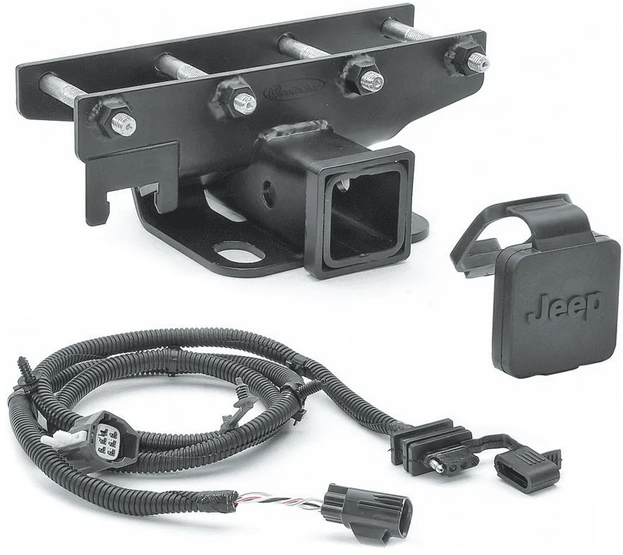

Just a heads up ,for me the Class II hitch will be fine, but I'm getting a Base so it's not a factory option, but the aftermarket will fix me up for $500 less: Under $100 on Quadratec, I'm sure they'll have one to fit a Bronco soon.
Go with a class III. Much more stable towing, and if you go over the tow weight, it will be attached to the frame, no just a cross piece...
Like I said, I'll be happy with the Class II, seldom will tow with this rig, maybe just a utility/atv trailer under 2000#. I might use it for a jack point for the handyman, or to tie on a tow strap.
Now, not trying to be argumentative but: How is the boxed frame cross member welded by Ford to the same frame rails a Class III would bolt to weaker than an aftermarket hitch with ears bolted to it?
Class III should not bolted to the cross member, but to the frame. Distributes the weight better. Torque and weight goes to the outside, not the middle. Nothing wrong with class II, but the more stable a platform you have, the easier and more stable the tow...
