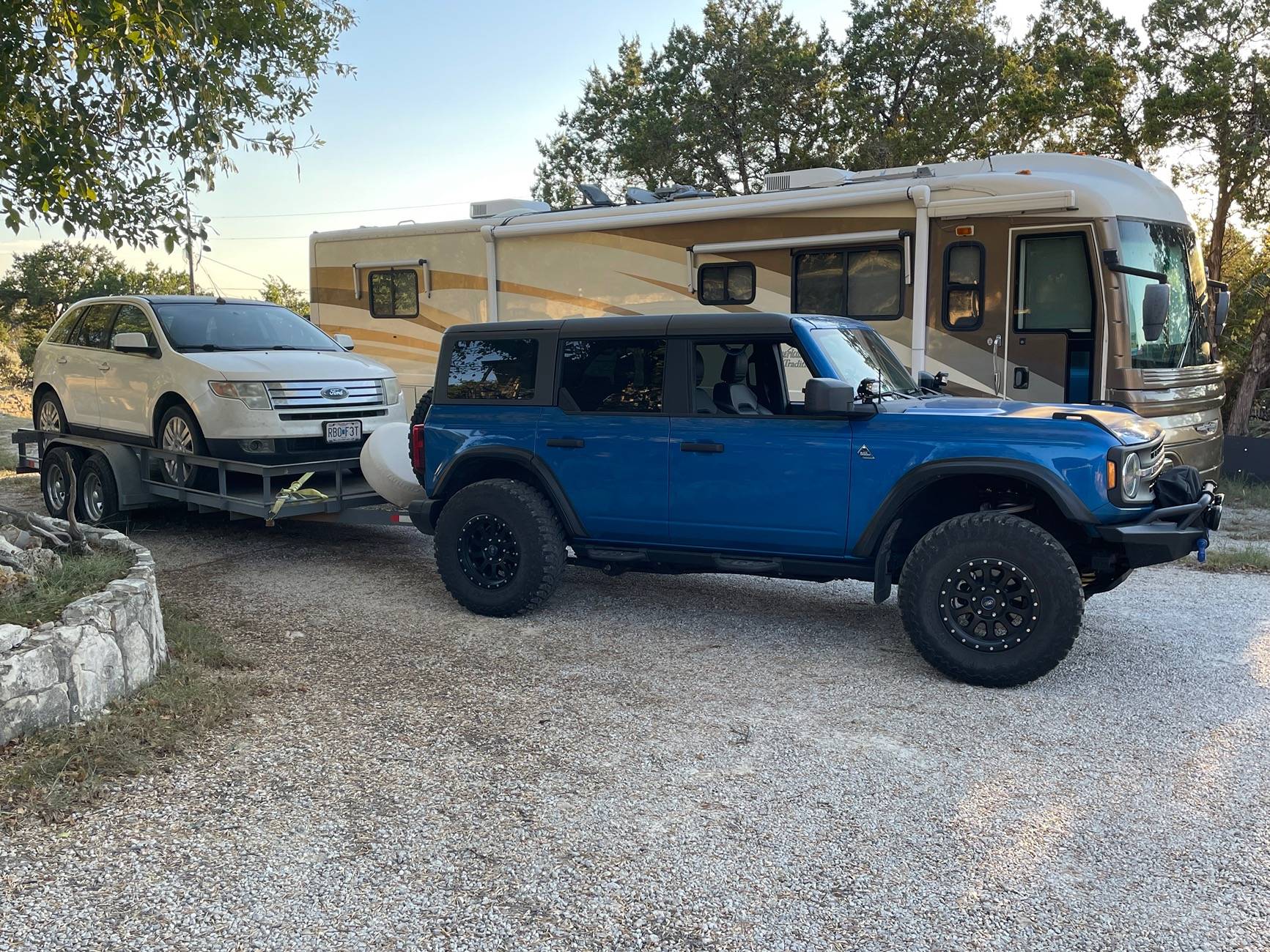

Towed my son’s car to his shop with the Bronco today. Car weighs 4100, no clue what my all steel trailer weighs. 1500#?
There are some decent hills on the route so purposely loaded it a little tongue
heavy to reduce chance of sway down the hills. I was very surprised how stable it felt given the fact that I didn’t air up the tires and I’m on soft Eibach’s. The 2.3 had plenty of power. I’m on 35’s with 4.46 gearing. Soft suspension and hitch mounting are the only limiting factors for towing with these. Maybe a 2-door would have felt a little iffy, IDK. The sway control is amazing… apparently.
Thanks for sharing that image of a Carolina squatted Bronco, lol.
Yea those Eibach springs are pretty squishy lol. I was afraid to pull it with less weight on the tongue. Felt surprisingly stable though. Wouldn’t do it very often, I have an Excursion for towing.
