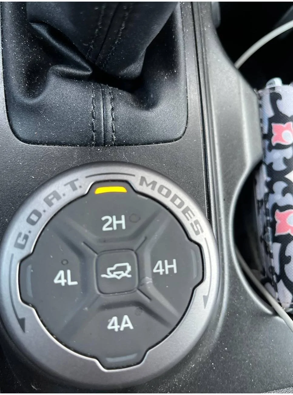

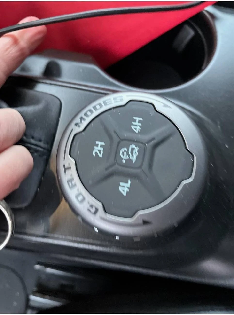

Does the manual transmission have the Advanced 4wd transfer case?
You can tell if a Bronco has the Advanced 4wd or Standard 4wd by looking at the GOAT mode dial on the center console. The Advanced will say 4A, the Standard that position will be blank.
