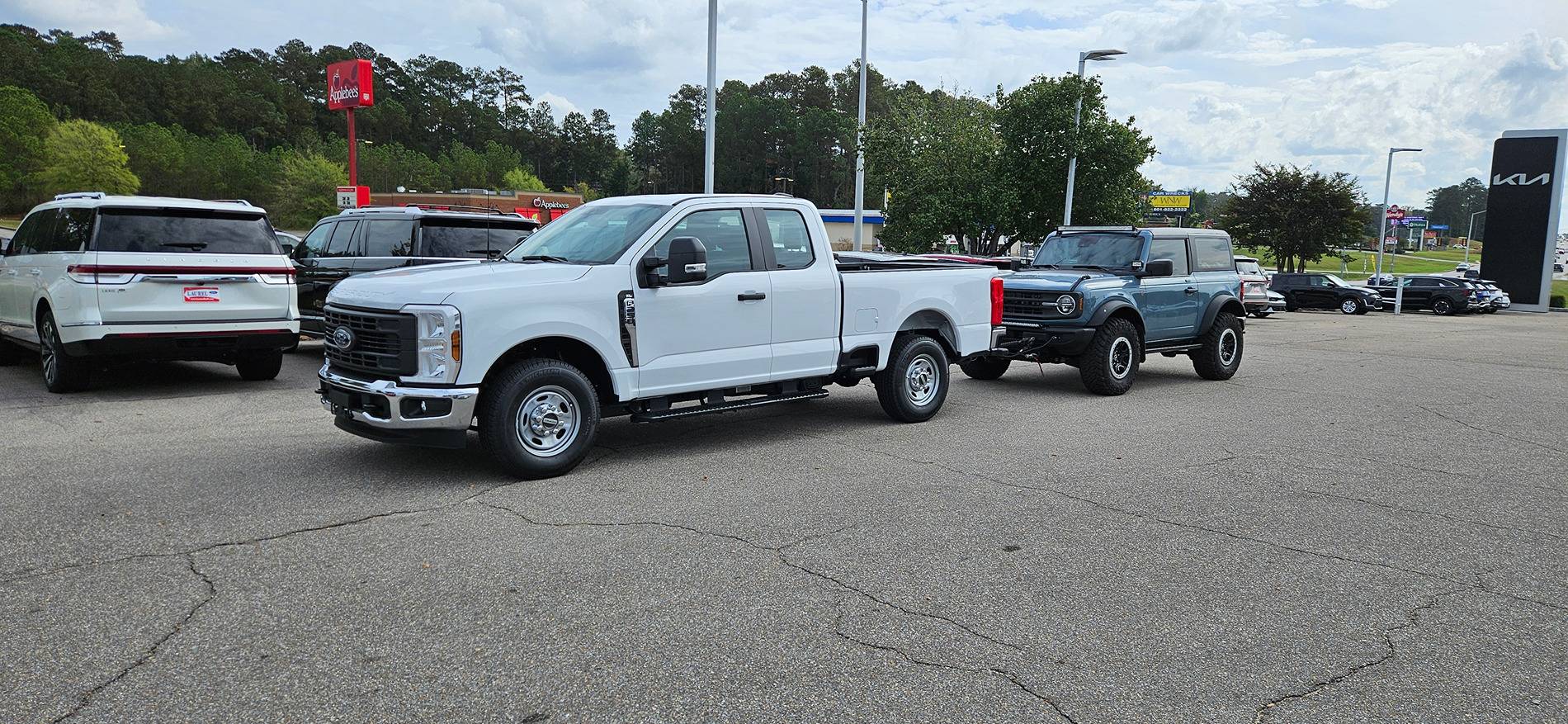

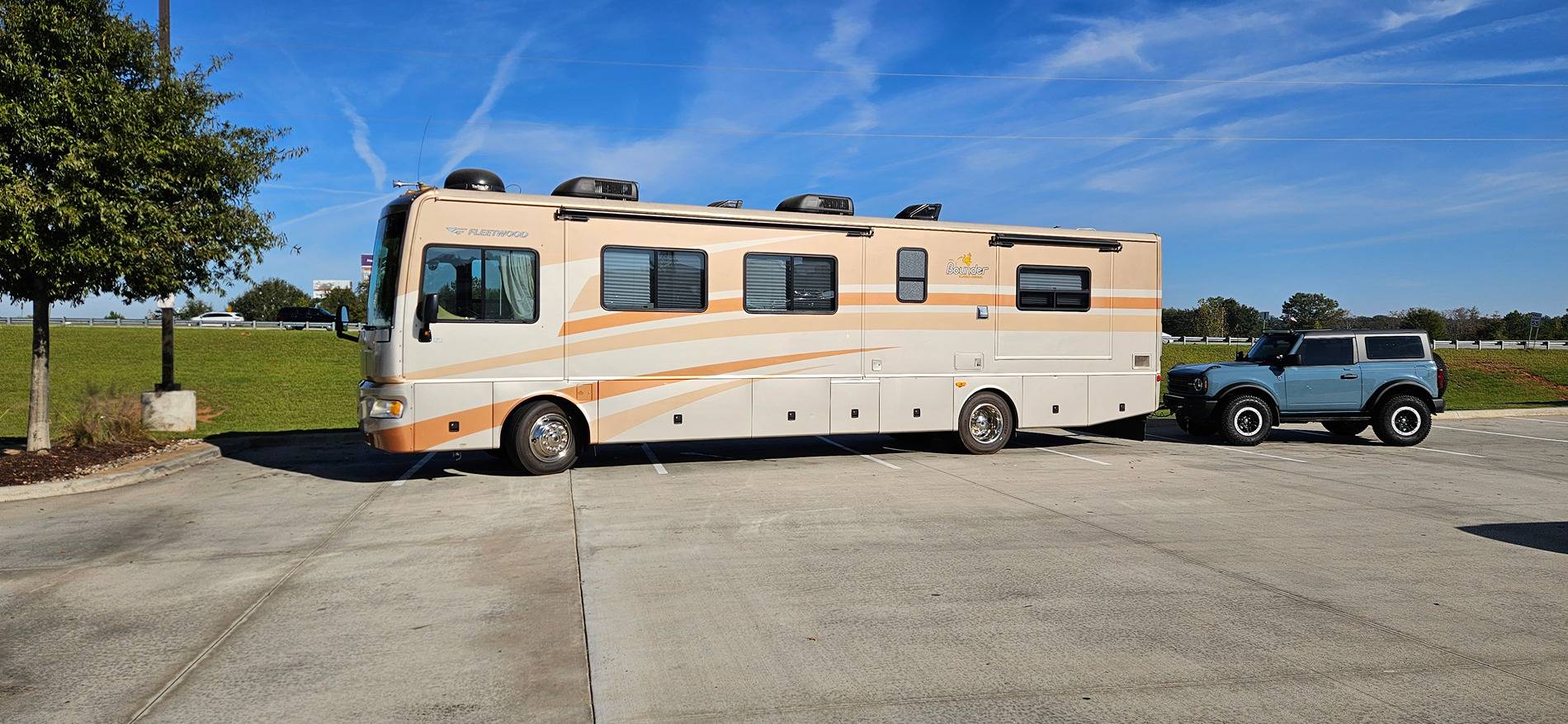

I flat tow all the time no problems. Butttttt I have a manual transmission . Have not heard of any problems with the 7mt. I would not trust the Auto for all the above reasons given.
