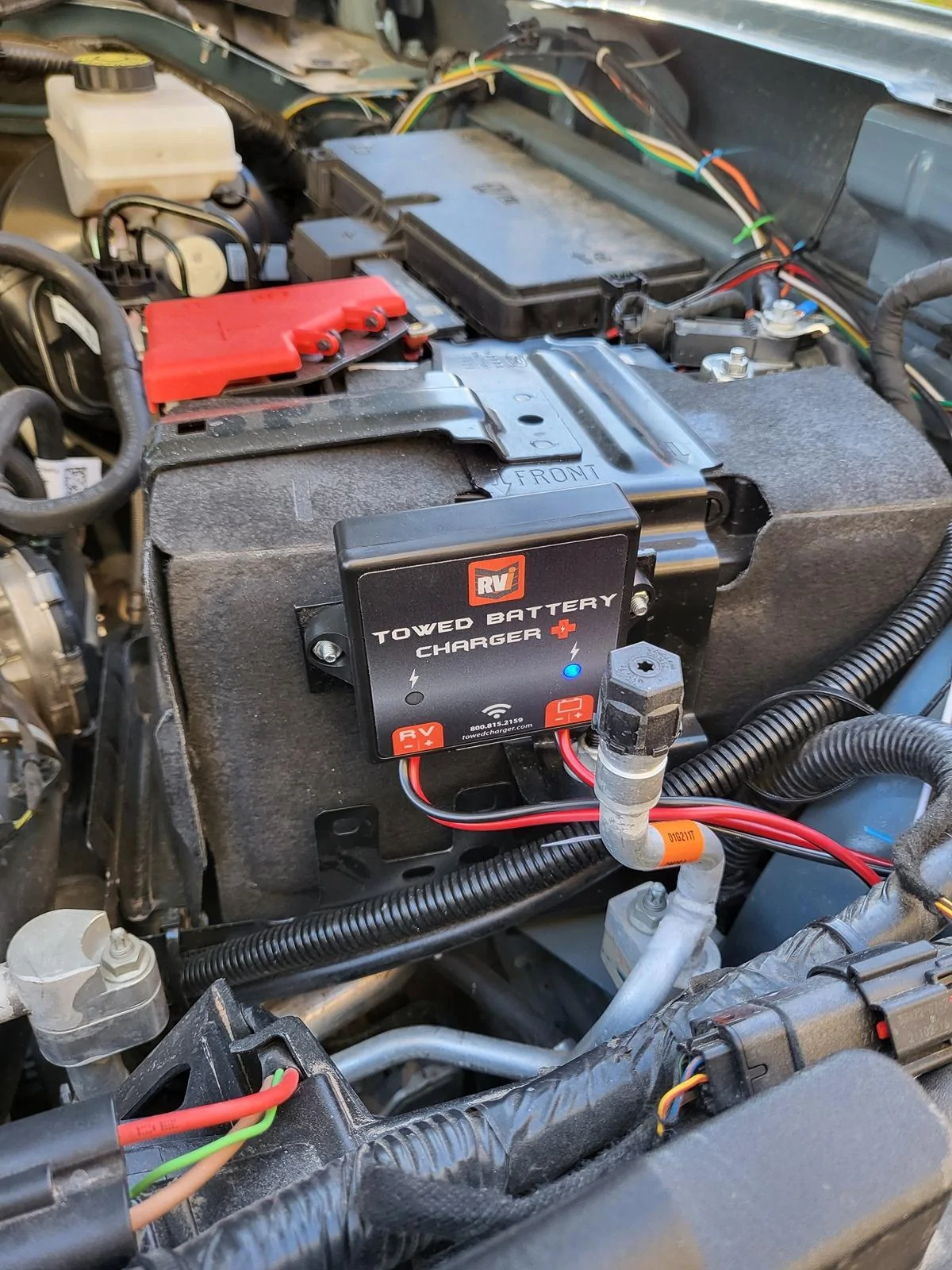

The RVI version. Quite a bit more expensive. Monitors rv and towed side

Do these get ground from the MH through the hitch? Brake Buddy one doesn’t look like it has a ground wire to connect to the MH.

The RVI grounds on the towed battery AND through the 6 pin connector to the MH. They really emphasize grounding both.
