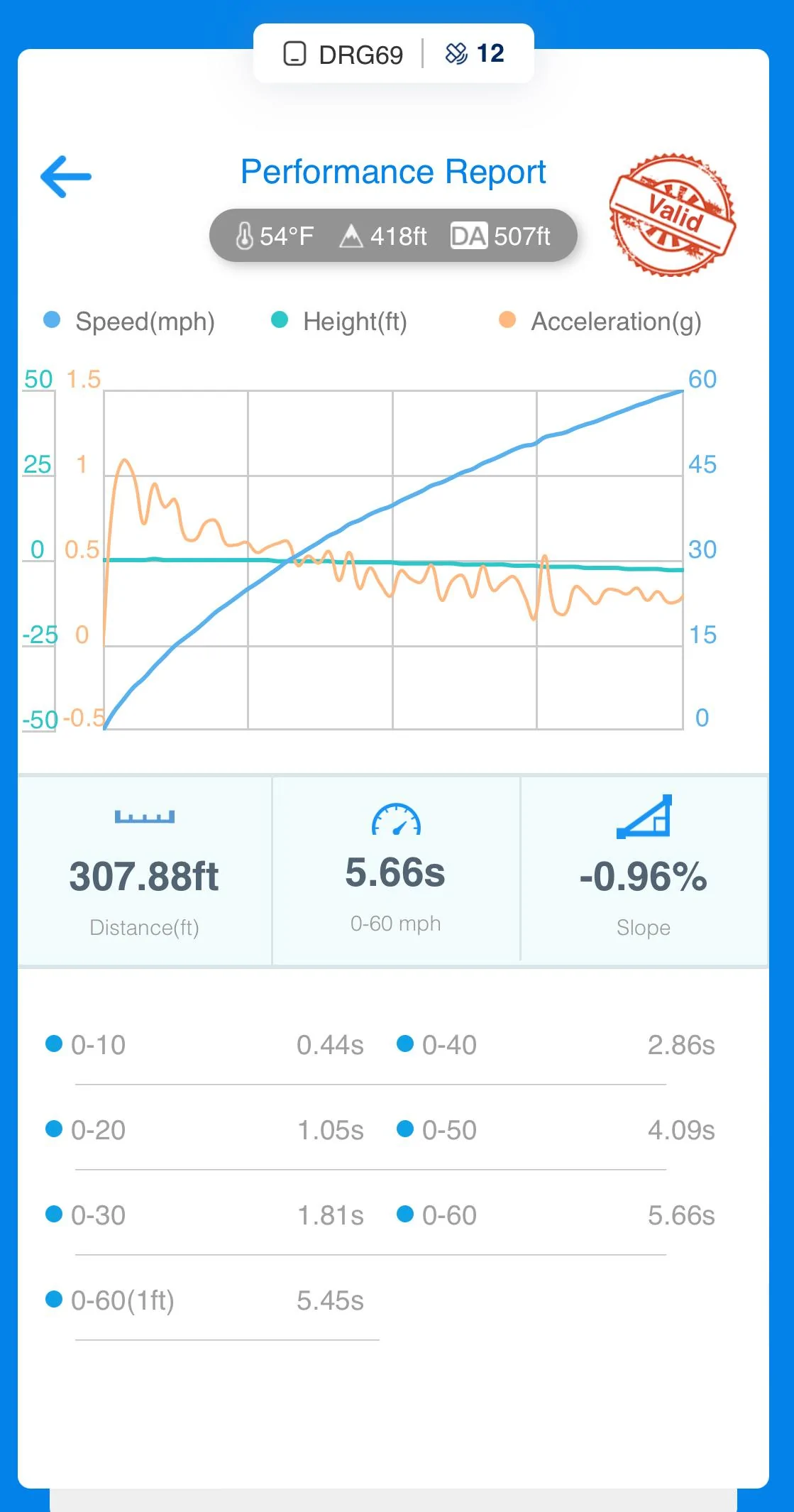

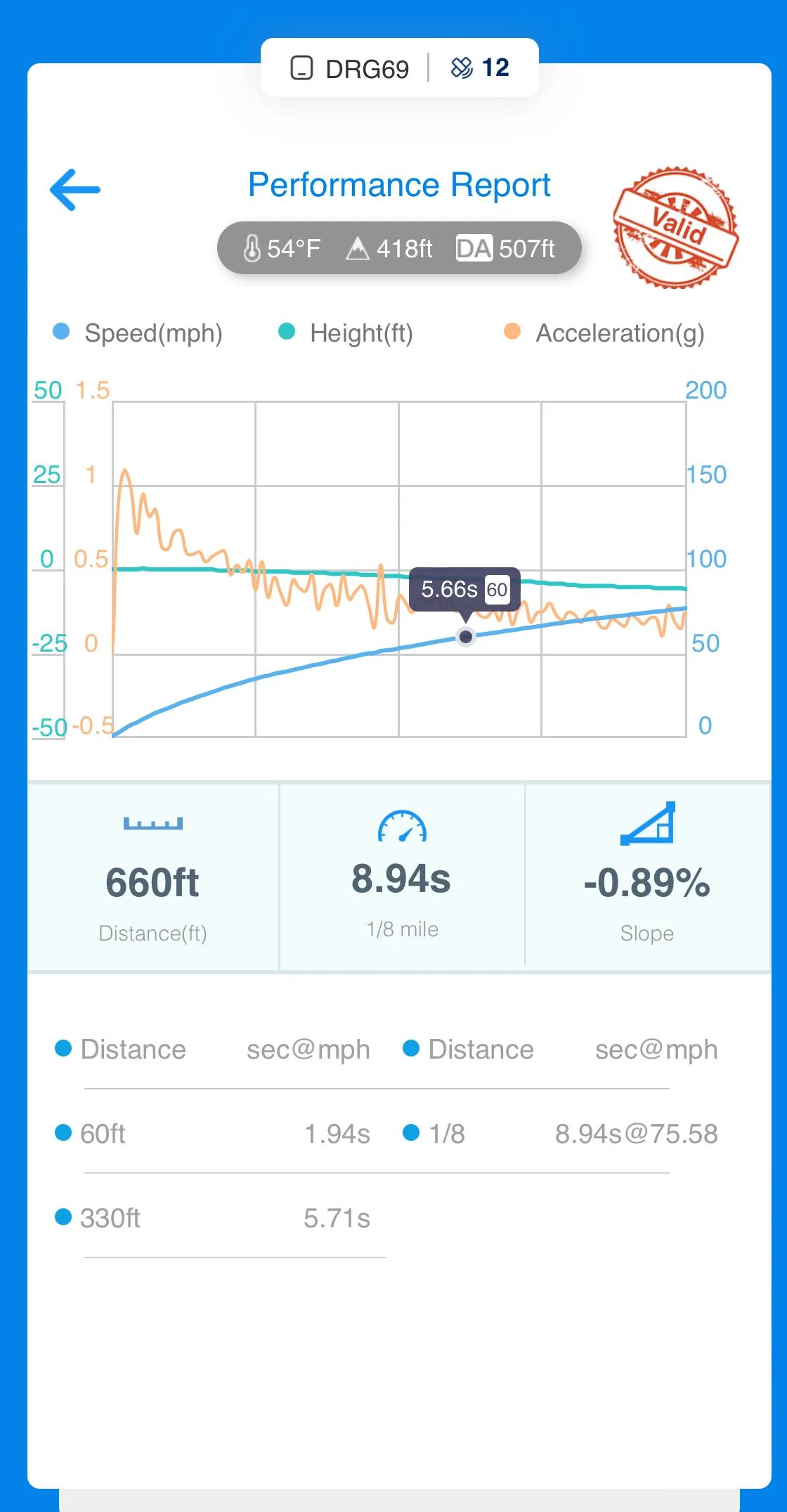

Did my 0-60 and 1/8 mile with the addition of Injen CAI and Turbosmart BOV. No real improvement flat out, but in day to day driving I noticed a solid improvement in midrange power. Think i’m gonna need more boost plus an intercooler for it to make a substantial difference. I'll disconnect the negative battery cable for an hour to see if that helps.
E30 next…
Ford Bronco 0-60 in 4 Seconds - My 2.7 Bronco Performance Modification Thread IMG_0222
Ford Bronco 0-60 in 4 Seconds - My 2.7 Bronco Performance Modification Thread IMG_0223

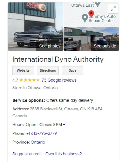

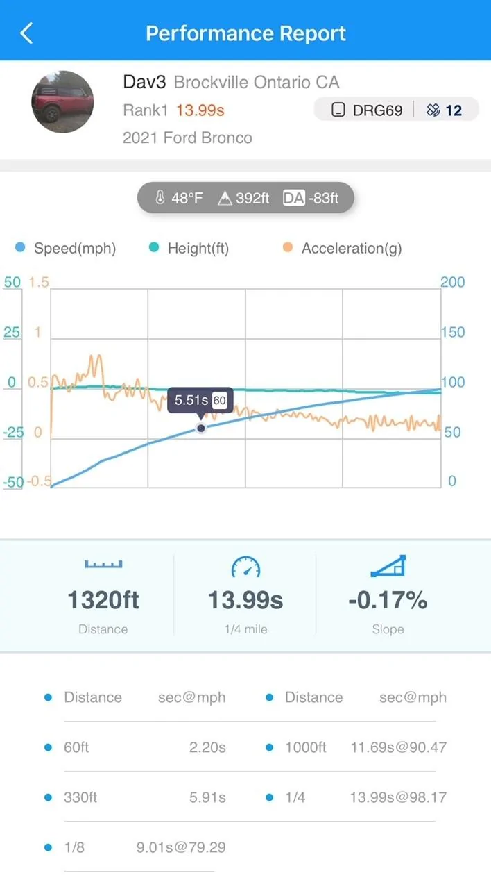

So I made an interesting discovery looking through the Dragy leaderboard within the app. Not sure if anyone remembers, but the first custom "tuned" Bronco was done by International Dyno authority. They added a K&N CAI and custom tune to a Big Bend 4dr soft-top with a 2.7L.
Here's the run:
0-60 = 5.51
1/8 Mile = 9.01
1/4 Mile = 13.99
60 Ft = 2.20
Ford Bronco 0-60 in 4 Seconds - My 2.7 Bronco Performance Modification Thread 1704725813516

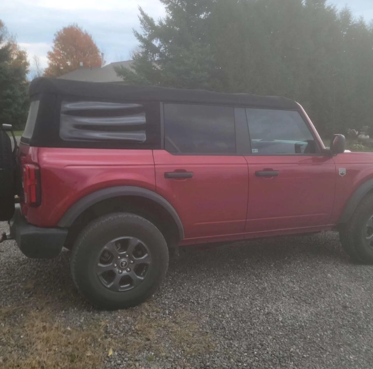

Now take a look at the profile picture and location:
Ford Bronco 0-60 in 4 Seconds - My 2.7 Bronco Performance Modification Thread 1704725893269

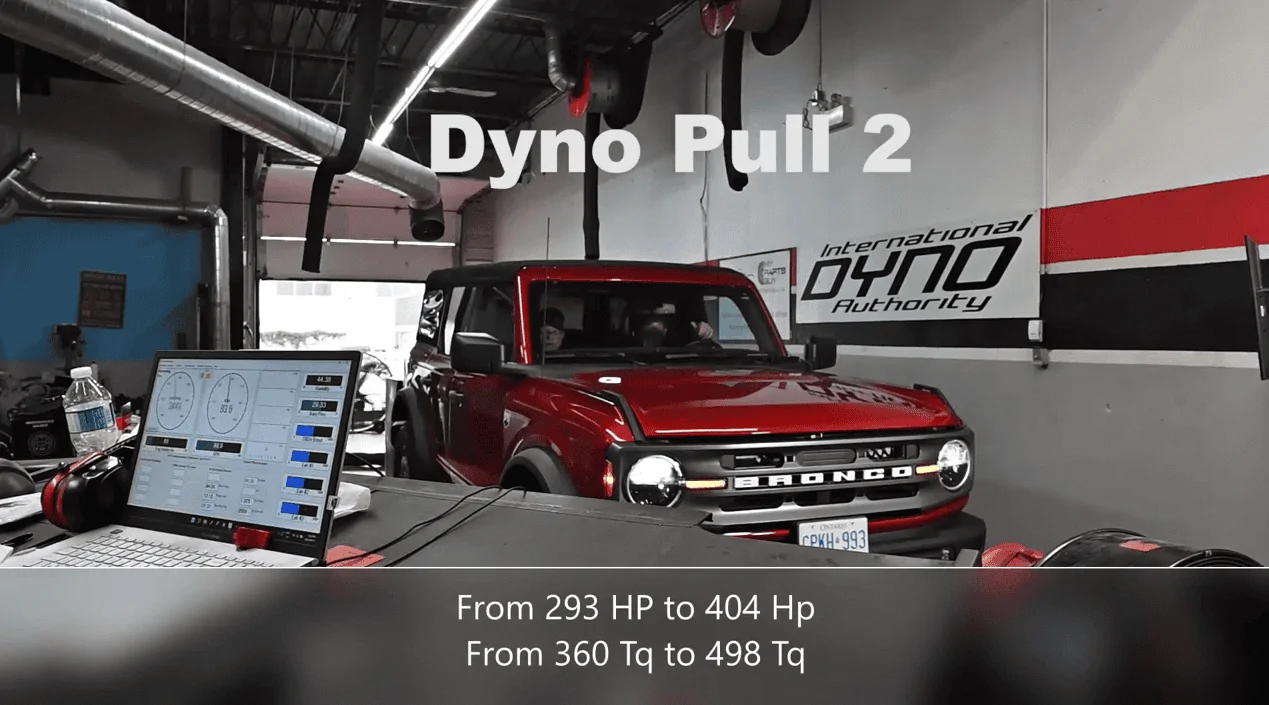

Look familiar?
Ford Bronco 0-60 in 4 Seconds - My 2.7 Bronco Performance Modification Thread 1704725909217
Ford Bronco 0-60 in 4 Seconds - My 2.7 Bronco Performance Modification Thread 1704726333119
The numbers are impressive, but I was expecting more from a Bronco with 400 HP & 500 TQ at the wheels. I assume the had a rough launch, as the 60ft times are not great. I would think this Bronco could hit 0-60 in under 5 seconds and do the 1/4 mile in low 13's. Well...I'm sure it's a beast from a roll. It also holds the number one spot for 1/4 mile and 2nd best 0-60 time, though they didn't upload the individual result.
