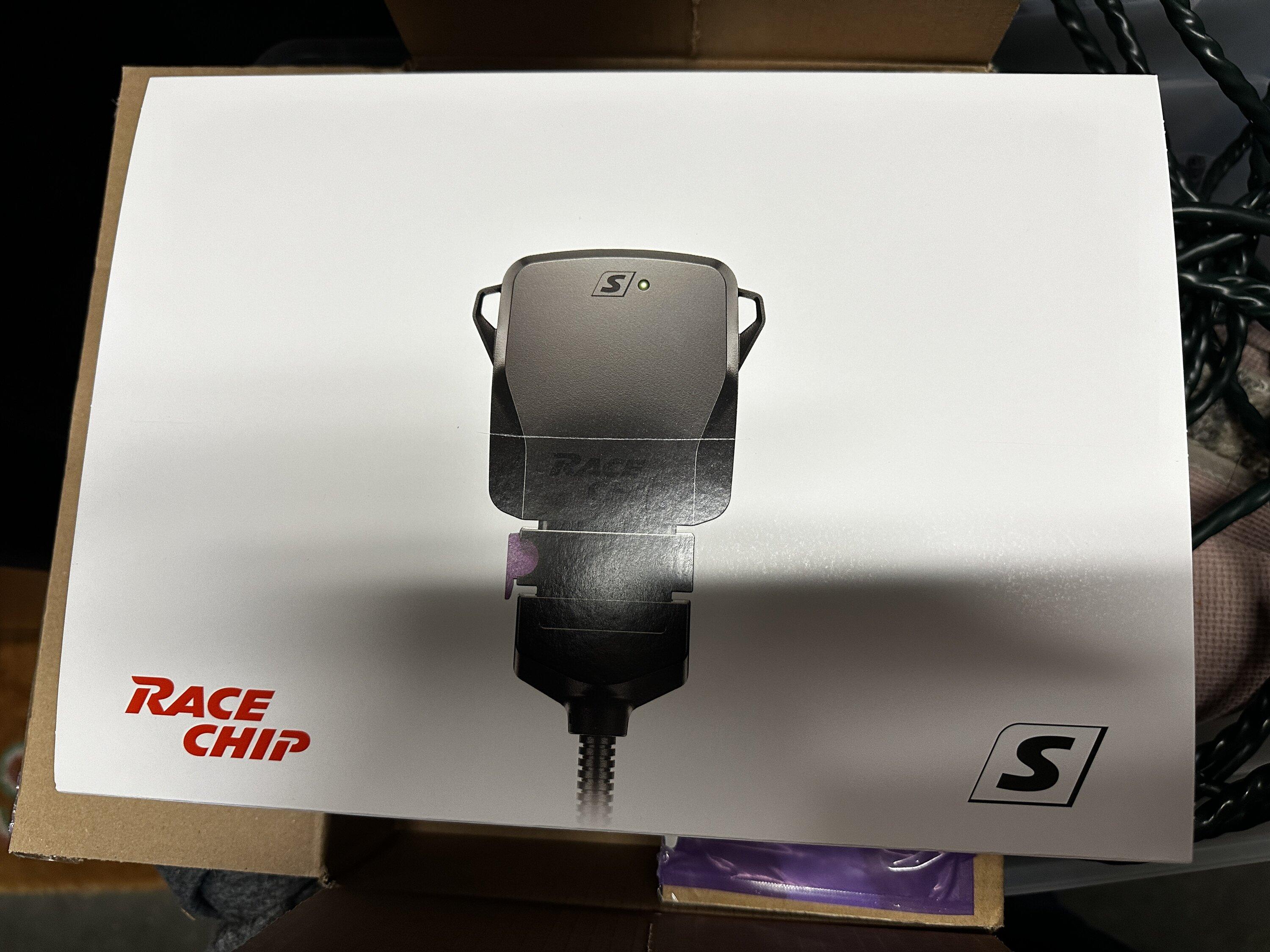

Just delivered. Going to wait until I figure out my current issue before I Install it. Don’t need another variable.
I also want to install the new plugs and CVF intercooler before hooking this up. Wanna give it as much breathing room as I can.
Ford Bronco 0-60 in 4 Seconds - My 2.7 Bronco Performance Modification Thread IMG_0246

Also, because I have no patience, I did install the Racechip (Setting 3 out of 5) and It makes a difference. Nothing huge, but it's there. Didn't do any 0-60 runs and I took it back off, as I don't want to push my luck. I want the new plugs and IC installed before I go all out. The IC just got here yesterday, but still waiting on the plugs to ship.
