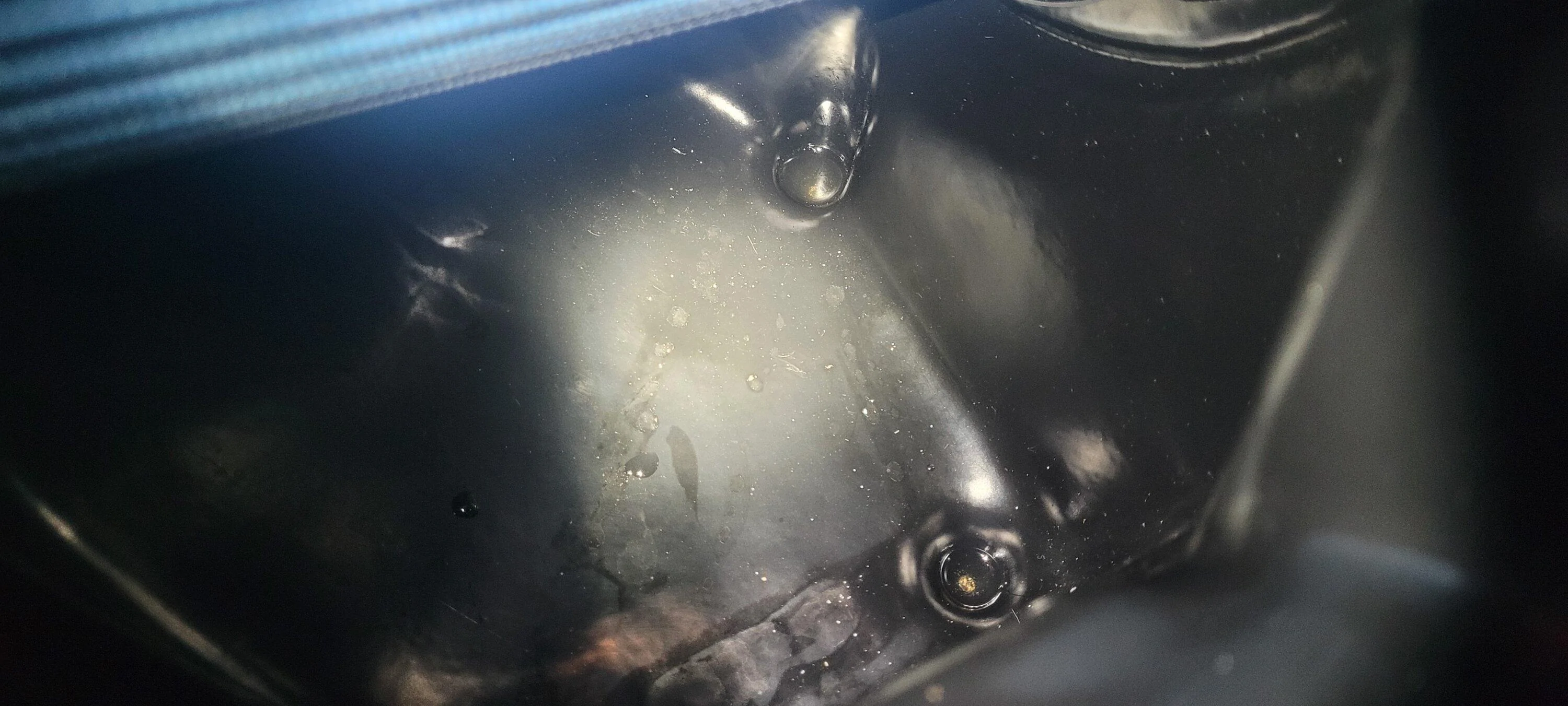

drove about 50 miles yesterday in a major down pour with some snow and decided to look in the injen air box have some water in the very bottom of the indentations not much but some is getting in don't think it is much to worry about was thinking about maybe drilling a small hole in each one when i pull the filter i know that someone had asked about this so i thought to check this morning just some info for you guys and gals(y)

When I did my Injen install, I did drill a small hole in it, the same spot the Ford hole was in. I then used a small piece of screen and glued it underneath. Drain hole. As it been noted, I do not get water in the system, but I figured if Ford did it on the OEM, it would not hurt to do it on the Injen.

thinking that is what is going to be done in each indentation since the have a small amount in each one thanks for your input also i didn't think to look at the oe one when I installed it and didn't really want to drill in the new product seems like injen should put small holes in these spots

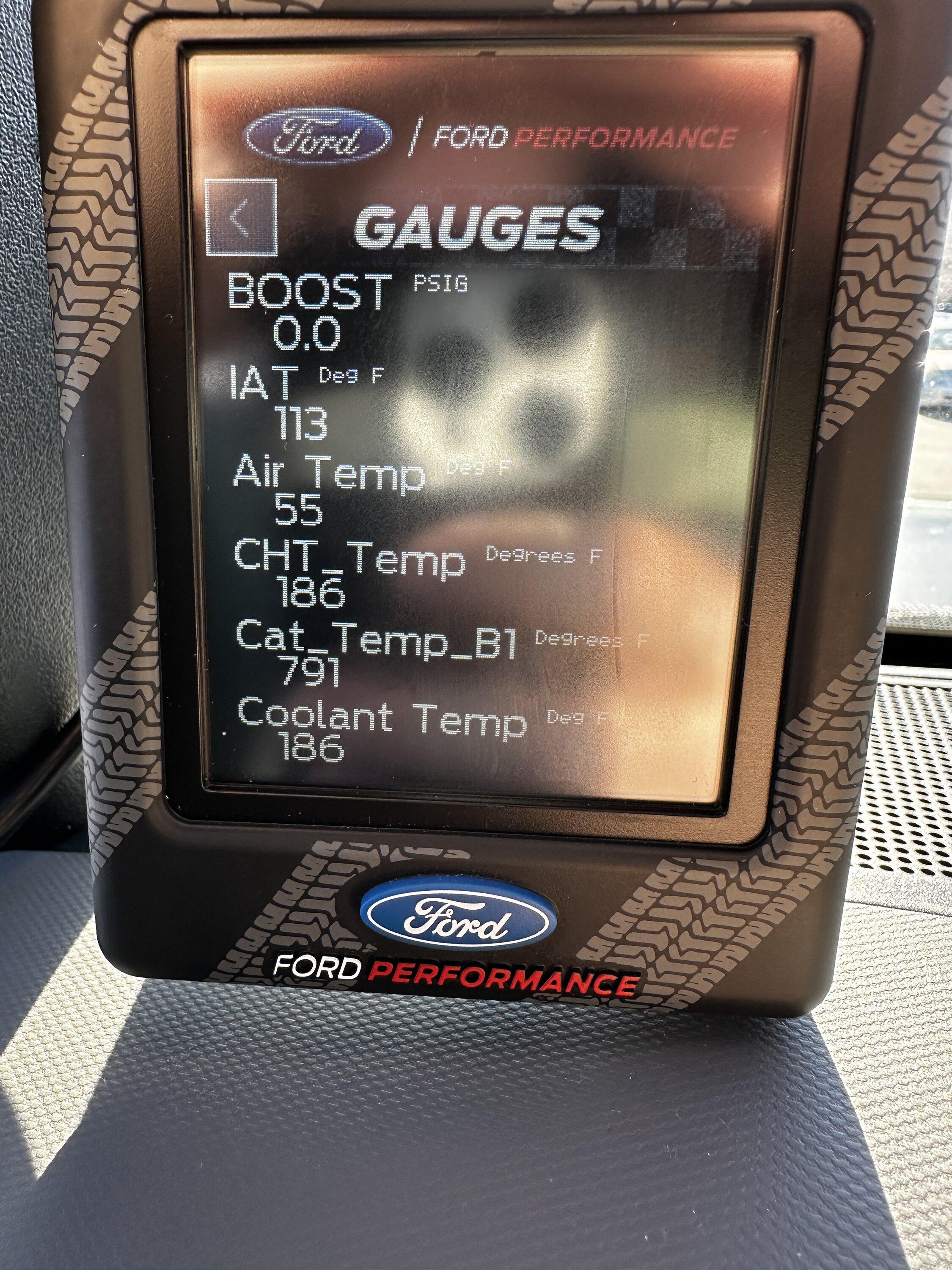

Just set the ProCal up so I can monitor IATs before the Intercooler goes on. Also put the RaceChip back on and set it 3 out of 5. Man, it feels good. Very smooth power delivery and more of it. Can’t wait to try out setting 5 when the plugs and IC are installed.

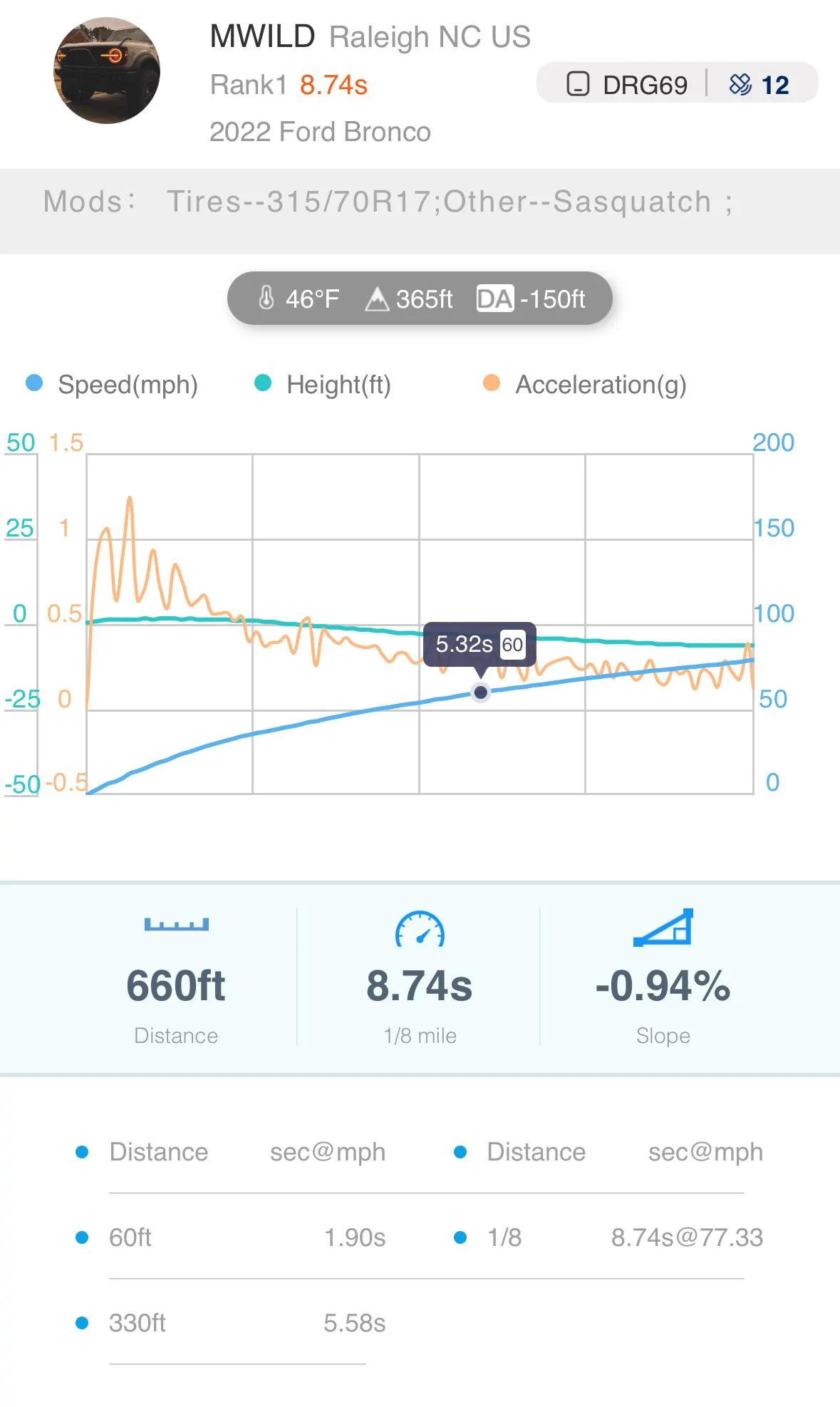

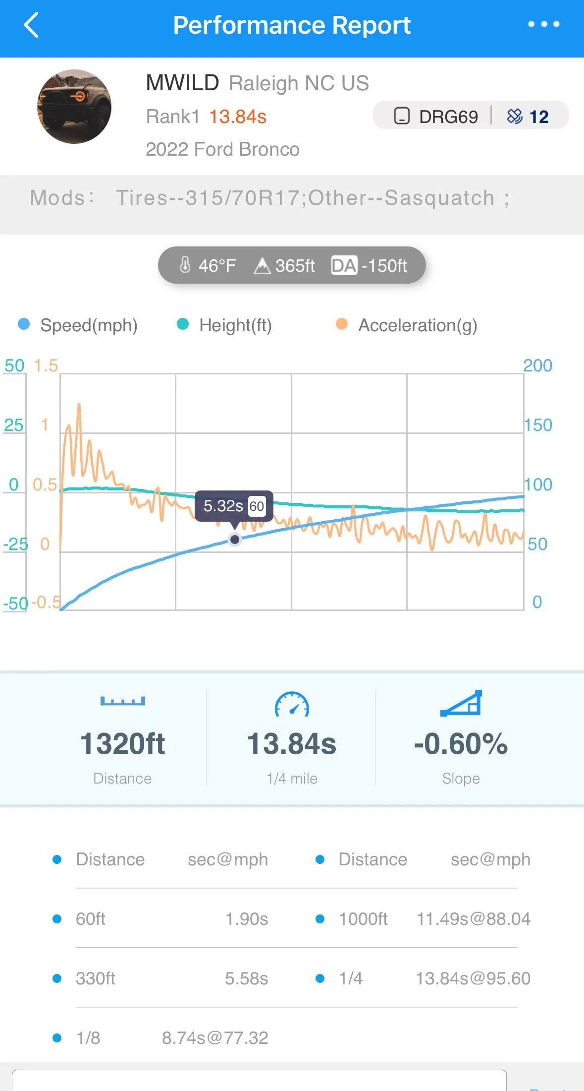

Today I’ve been driving around with the RaceChip set to level 3 and the Bronco feels great. I decided to give this setup a run since I had a nice piece of road away from civilization.
This time I launched the Bronco in 4H instead of 4A. The launch was more violent and I experienced more wheel spin, though it still pulled hard off the line. Think I’m gonna drop the air pressure a bit and not launch so hard next go around to see if it improves my times… Anyway. The RaceChip was exactly what I needed. I don’t know how much boost it adds, since I can’t see the actual boost pressure w/piggyback tune…
Regardless, even on this low setting I ran the times below:
60ft = 1.90s
0-60 = 5.32s
1/8 mile = 8.74s @ 77.32 MPH
1/4 mile = 13.84s @ 95.60 MPH
This was on a fresh tank of 93. Technically, these times are faster vs. Palm beach Dyno’s run, but there was an issue with the 0-60 run being unverified within the app. Oddly enough, the 1/8 and 1/4 mile saw no issues and were verified. Doesn’t matter, I still have more to come so I’ll do it again. Still, these are BRaptor beating acceleration numbers.
Ford Bronco 0-60 in 4 Seconds - My 2.7 Bronco Performance Modification Thread IMG_0270
Ford Bronco 0-60 in 4 Seconds - My 2.7 Bronco Performance Modification Thread IMG_0269

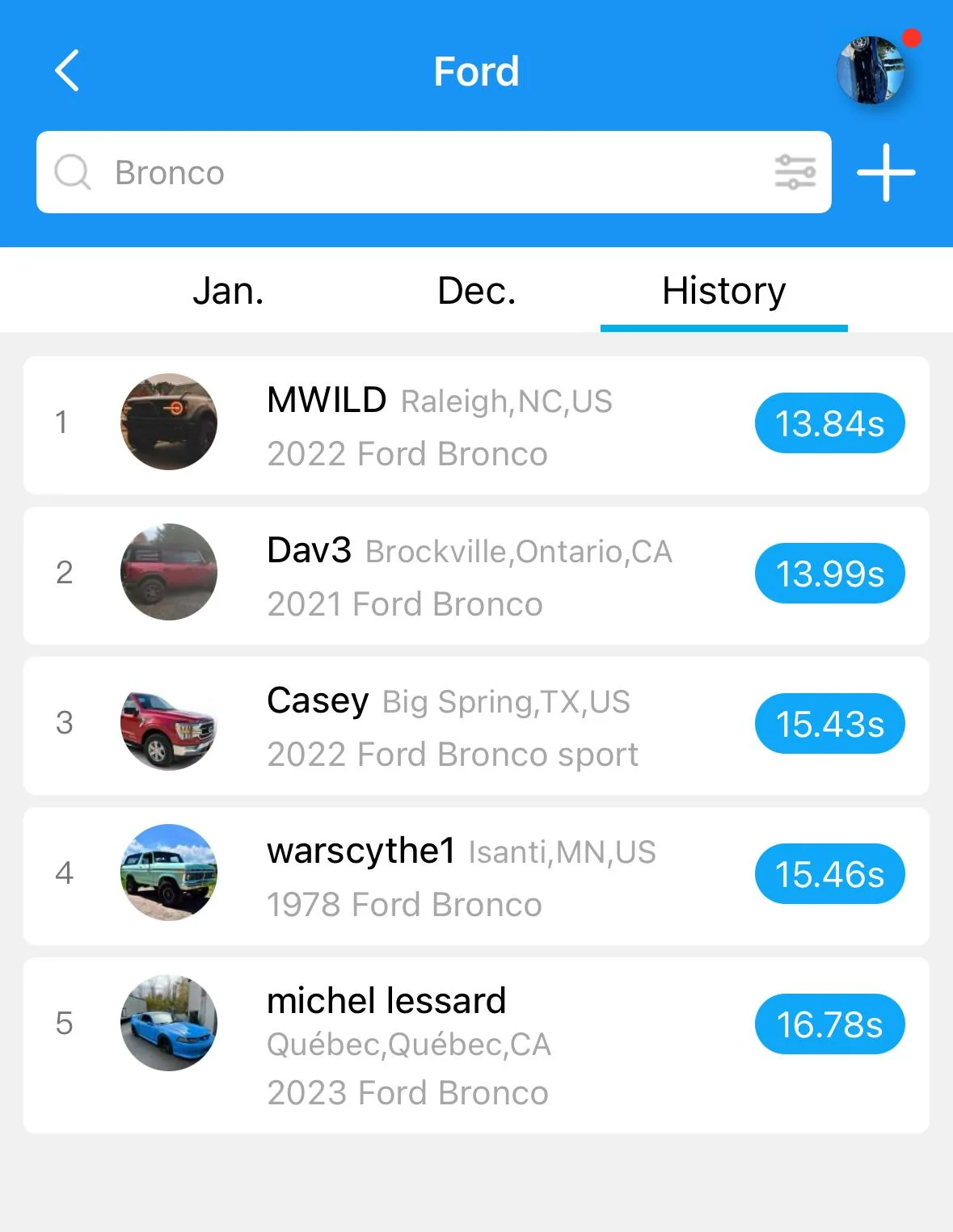

As it stands, I have the #1 spot for 1/8 and 1/4 mile in the Dragy app. I’m sure that won’t last for long, since I’ve seen a BRaptor with a Pulsar XT tuner run a 13.6s 1/4 mile using a Dragy.
Still, this is beating out the 400 WHP IDA tuned Big Bend with stock tires in the 1/4 mile. I’m going to guess and say they don’t know how to launch their Bronco, so I have no doubt they would be much faster with a better launch.
Ford Bronco 0-60 in 4 Seconds - My 2.7 Bronco Performance Modification Thread IMG_0271
Still have more in the tank with the parts left to come. Still need to install the NGK plugs, CVF Intercooler, set RaceChip to level 5 (If it works) and try E30 again. Tempted to order an MBRP exhaust as well. Also plan to take this setup to the dyno and 1/4 drag strip in Spring. Maybe I can find a Wrangler 4XE to pick on 😁

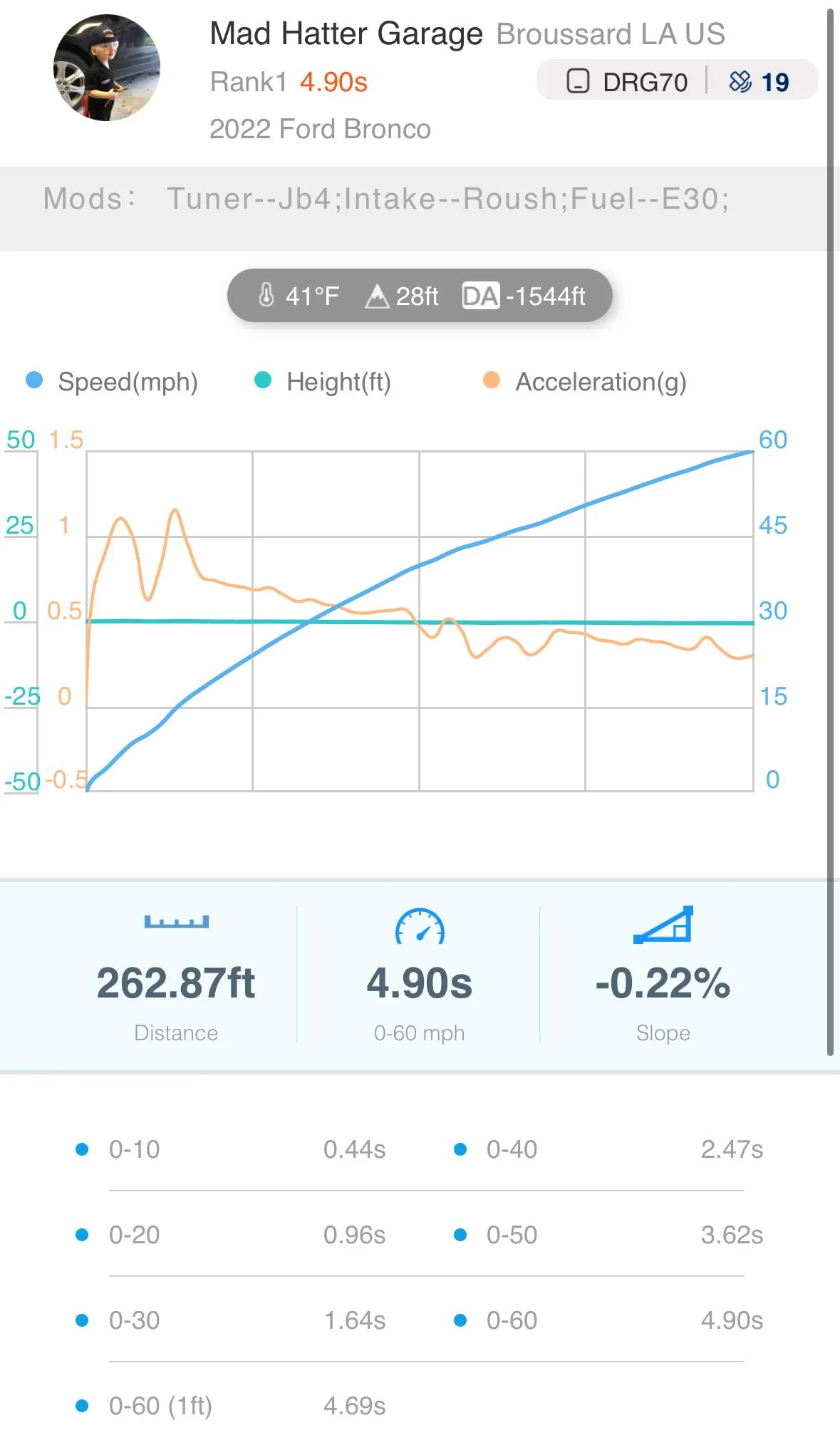

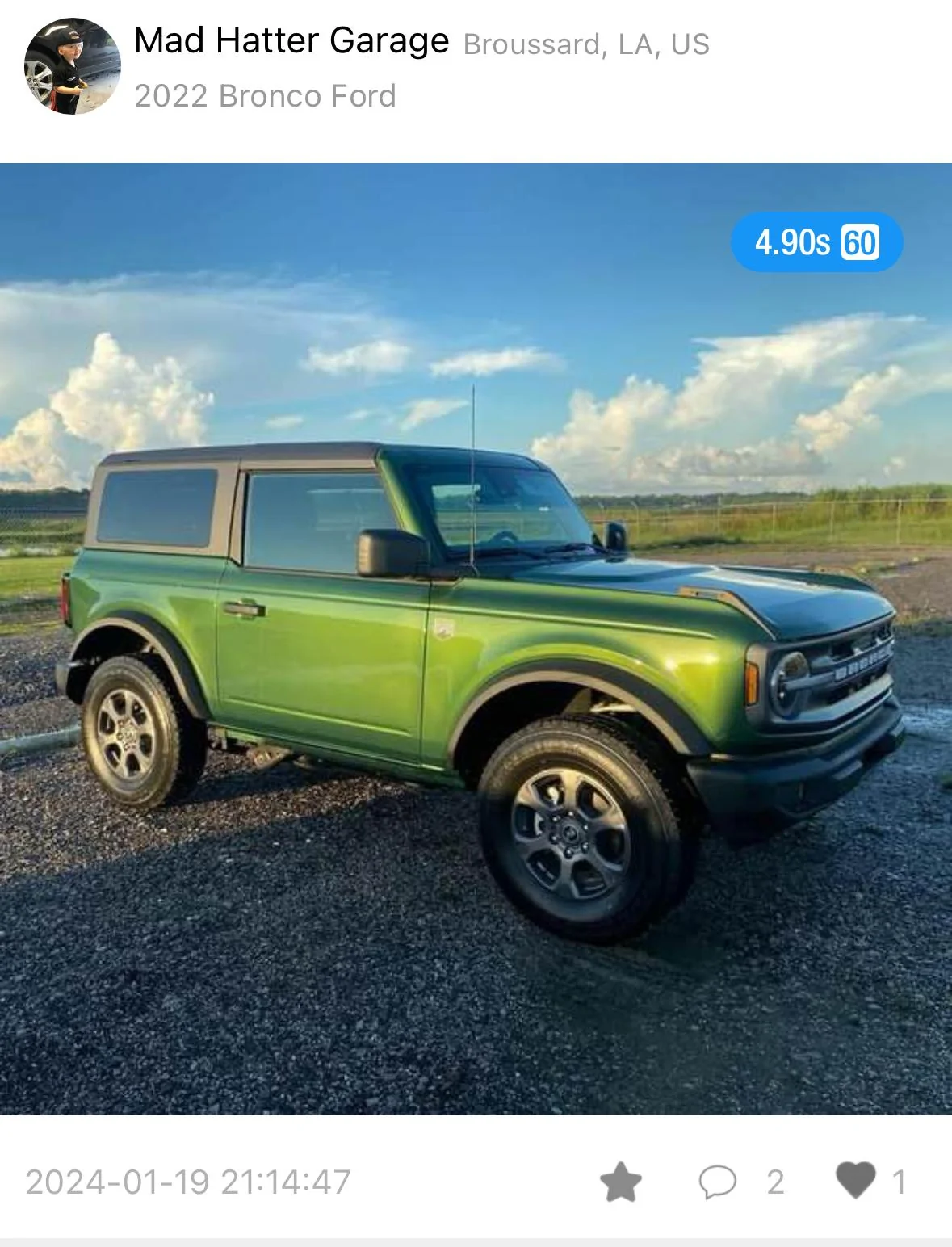

Mad Hatter Garage has a 2DR 2.3L Big Bend running under 5s 0-60. It has a Roush Intake, JB4, and running E30. This little Bronco is a rocket 🚀
Also, there’s a video showing him doing 4.82s 0-60 and 13.4s in the 1/4 mile. The results are not officially uploaded, so I’m sure 100% sure they’re valid. Still, it’s impressive as hell.

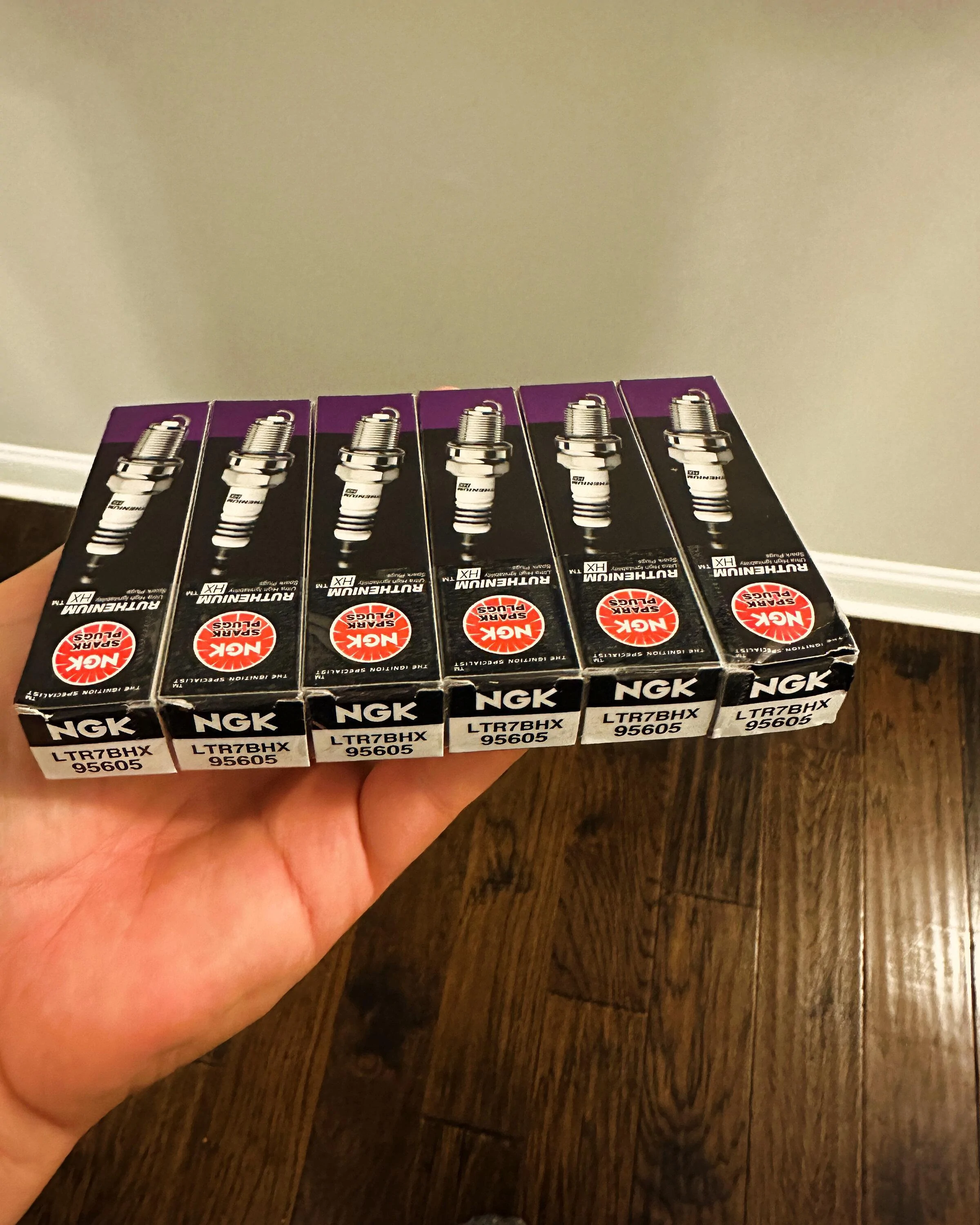

Hmmm…The guys at ZFG say to not use those plugs, but I’m taking their word for it. Might not be as big of a deal since yours are gapped to 0.26 - Anyway, these guys tune the fastest Explorer STs on the planet. A few do 10s in the 1/4 mile.
From ZFG:
Spark plugs.
There is a load of misinformation floating around about spark plugs. 6510s (LTR7IX-11) are not the spark plug to use in your EcoBoost. I get it, other tuners recommend them, but they are not right for the application. Do they work? Yes, they do, but this is what happens. Plugs will go in gapped at .031. After a few thousand miles you will start getting some spark blow out. Then you will pull the plugs and find out the gap opened up to .038 or some other large number! This will happen every time, the cylinder pressure and firing temperature of the Ecoboost is just way to hot and will cause the strap to open up towards its original position! Some people are doing plugs after 5-10k miles because they are "bad". That's not the issue. The plug isn't bad at all the gap is just wrong. 6510s come out of the box gapped at .044 even and even NGK tells you not to re-gap them more than .010 whereas most Ecoboost applications need to be gapped at .028 max.​
The following options are what we at ZFG Racing recommend in order the order that we prefer.​
NGK 95605​
NGK 95822​
Bosch 96315​
https://www.explorerst.org/threads/...ing-performance-on-explorer-st-platform.6610/
Not relevant to the discussion... but I was super relieved when I looked up the plugs I ordered from SPD performance and they appear to be NGK 95605!

Nice! Mine were just delivered. Gapped to .028.
Looking forward to seeing how they do with the extra boost.
