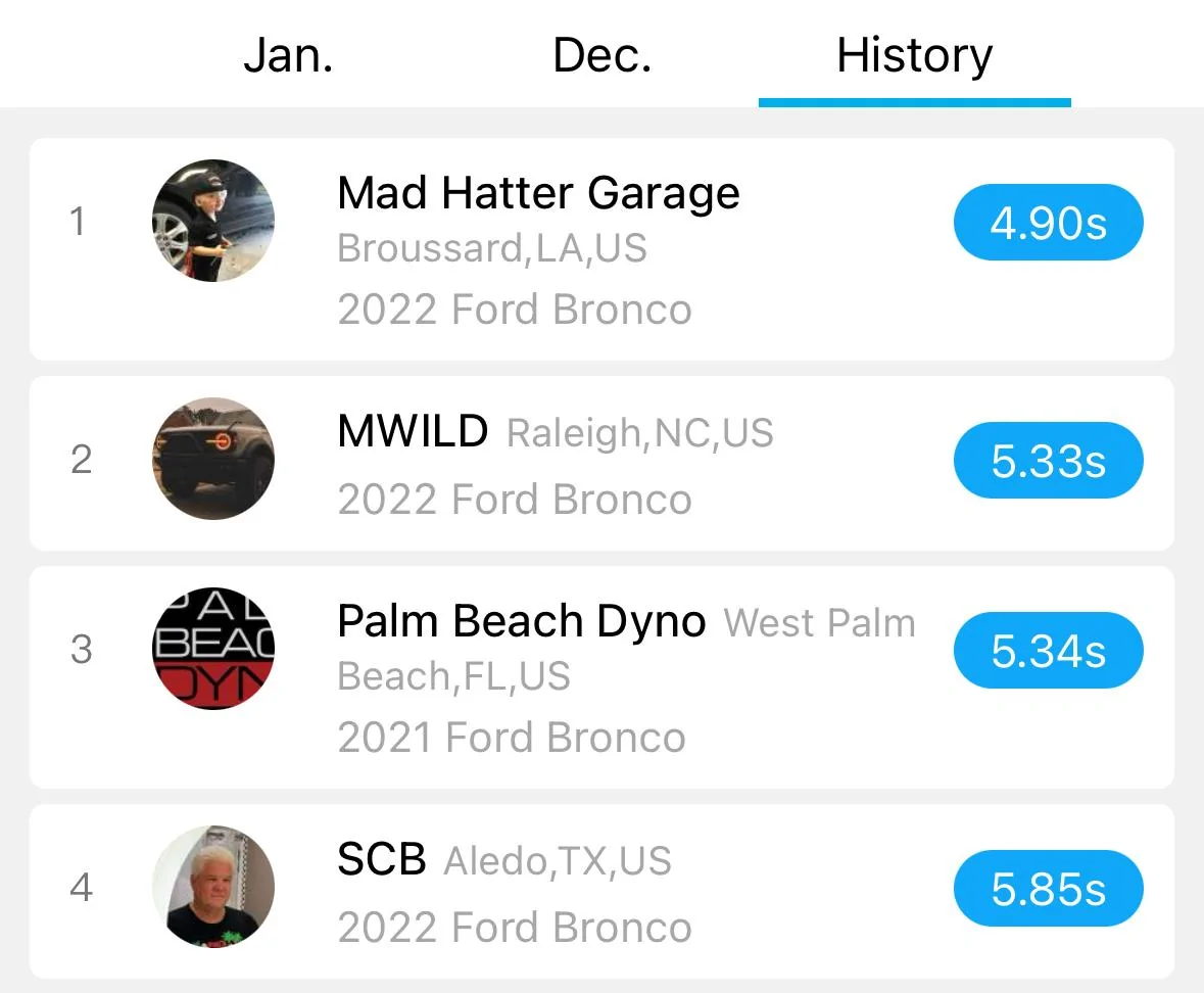

They were able to achieve 0-60 in 5.34s. This was in a 2021 WT with the top, spare and doors removed + JB4 @ Map 4 with E30 + Exhaust

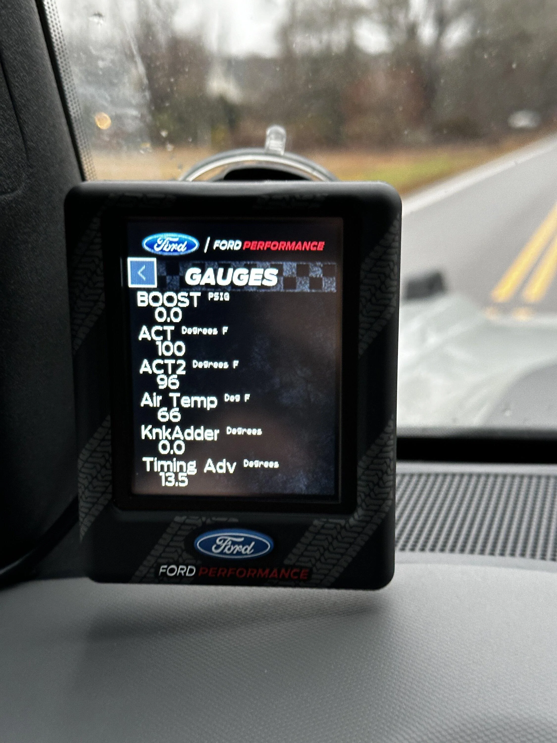

Wanted to post this since it took me a little bit to figure out. If you want to monitor PID IAT and IAT2 with the Ford ProCal 4, then you need to look at ACT and ACT2. They are that same thing, just a PID that Ford uses. This will come in handy when I install the CVF Intercooler this weekend.
IAT/ACT = Air temps before Intercooler
IAT2/ACT2 = Air temps after the Intercooler

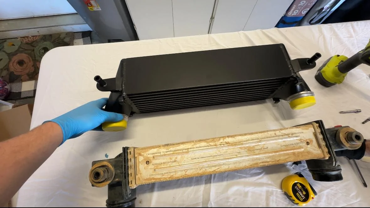

Big thanks to @RubyRedGT for helping to install the CVF intercooler today. We took a lot of video, so I plan to make a detailed Install video to post on my YouTube Channel. I’ll have some before and after when it comes to ACTs.

ā€œOfficiallyā€œ beat Palm Beach Dyno 0-60
I'm SCB on this list. I need to practice launching the truck. I feel like there are a few tenths I'm leaving on the table.
