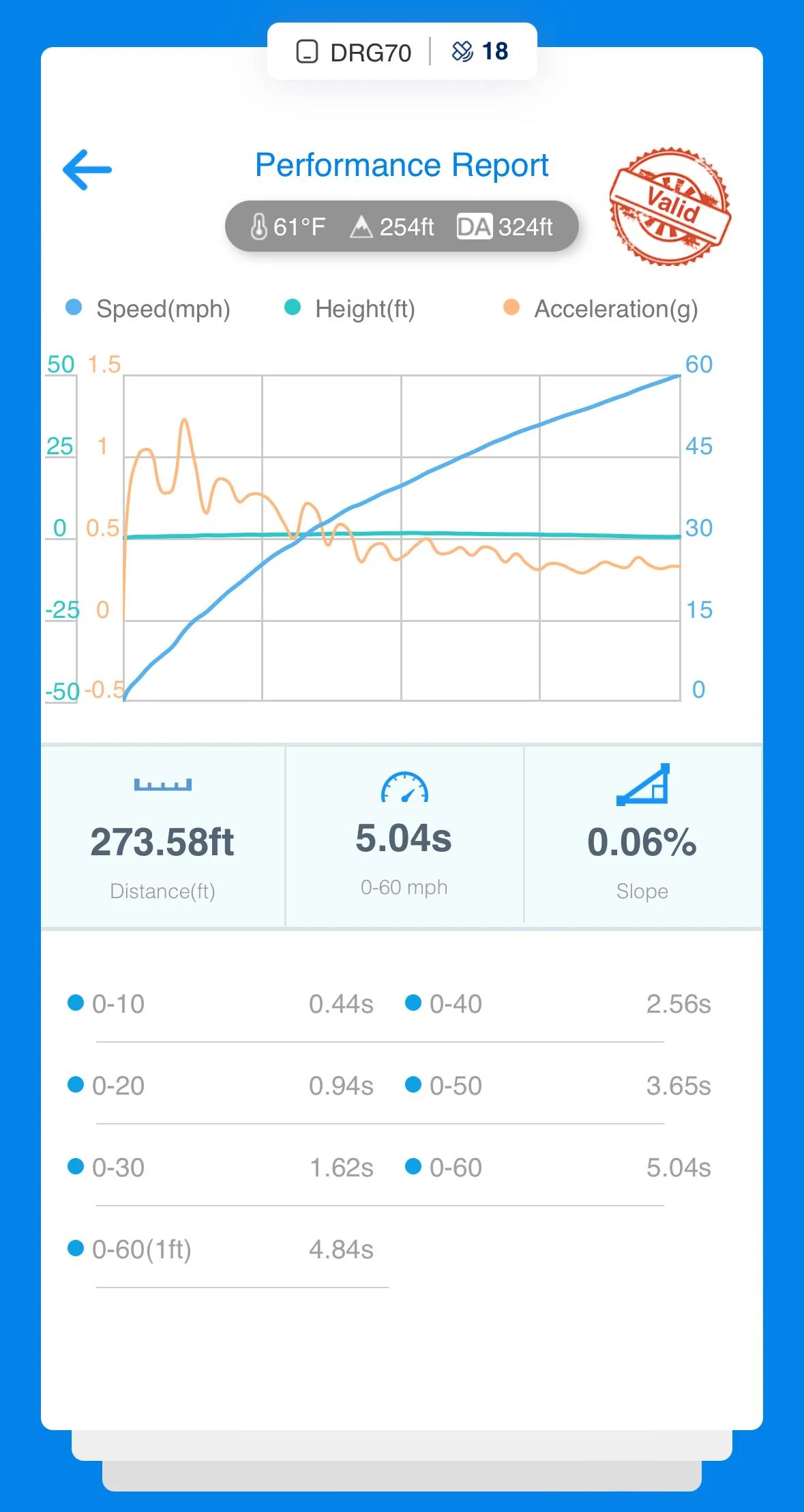

Running 93 Octane + Ford ProCal tune & the Pulsar XT set to level 5 I ran the 0-60 time below.
The best run I had was 5.04s, but I experienced wheel hop.

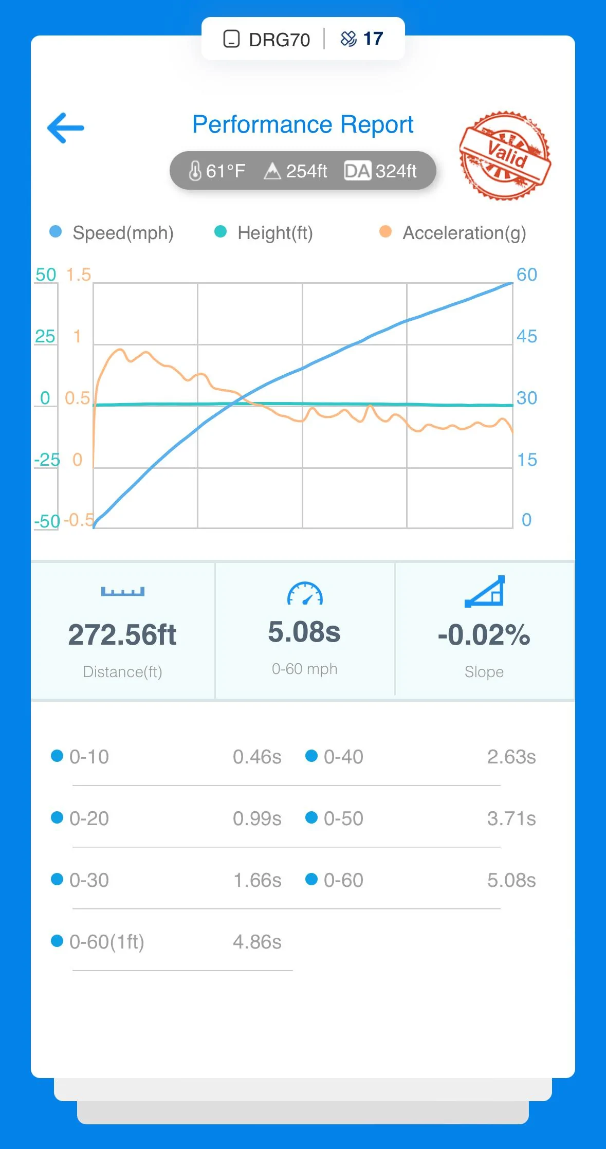

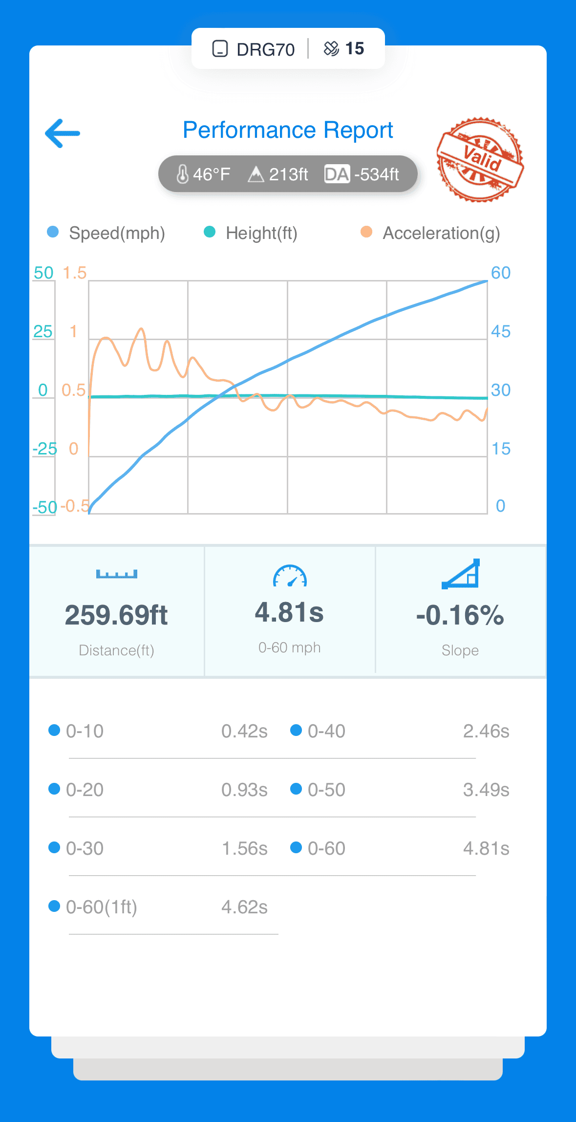

Same setup as above, but with a mix of E30 fuel.
4.8 Seconds! Crazy for a five thousand pound shoe box on 35's :) This is a bit faster compared to the RaceChip S that I was using on setting 5.

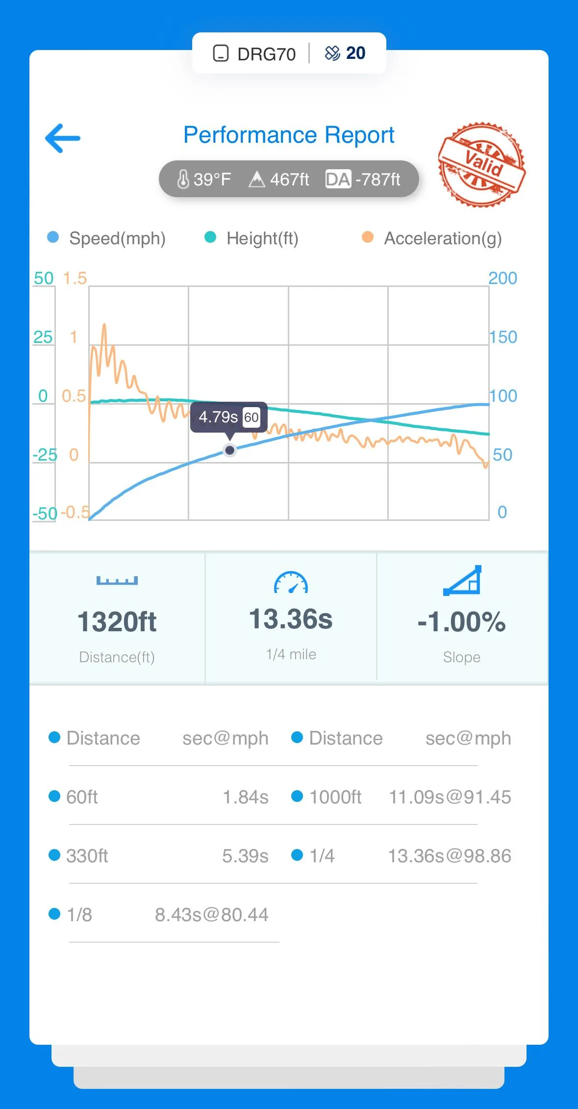

Man the cold weather does amazing things…
New best for 0-60, 1/8 mile and 1/4 mile.
Custom turning coming soon…shall we go for the 12’s?
Holy moly a ripper!!

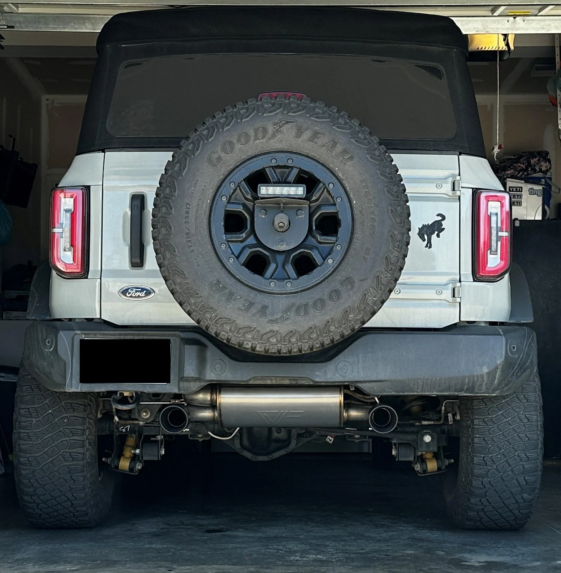

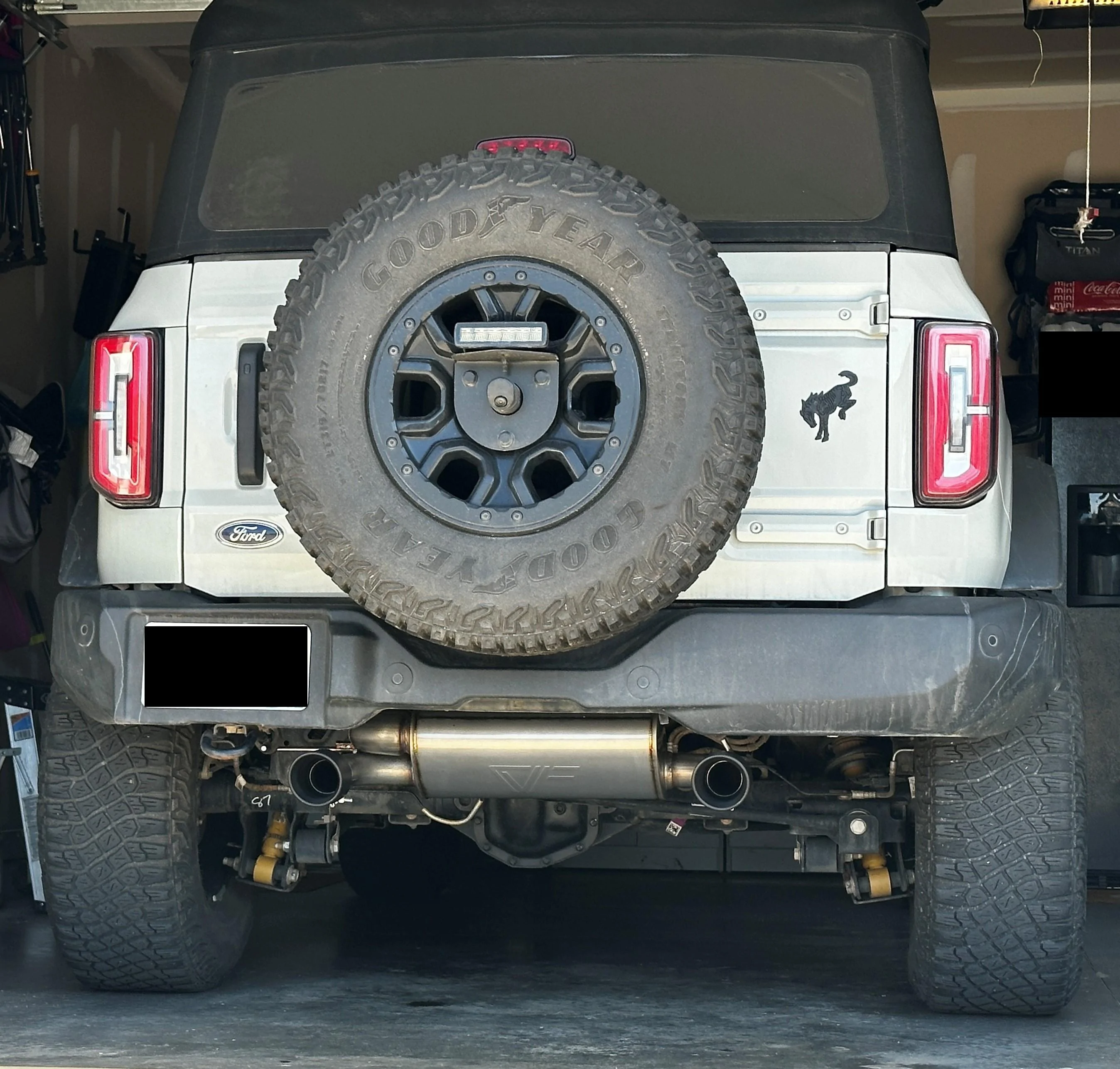

New 3" CV Fabrications catback exhaust installed. I'm digging it thus far. Has a deep tone that's not annoying and doesn't have any drone. Bronco also feels like it has more HP/TQ and gets up to speed faster during normal acceleration. Sounds good at WOT :) I'm impressed

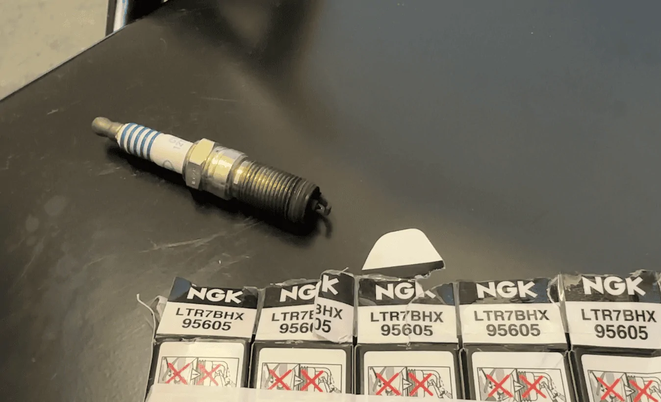

Here's some pics of the stock plugs I removed. These only have 26K on them.

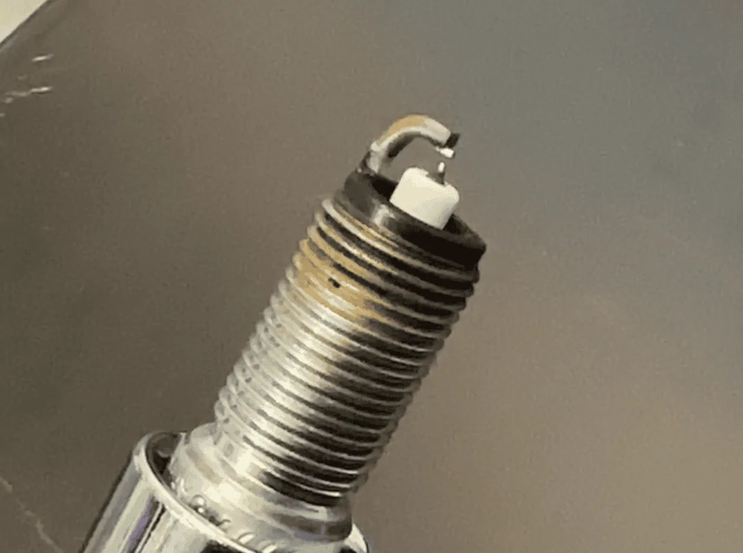

Pulled one of the new plugs out after a 100 miles or so. While the plug base ring shows signs of running rich the white insulator shows no signs of preignition/detonation. The ground strap shows the discoloration at the half way point, so the heat range appears to be good.
I will say, the Bronco idles smoother and she's running better than ever. Going to replace the Front & Rear diff oil this weekend and then see what she can do with E30. Pulsar XT testing is next :)
Don't boosted engines tend to run rich as a cooling factor? That doesn't look absurdly rich. Keep up the good work. I'm learning a bunch.
Yes they do, especially Ecoboost motors, so this is actually pretty normal.
