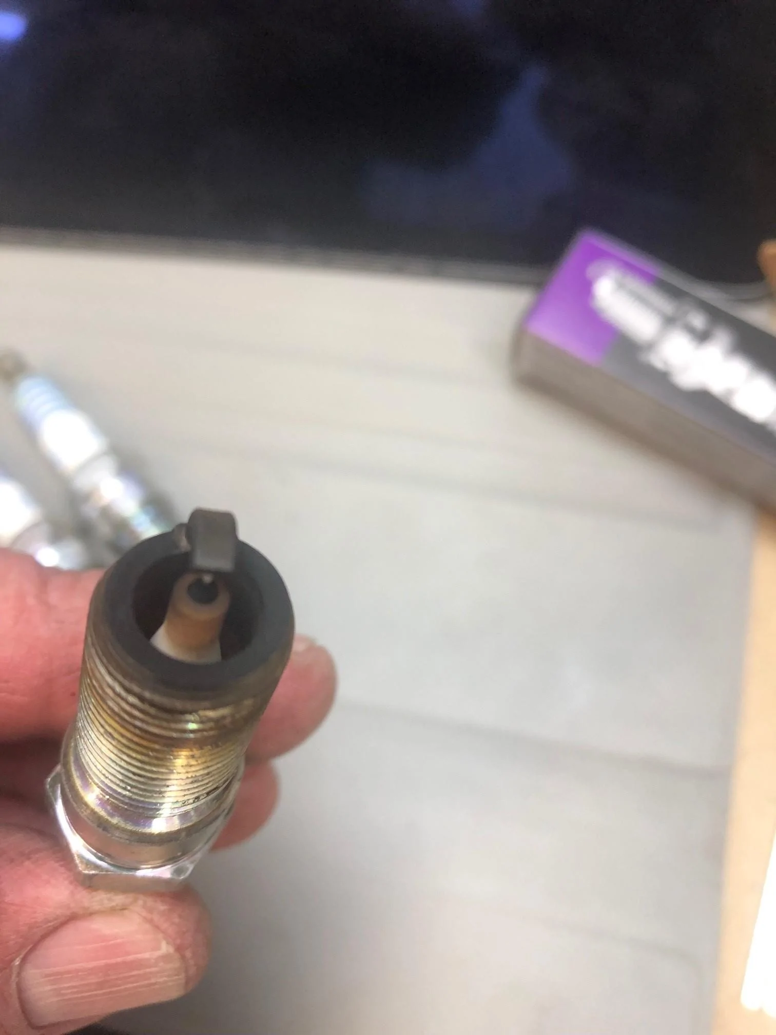

Here's some pics of the stock plugs I removed. These only have 26K on them.
Ford Bronco 0-60 in 4 Seconds - My 2.7 Bronco Performance Modification Thread 1706845781275
Ford Bronco 0-60 in 4 Seconds - My 2.7 Bronco Performance Modification Thread 1706845989304
Pulled one of the new plugs out after a 100 miles or so. While the plug base ring shows signs of running rich the white insulator shows no signs of preignition/detonation. The ground strap shows the discoloration at the half way point, so the heat range appears to be good.

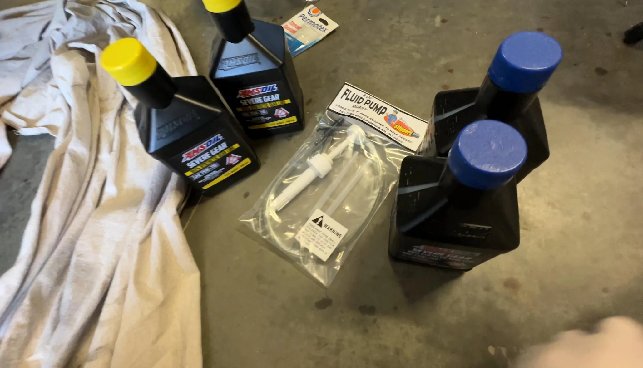

I will say, the Bronco idles smoother and she's running better than ever. Going to replace the Front & Rear diff oil this weekend and then see what she can do with E30. Pulsar XT testing is next :)

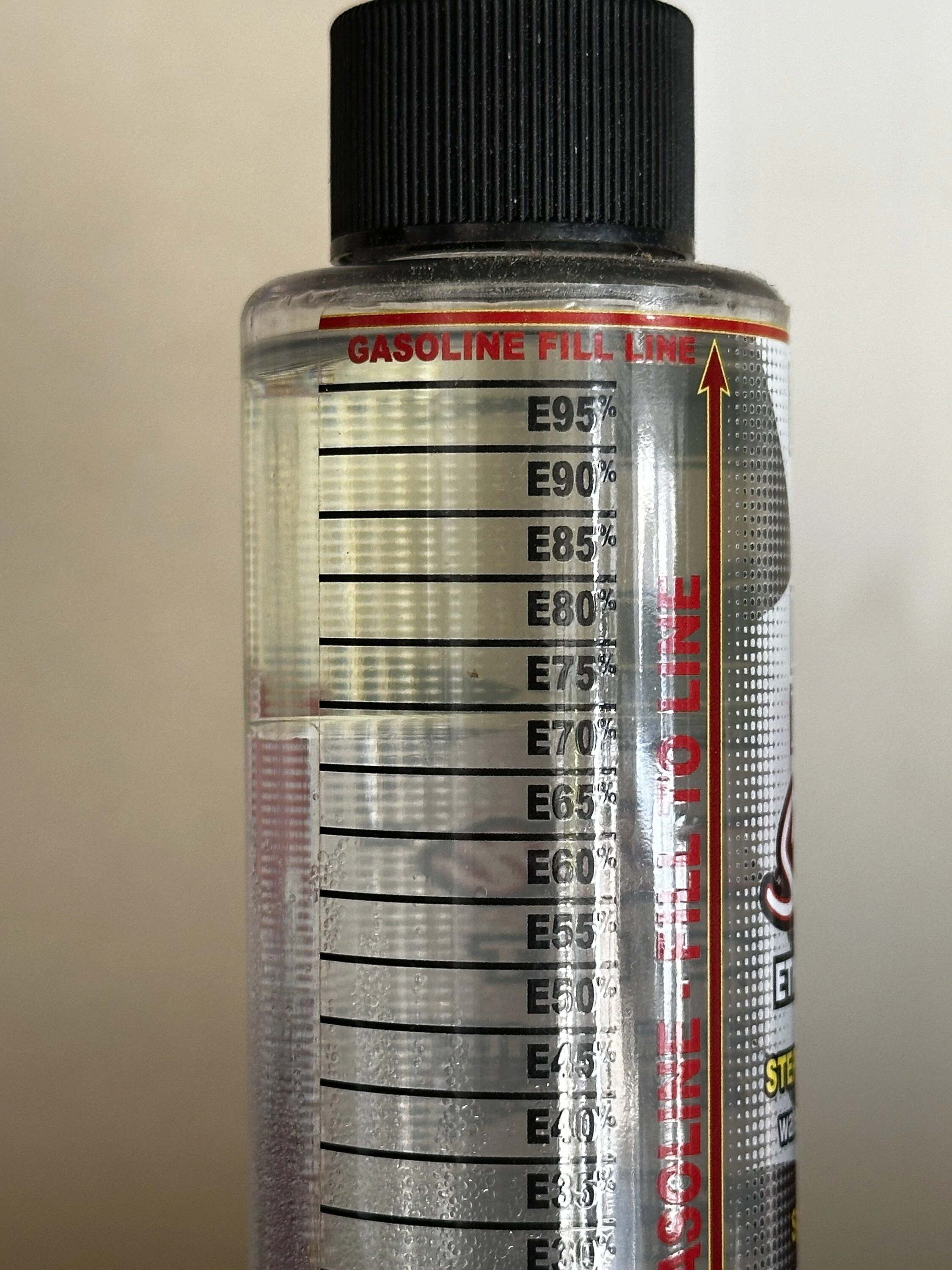

Ethanol testing kit. E content looking about the same as it always does at my local Sheetz. Went ahead and filled her up with E30.

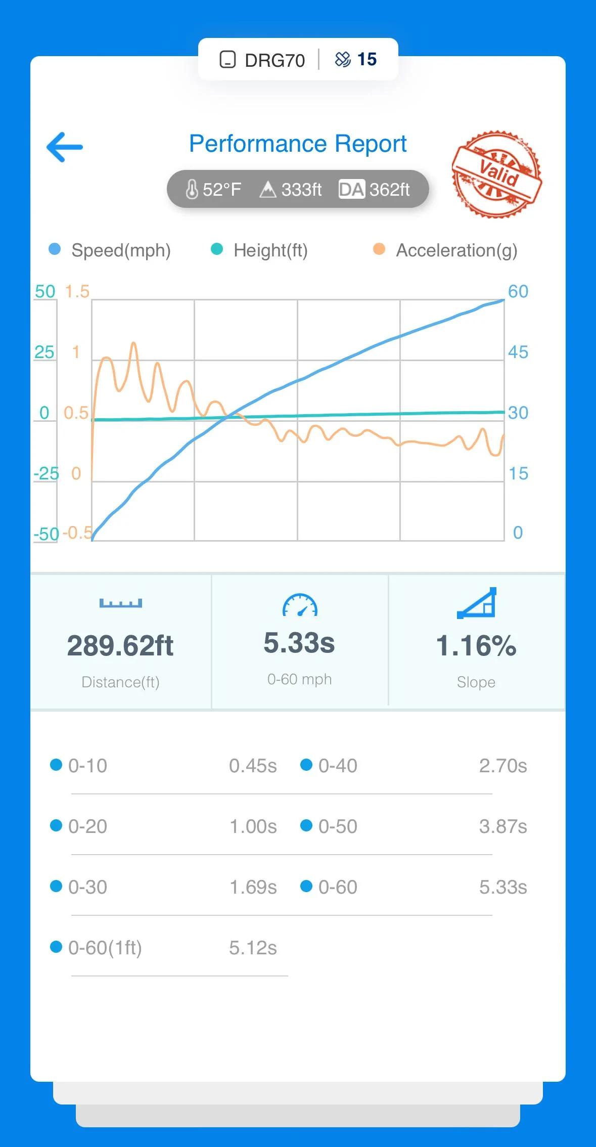

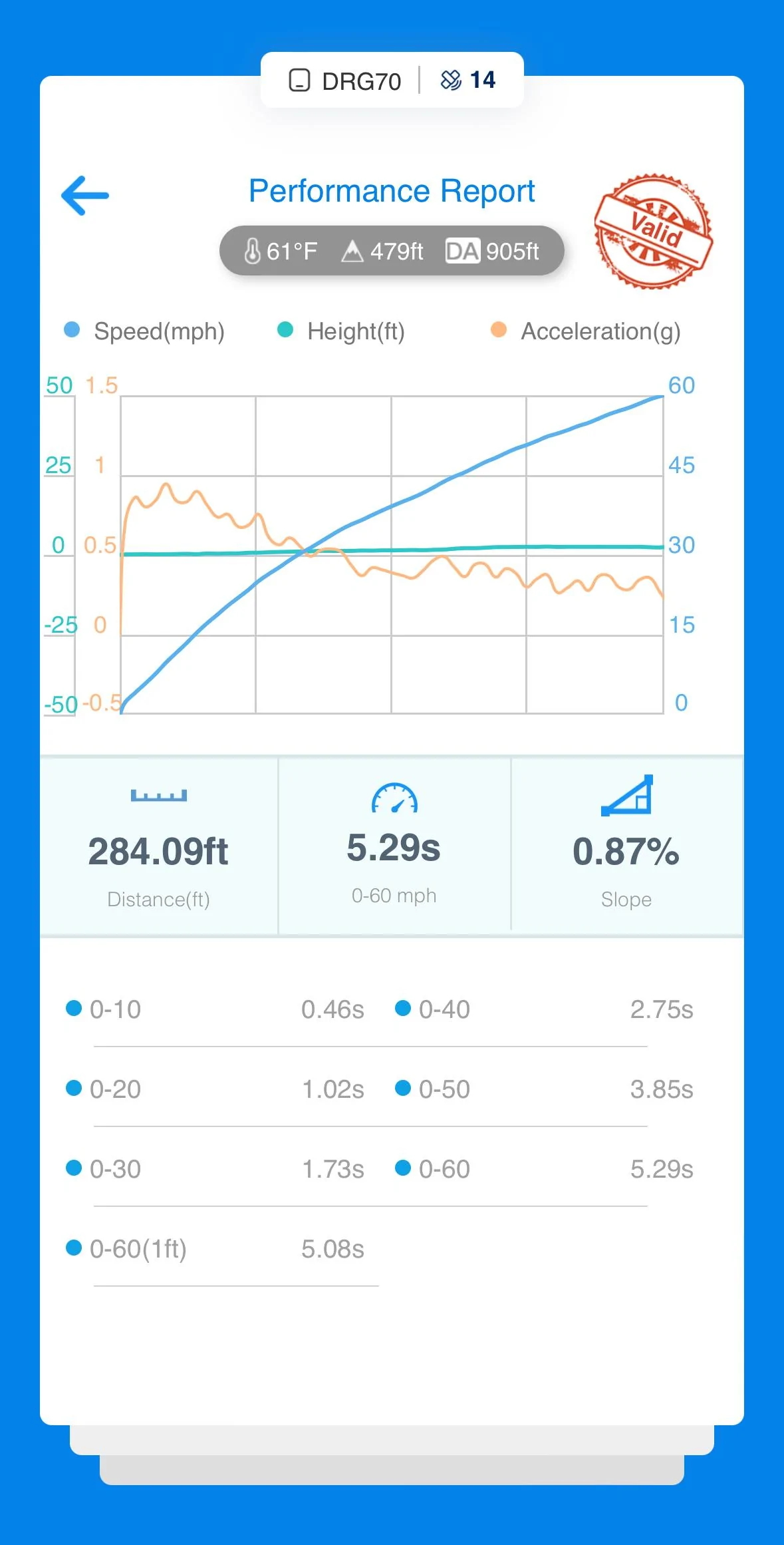

Did a very mild launch today and already bested my current 0-60. If you compare the acceleration (G) line to my previous run. Much milder, though there was no wheelspin so that's good thing. Still think she has more in her with this setup and E30.
Plan to do more testing this weekend.
Ford Bronco 0-60 in 4 Seconds - My 2.7 Bronco Performance Modification Thread IMG_0860
Ford Bronco 0-60 in 4 Seconds - My 2.7 Bronco Performance Modification Thread IMG_0863
I’m also noticing that she’s pulling harder in normal mode vs. Sport. I’ll dig deeper into this and share my findings. I also forgot to mention, that I upgraded my Dragy device to the DRG70. No real difference, but wanted the the better battery life.

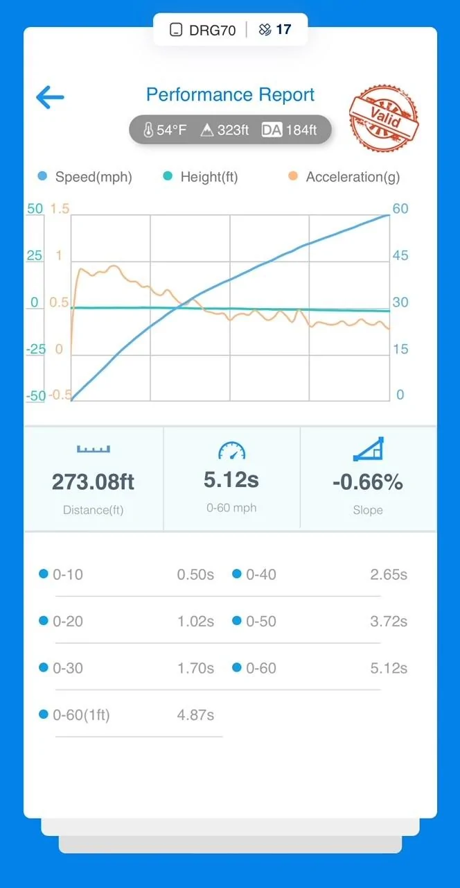

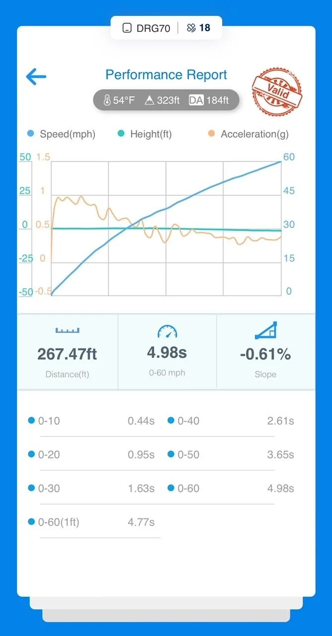

So I made an interesting discovery about the Bronco modes when doing performance runs. As it turns out, my Bronco feels faster in "Normal" mode. Faster than sport mode. I put this to the test and did two back to back runs, on the same stretch of road. I also launched them at the same RPM (2.6K RPM) Sport mode not only didn't feel as fast, but there was also more wheel hop. Here's the numbers below to prove it.
The left screenshot is in Sport mode and the right is normal.
Ford Bronco 0-60 in 4 Seconds - My 2.7 Bronco Performance Modification Thread 5.12
Ford Bronco 0-60 in 4 Seconds - My 2.7 Bronco Performance Modification Thread 4.98 2
As mentioned, even around town driving feels faster in normal mode. I suspect it has to do with how the RaceChip set to level 5 interacts with sport mode while also allowing for a more aggressive launch. In normal mode, I don't get any or much wheel hop. She hooks and goes. Wondering if I could have shaved off a tenth or so off my time...this whole time :)

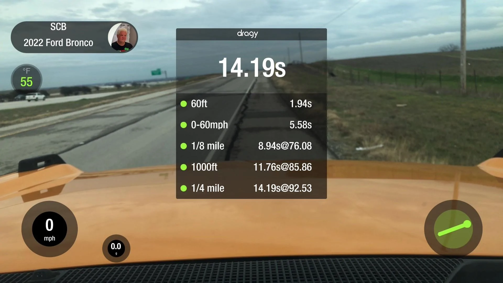

Took MWILD's advice and swapped out the plugs. This is with 23k on them.
There was a difference with the new plugs. Runs smoother and maybe a little quicker.

Same ones as you, See pic. I'm still working on my launch procedures. Thank you for your willingness to share your journey.
