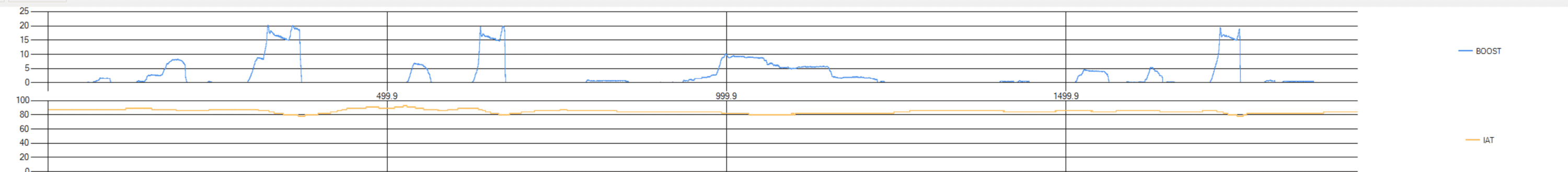

No issues with IATs or boost. Three back to back full throttle runs at HWY speeds. IATs look good when on the HWY, but drift up to 110-115f when in stop and go traffic. It's in the 50's here, but in the summer I can only imagine how high they will get.
Ford Bronco 0-60 in 4 Seconds - My 2.7 Bronco Performance Modification Thread Screenshot 2024-01-11 170559
Also checked Coolant, Oil, and Trans temps and there all within range (under 200f)
More logging to do, but it appears everything is functioning well. Seeing close to +2 PSI of boost with the Ford performance tune. Hoping the Racechip on setting 5 gives me another 2-3 PSI. Going to be hard to measure that since it's a piggyback solution.
