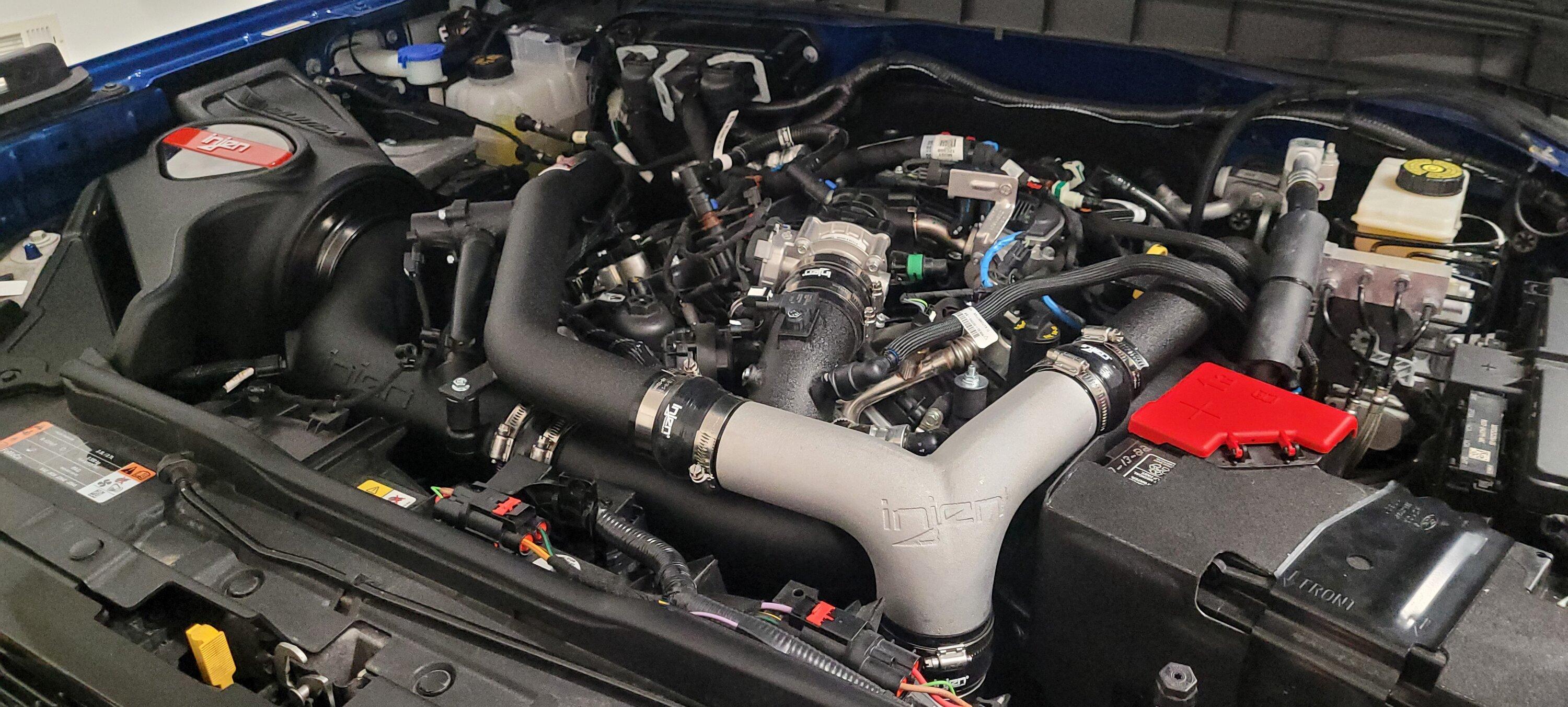

@MWILD : Great to see you doing the mods! I am right there with you, I have the Injen CAI, Turbosmart BOV, Magnaflow Exhaust, FP Tune, and I will receive my Injen charge pipes this week. I have not done any draggy testing or such, but I know the power has changed. A lot. In sport mode, I embarrassed a Doge truck off the line. Yes, I know it's not a drag racer, (I have a 68GTA and a 21 Shelby for that) but sometimes you have to put those Mopar boys in their place! Plus it's Miami! Fast and Furious is our way of life.
What makes the Injen CAI great is the less restrictive piping, and also the fact it goes that way all the way to the turbos, unlike other kits. I do look forward to doing my charge pipes, it will be interesting to see what I pick up. I am trying to get a dyno pull for before and after, I will see if I can make that happen this week.
Why??? Why you say, because, well, we can! I enjoy tinkering. I enjoy modding. Nothing I own is stock. Yes, yes, I am well past the street racing thing, I am not doing it for that. But I am doing it for the pure pleasure of driving. Having my Bronco perform on the street and off-road is a wonderful thing. Also what others have said, the 1 pedal drive is wonderful for when I hit the trail.
So @MWILD, I will try to post what I get here in this wonderful thread you started, and yeah, for the love of modding and driving, its a great thread!

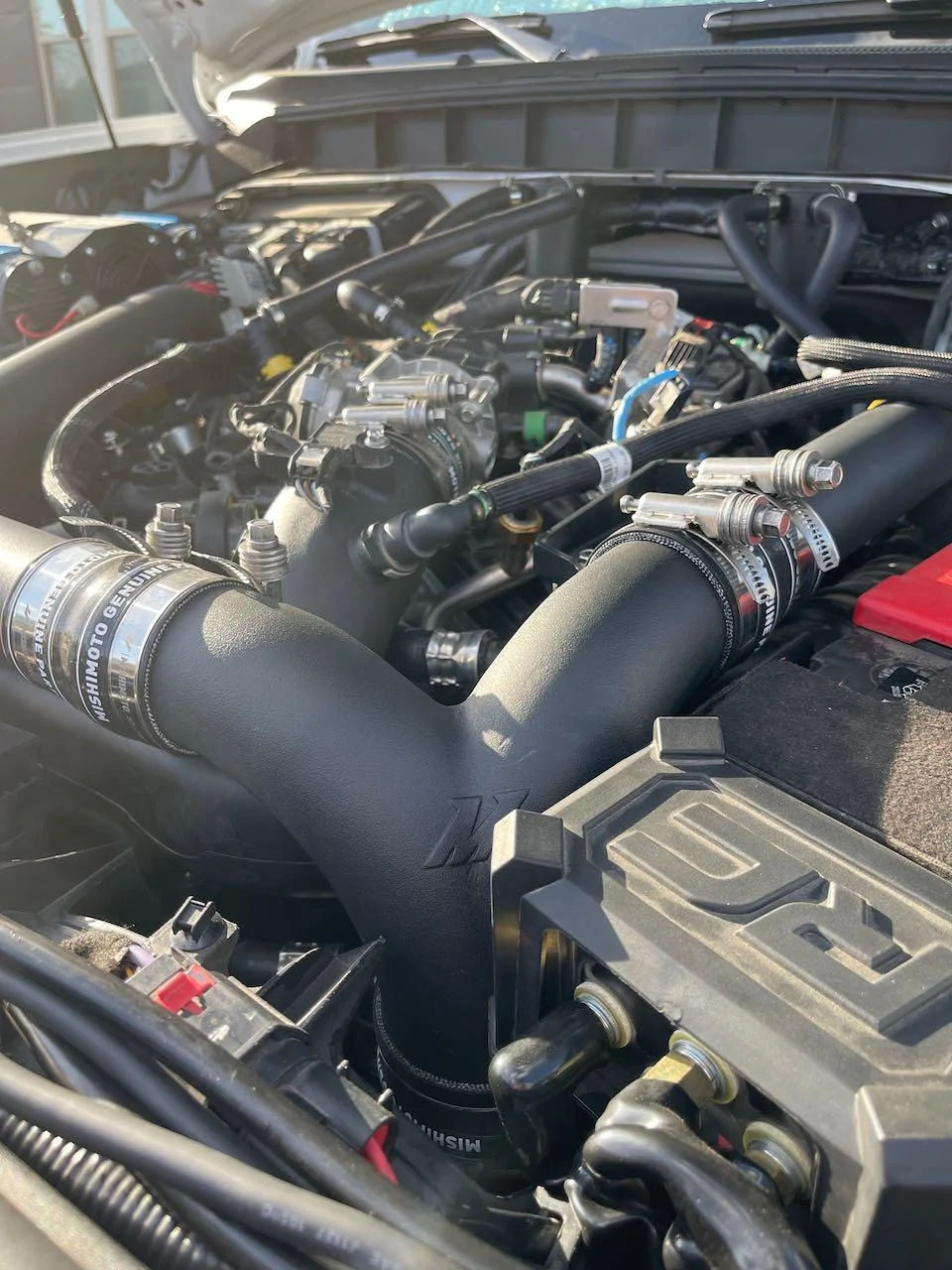

i added the injen cold air intake and the hot and cold pipes with a cpe intercooler over the weekend install was not bad figured doing it all at once is the best bet also have the ford performance tune which by the way is worth it just for the transmission adjustments that it made as for the rest not really sure that the bang is worth the bucks would really want to see some numbers on it from someone who has access to a dyno just my 2 cents
Hoping to have my Injen pipes tomorrow. I'll get them installed over the weekend. Still waiting to see what Injen offers for the intercooler. That looks good! I would be interested to know what numbers you are getting now. I'm trying to set up a dyno session.
