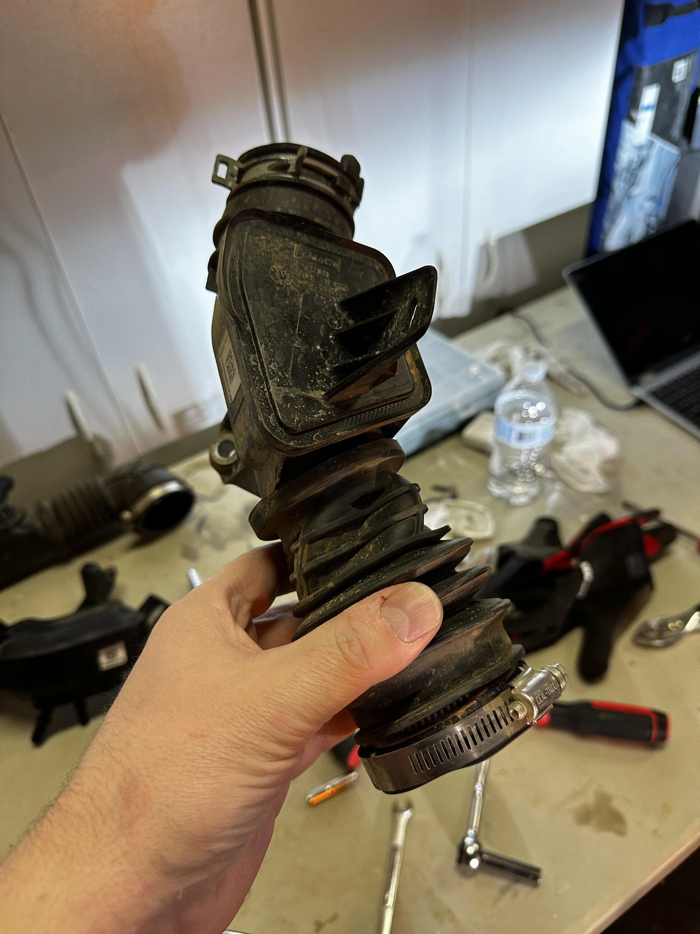

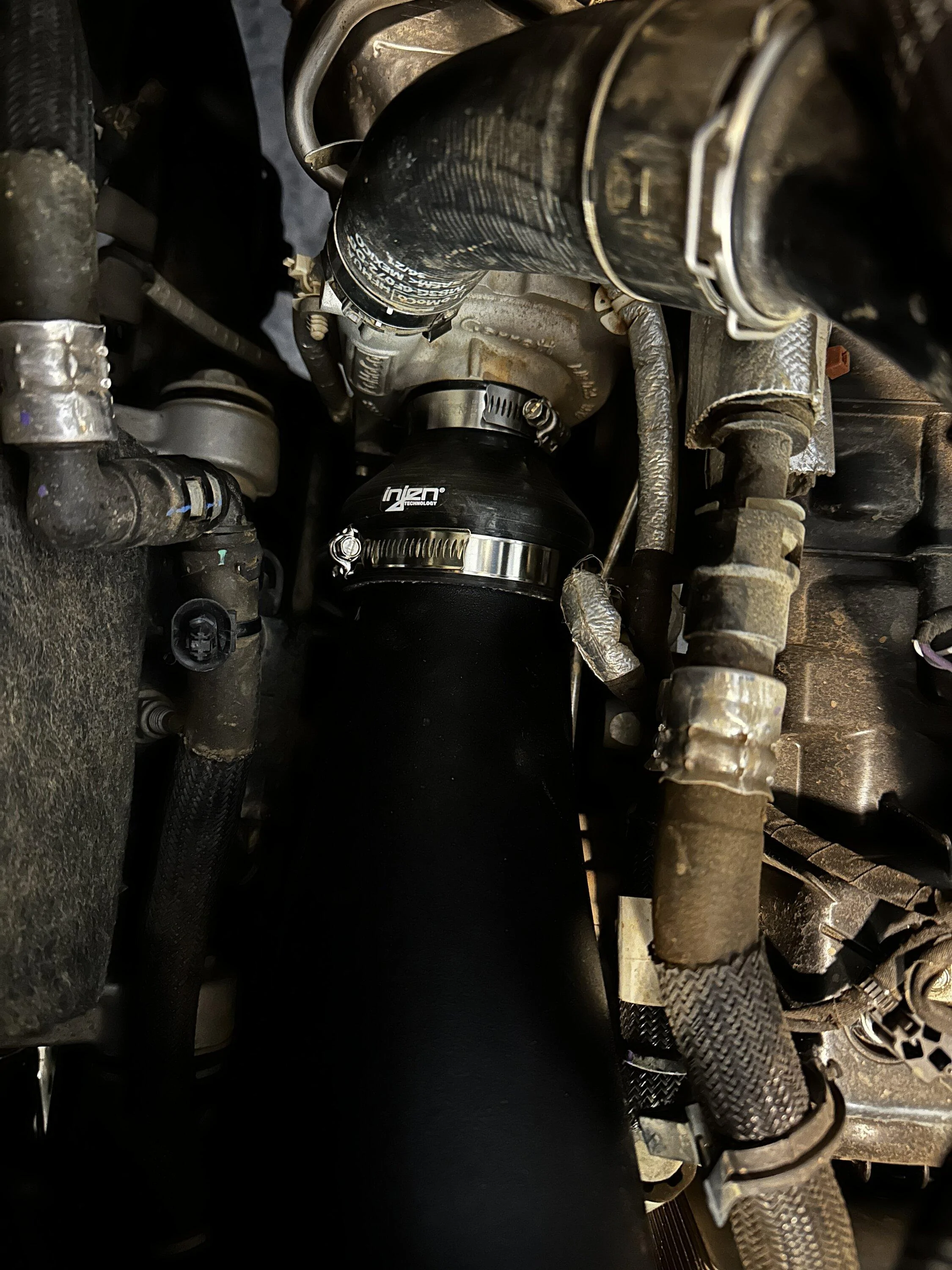

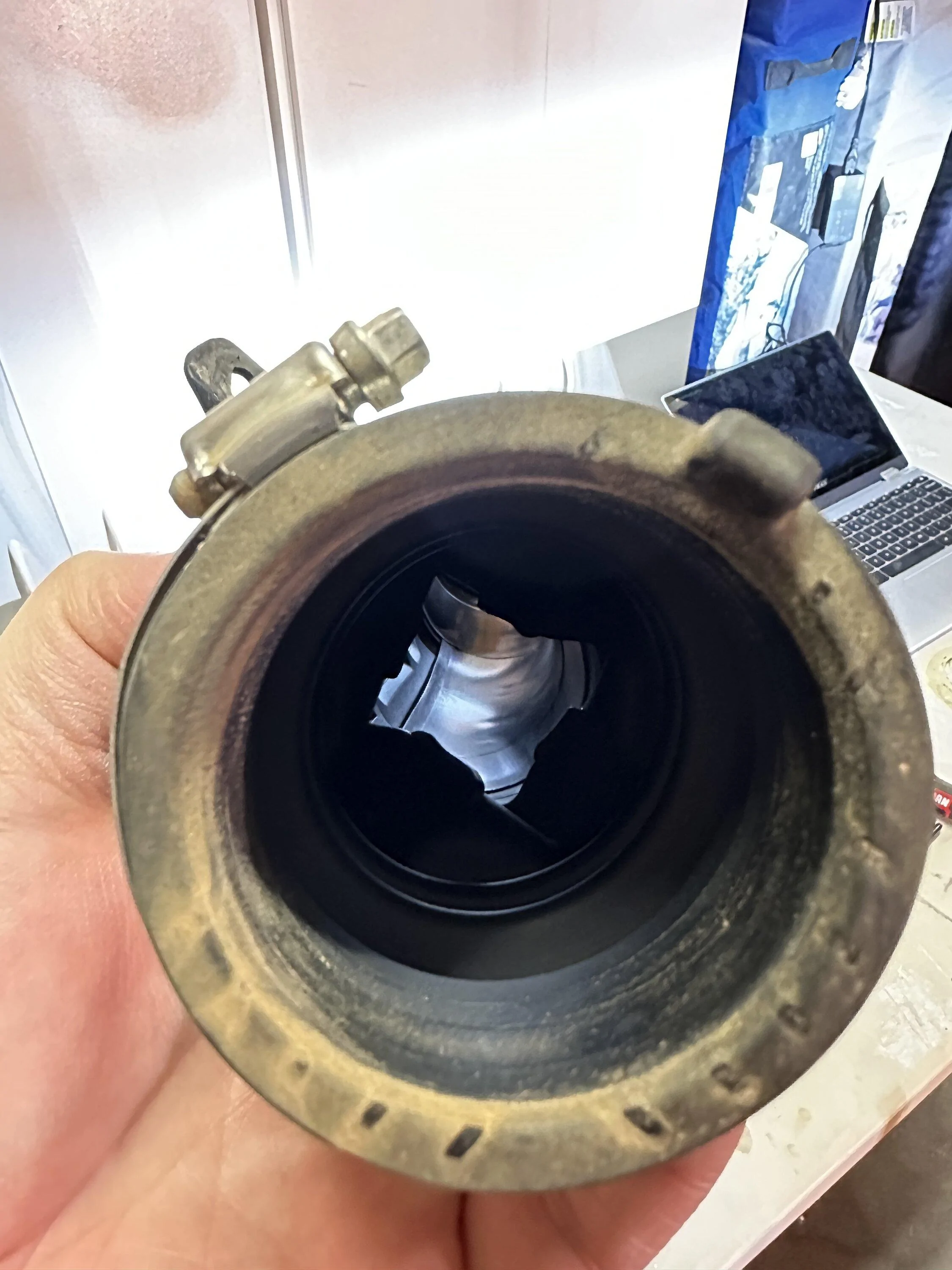

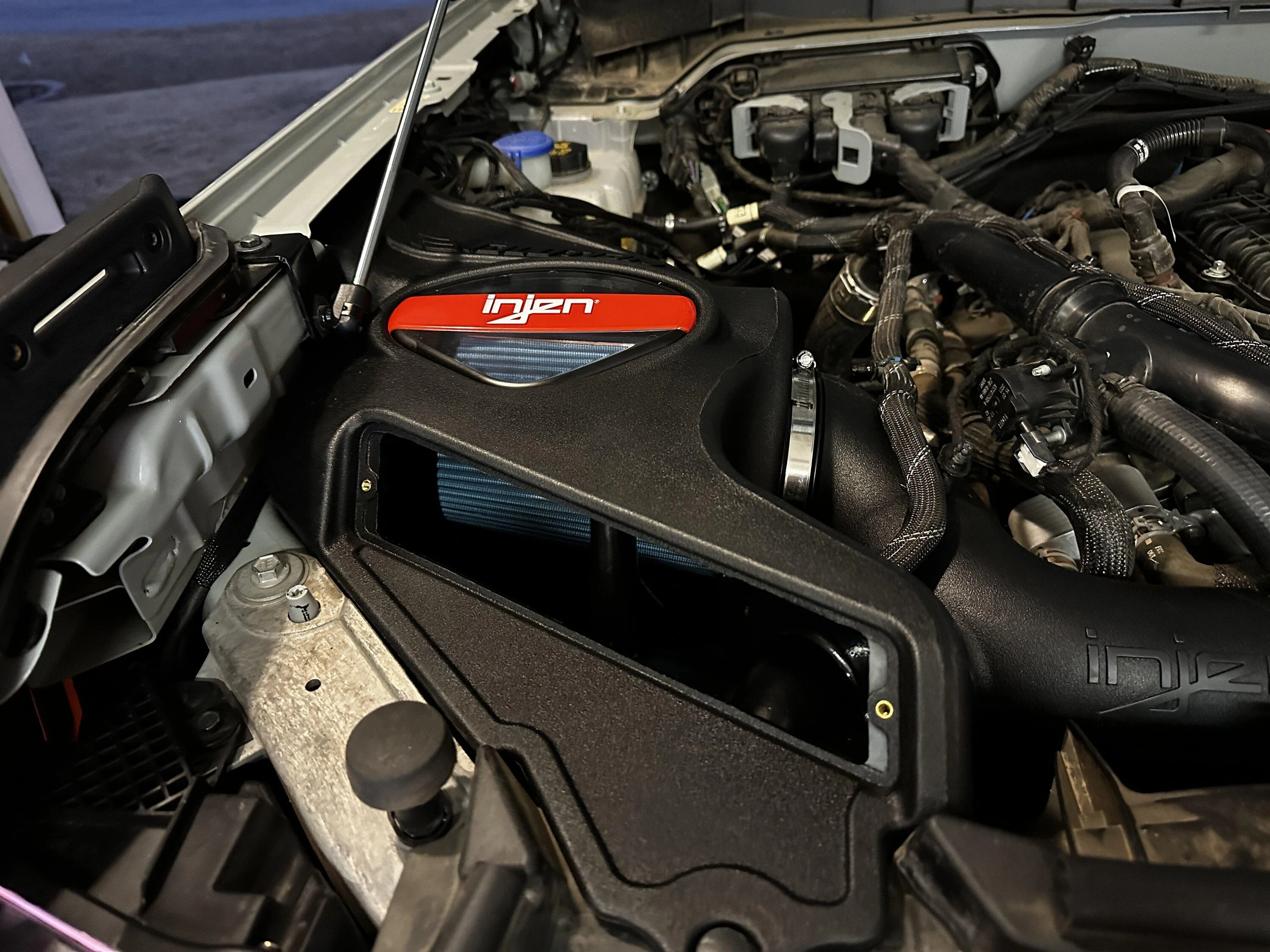

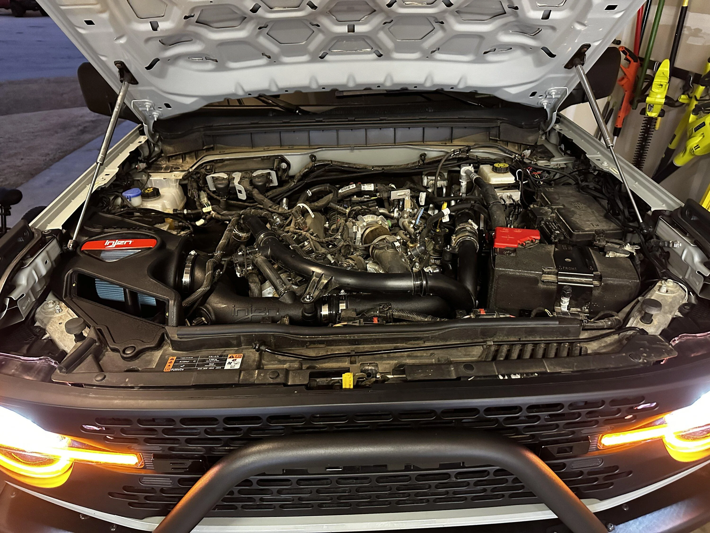

Injen cold air Intake installed. Haven’t logged any runs yet as I need to put some miles on her. Wouldn't say it was a "fun" install, but not too bad. I got this CAI scratch & dent/open box on eBay $269. Has some scratches here and there, but works great :cool:
The intake sounds really good. Lots of turbo whistling and you can hear the BOV as well. Subjectively it pulls harder vs. the S&B drop-In filter, but the data will confirm.
So nice to see this highly restrictive elbow gone.
I'm hoping someone makes a replacement for this elbow that is sold either on it's own or with a high flow filter. I watched a video of the airbox replacement an it looked to me like much of the improvement could probably be achieved with just a smooth flowing tube in place of that accordion hose.
So you're the one that got that intake off Ebay! I was messaging the seller to see if he had any pictures of the parts to make sure everything was there and next thing you know, the auction was ended!
Are those actual flaps sticking inside that passenger side elbow? It looks like they are intentional to reduce noise or something. Is there anything like that inside the driver's side elbow?
:) I asked the seller the same question. He said everything was there, but it was not. The box was missing the PCV removal tool, which is a vital for the install. I ordered one from Injen for $15 shipped. I reached out to the eBay seller and they refunded me the same amount, so it all worked out in the end. Just took me another week to do the install. You can now find them in the low $340 range, so probably wasn't worth the trouble to save a few bucks.
Yes, those are flaps. I'm not sure of the purpose, but might be to reduce turbo noise like you mentioned. The drivers side elbow does not have the same flaps. It's pretty smooth in comparison.
