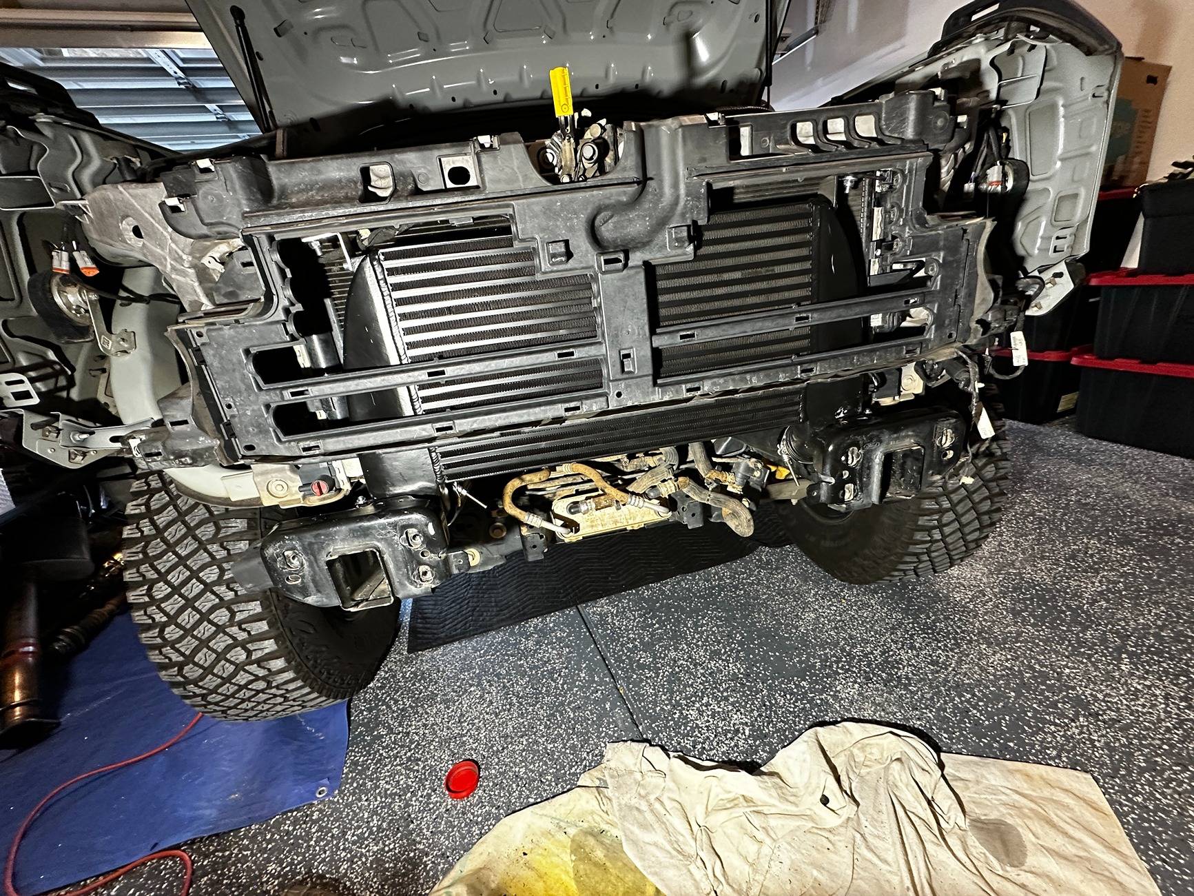

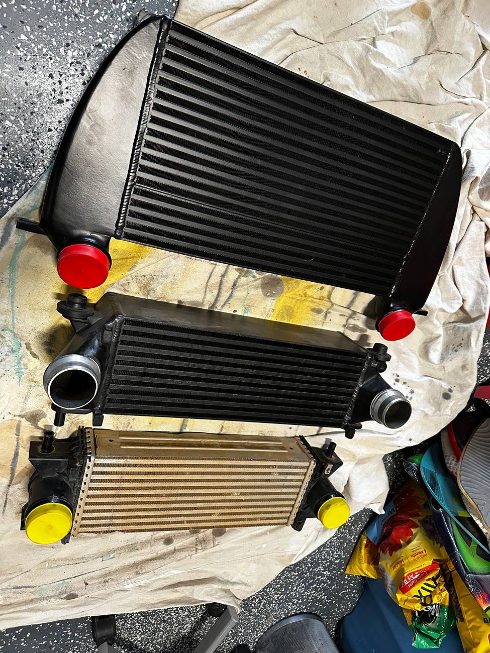

Working with CVF on a prototype high mount intercooler. It's very similar to the Wagner offering, but with the perks of it being CVF. Just installed it this past weekend, so haven't had much time to test it out, but it's got almost double the core volume as the stock FMIC. Unfortunately, it doesn't currently work with their charge pipes, so I plan to work with them on some adapters in the future. This one is definitely more work to install, but I recorded a ton of video and will have a step by step guide ready to go when it launches in the next few months. I'll post any updates on its performance here.

Yes, I saw @GI_Jo_Nathan post first and then stumbled upon yours as well. Both were extremely helpful. While the install took a lot more time compared to the drop-in FMIC, it wasn't hard by any means. I did have to trim quite a bit off the back of the shroud, but mostly around the center near the motor.

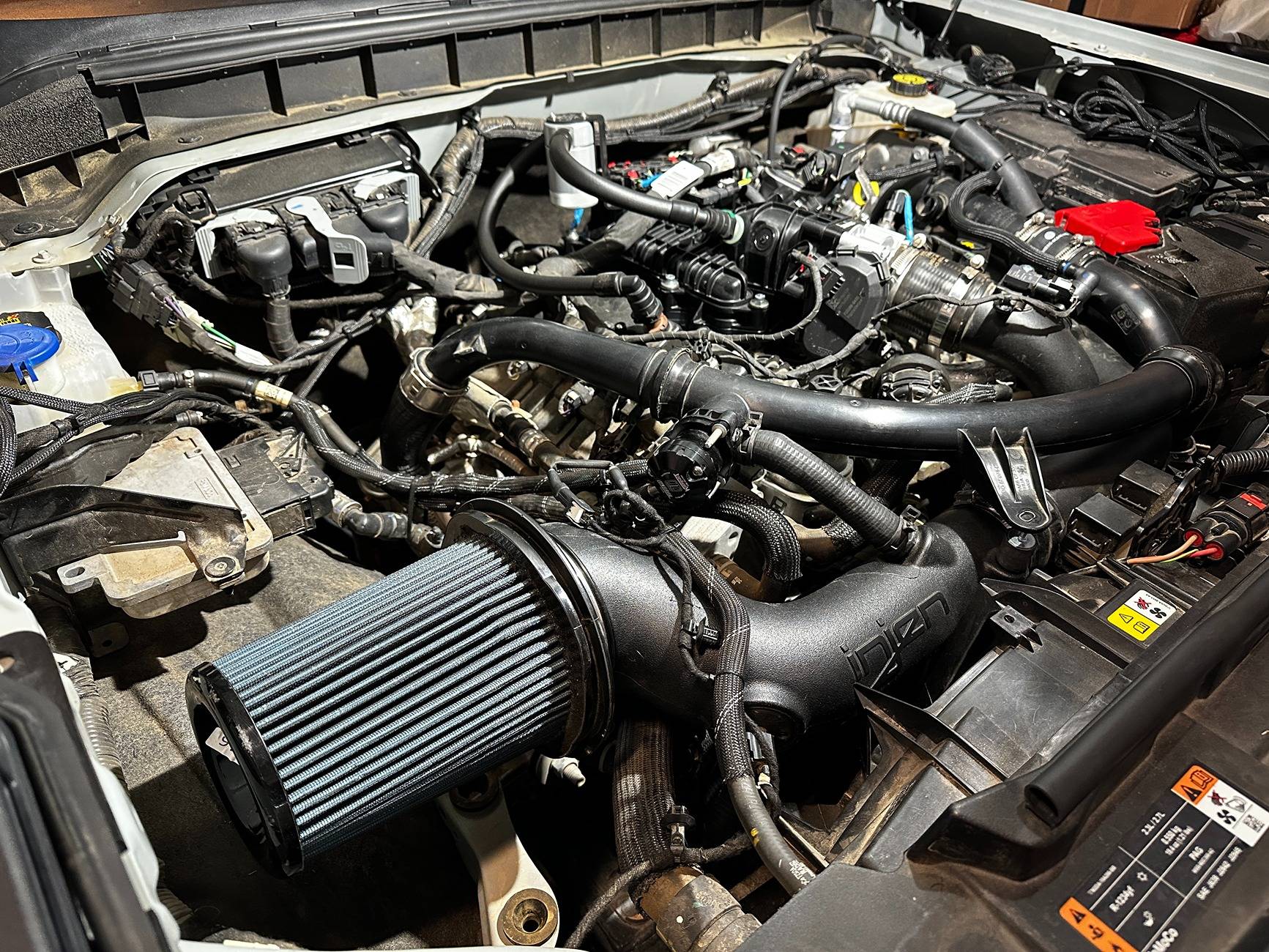

Do you run without the airbox all the time? I might give that a try.
I figured I’d give it a try since I had to remove it when swapping back to the stock charge pipes. It’s definitely louder and I’m sure during the hot summer months it won’t be ideal, but I’ll update the thread once I have more time with it.

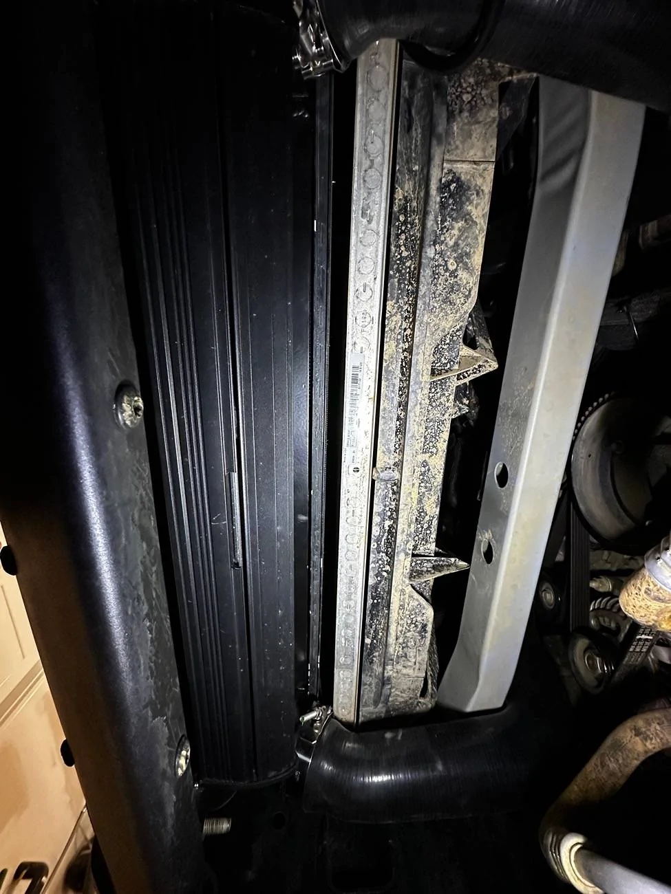

I believe he was asking more about the gap at the bottom of the radiator shroud that pulled air through the stock intercooler. When the stock intercooler is removed the gaping hole creates a bypass around the radiator, which may be an issue in warmer months.

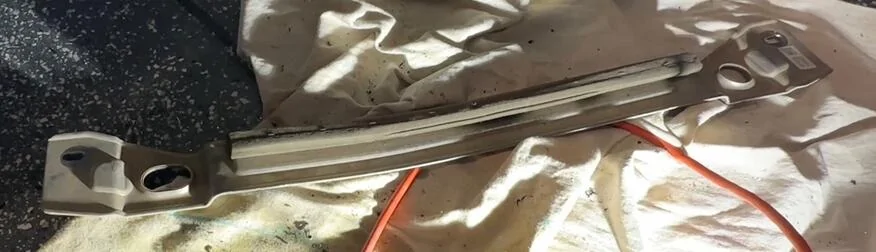

Ah, okay. I misunderstood the question. This is the bracket that has to be removed in order to install the High mount IC. It does contain a piece of foam that tucks up between the AC condenser and radiator. I figured since the radiator has a shroud on the top and both sides that would be enough, but if that's not the case then I'll have to look into a solution. I'll monitor my Coolants temps via the Procal. Thanks!

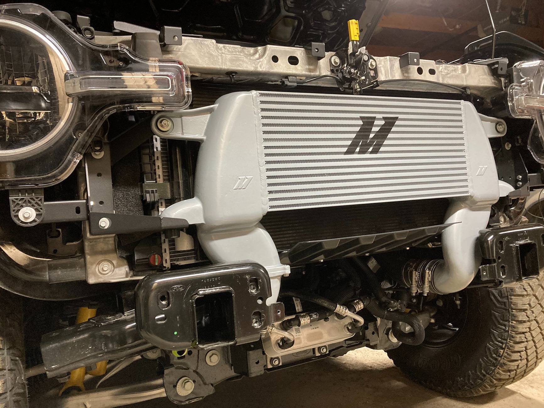

For what it's worth, my Mishimoto high mount reverses that piece and if I recall I had to put a new piece of foam on the other side. They also use plastic panels to direct airflow into the area yous are referring to. 😁
edit: pic of the plastic piece in between the IC tubes.
