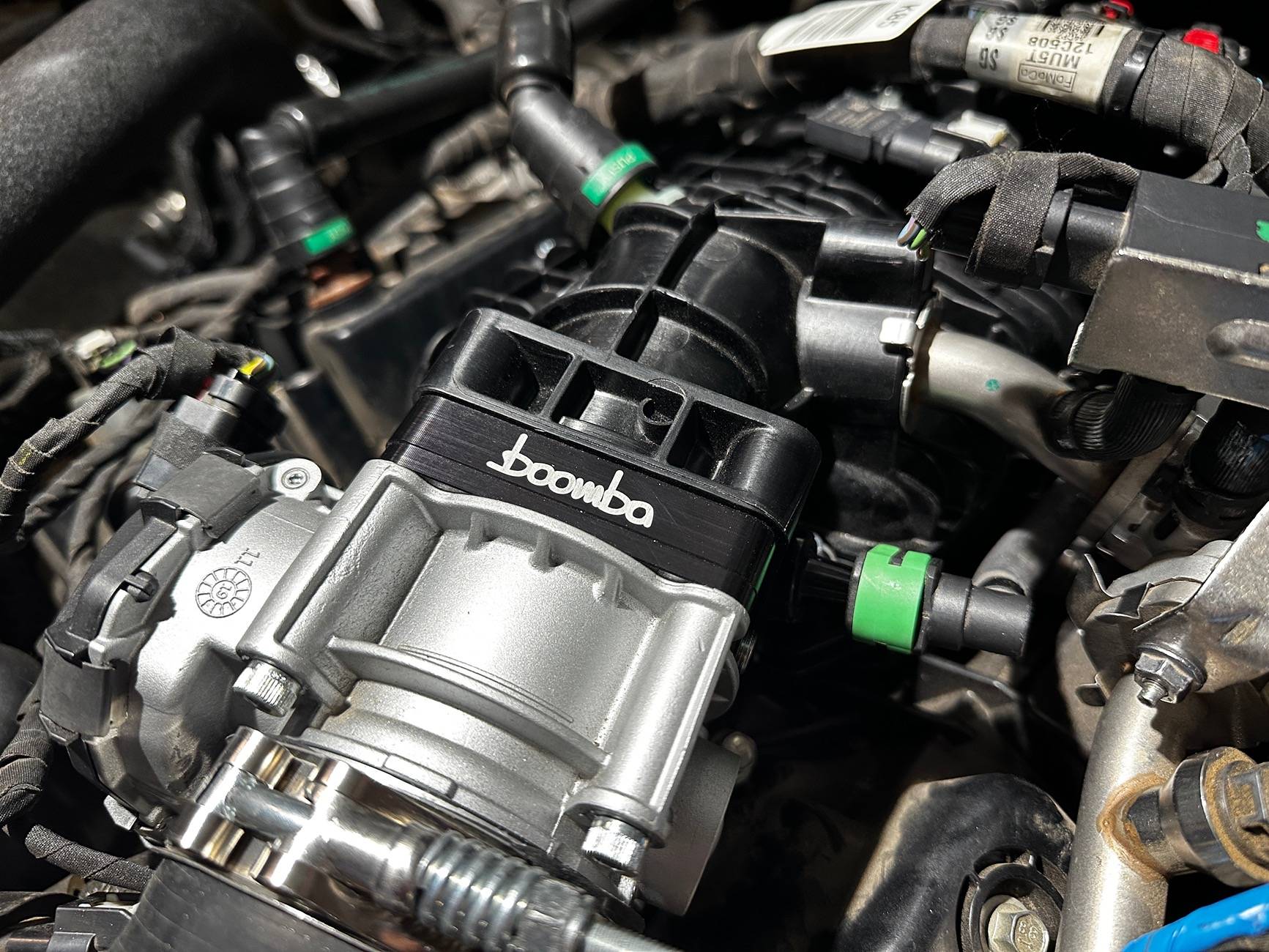

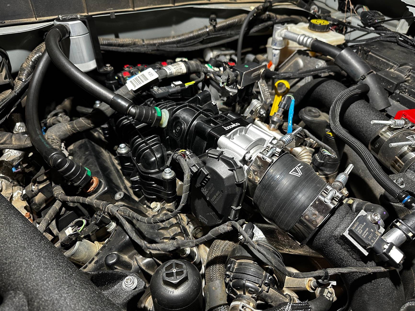

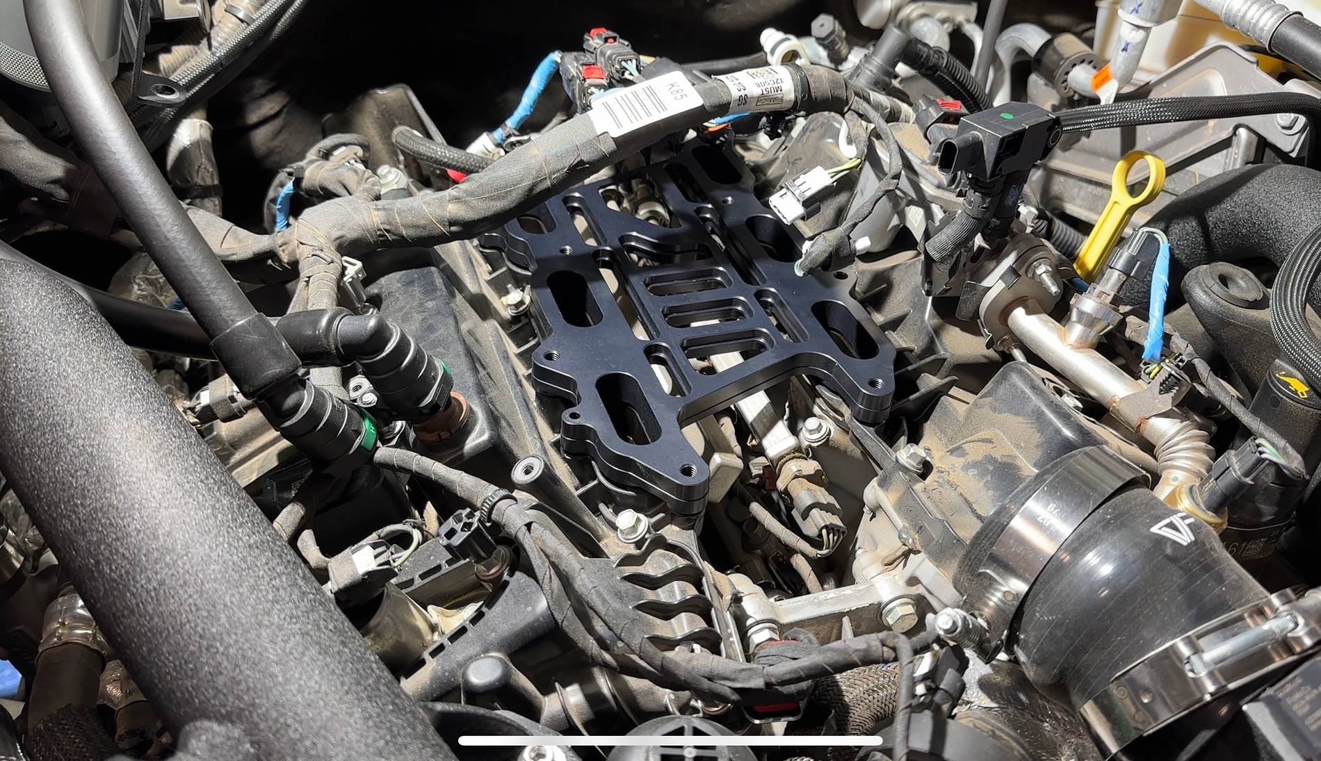

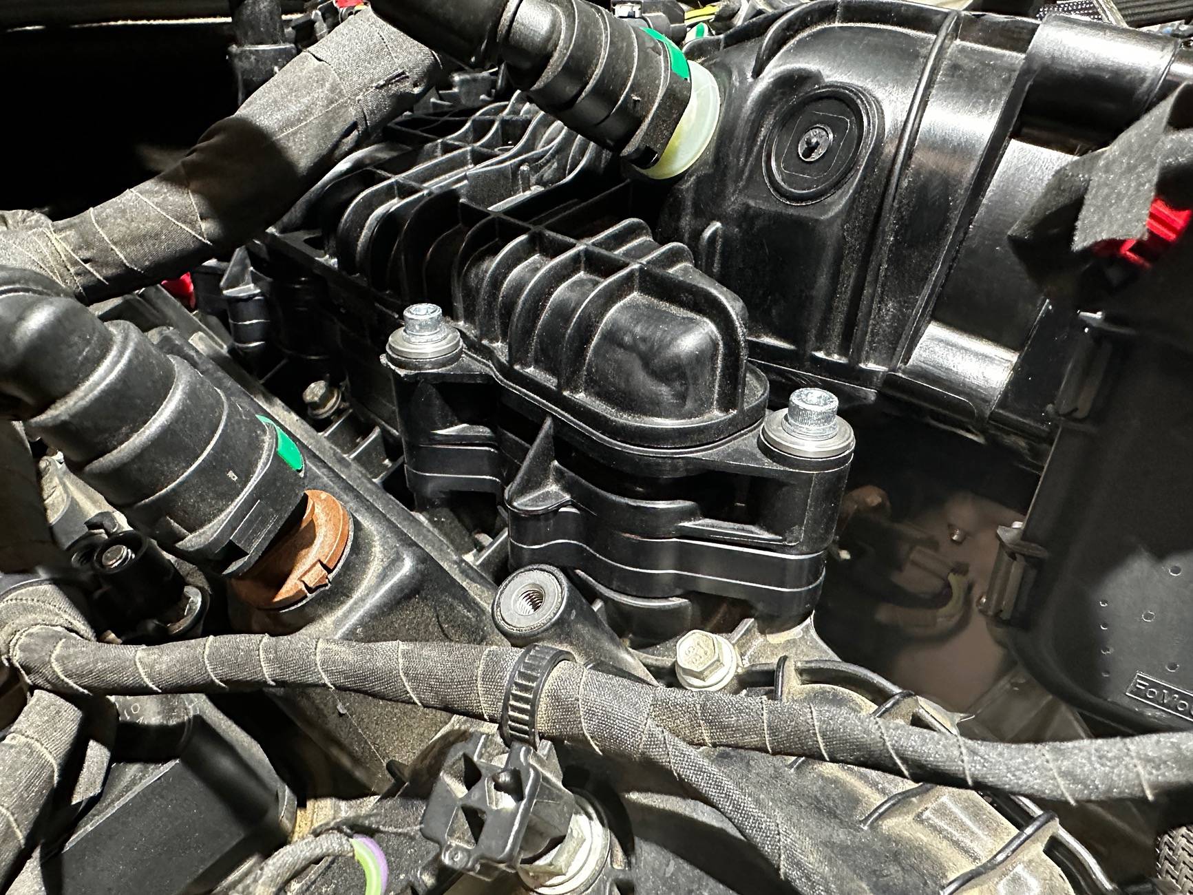

Just wrapped up the install of Boomba spacer kit. Learned some tips and tricks that were not mentioned in the instructions. I’ll be sure to share them when I get around to making a video of the installation.
Lining up the EGR tube and the manifold spacer is bit of a pain, but overall it was pretty easy.
Only put 5 miles on her so I’ll need to drive her a bit more to let the ECU adjust to it. Plan to do some Dragy comparisons and hitting the drag strip this weekend.
Link to the Manifold and TB spacer

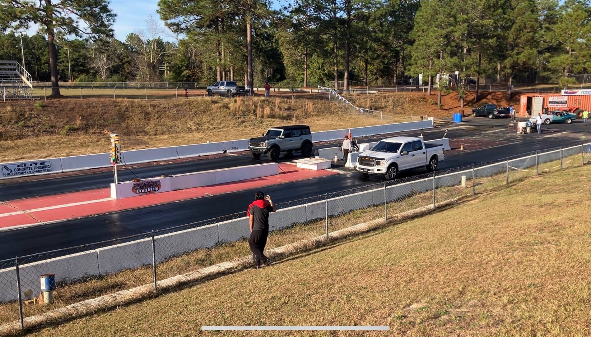

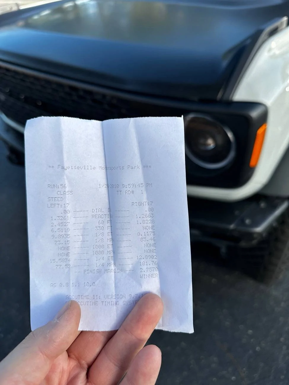

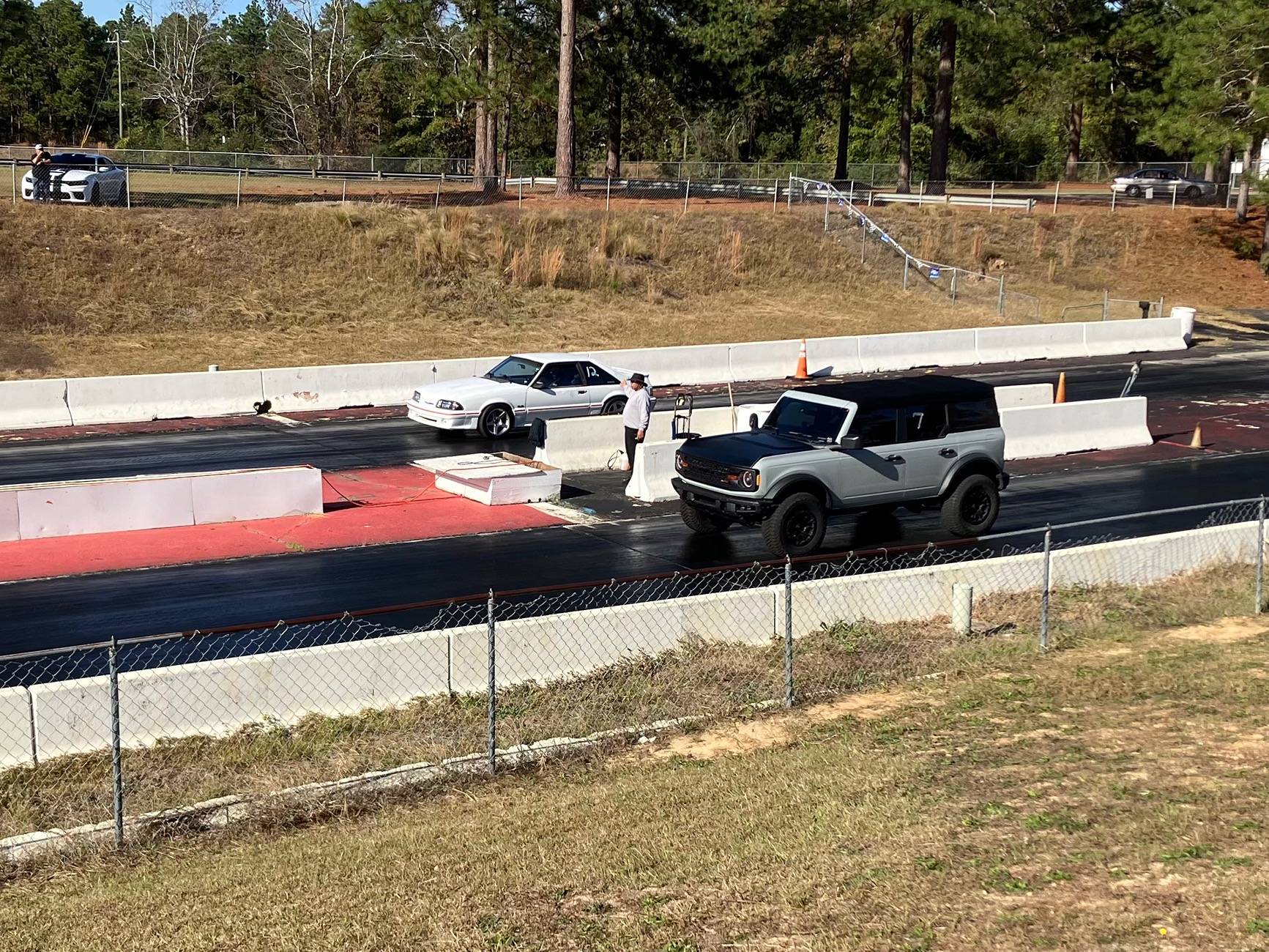

Slow day at the strip, but beat everything I raced. Keep in mind, nothing I raced was really that fast.
  • Mustang 3.7L (Lightly modded)
  • 90's 5.0 Fox body with bolt-ons
  • 2020 F150 2.7L with CAI
  • 2015? Mustang 2.3L with a huge turbo (He would've smoked me, but let off mid way down the track, as he's still working out some tuning bugs) Best time he ran was a 12.5
Lots of old timers came up to me and said they loved the Bronco. They thought I put nitrous on it :)

Noticed it was bucking you pretty hard with wheel hop. What is your launch technique?
RT could use some work...:wink:jk.

You're not wrong. My RT was terrible... I was paying too much attention to my launch RPMs.
My best run was in "Sand mode" which Adam from ZFG Racing turned into Drag mode. The shifts are quicker and it revs higher between each shift.
Here's what I did.
  • 2nd Gear Launch
  • 4 High
  • Advance Trac off
  • Rear locker on (Turned it off after I launched)
  • Left the line at 2.5K RPMs
On the street I can leave the line harder (Around 2.75-3K) RPMs
I also get better times on the street

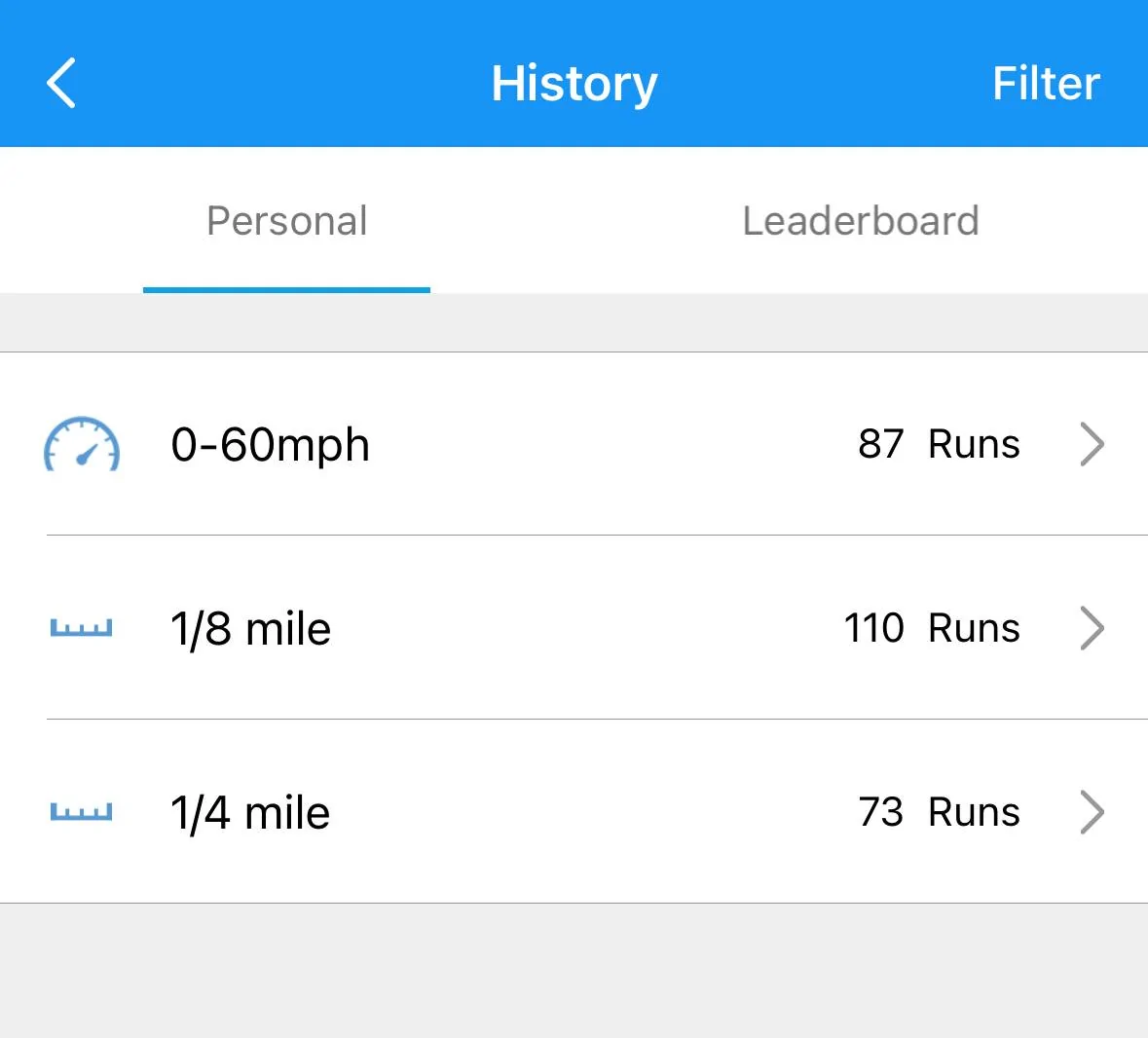

I ended up deleting some of my 0-60 and 1/4 mile Dragy results, but didn’t touch my 1/8 times. I’ve launched this Bronco over 100 times since I’ve got the Dragy. The drivetrain is extremely robust, though my front driveshaft is starting to make noises and I’m pretty sure my hubs are too. Plan to replace some of these components in the future, but the Bronco still drives great and I’ve beaten the crap out of it.
