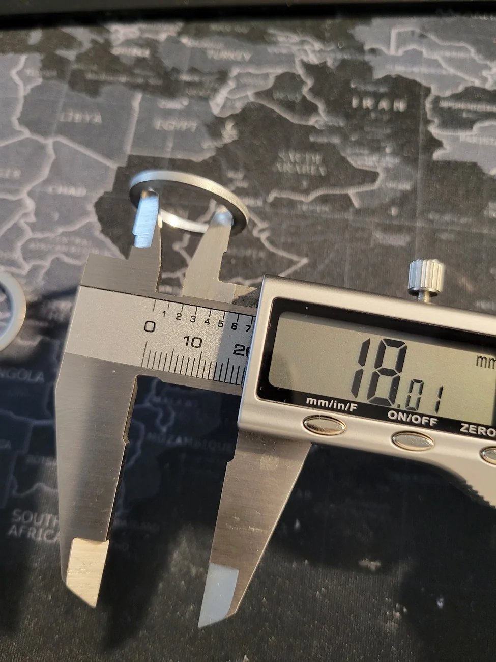

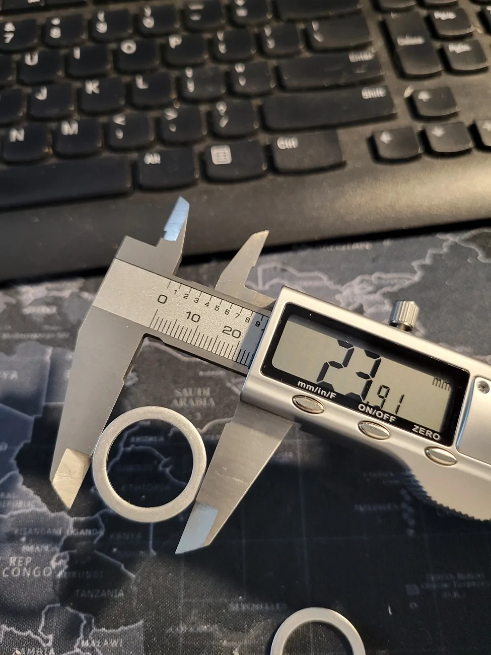

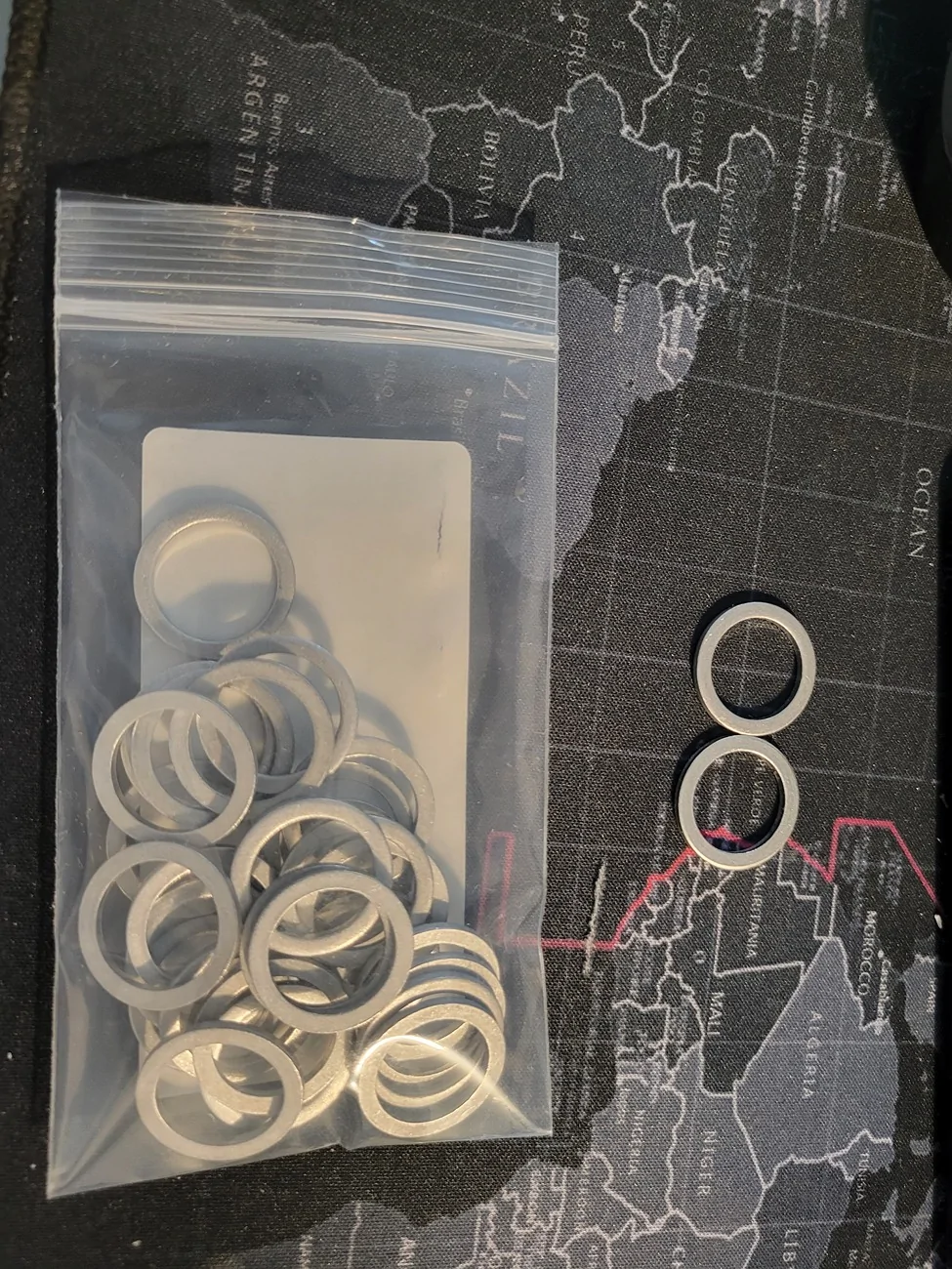

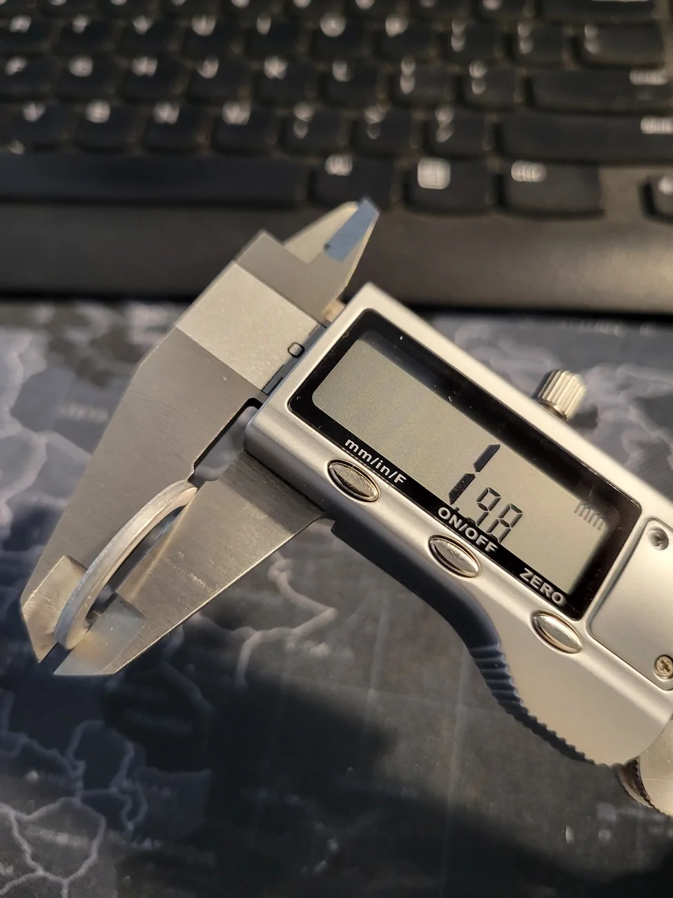

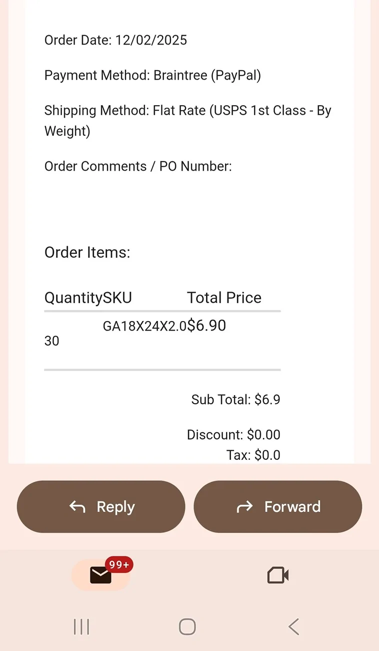

30 pieces for $6.90. Shipping to my location under $3
Ford Bronco $0.35 Transfer Case Crush Washer Match Screenshot_20251203_130547_Gmail
