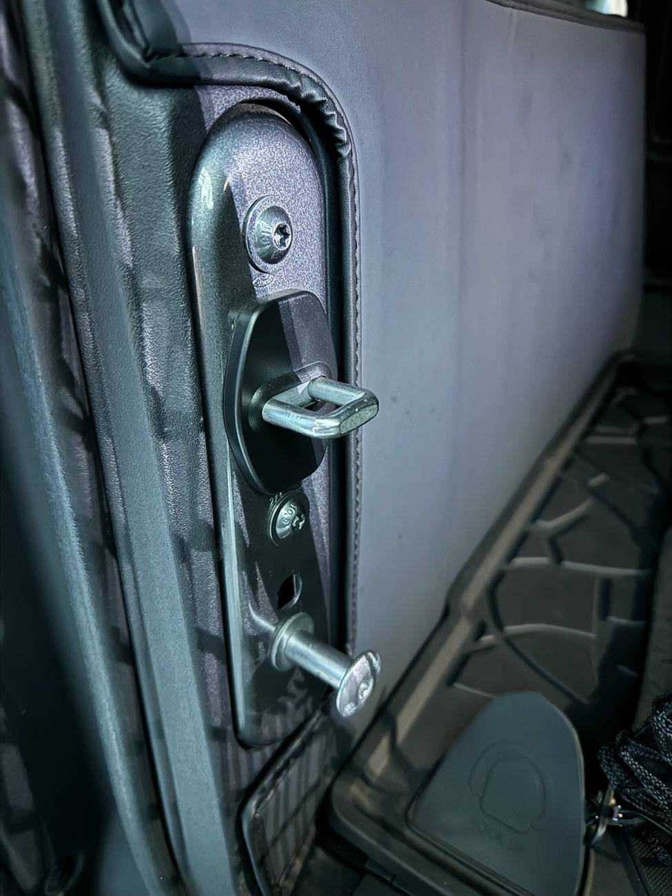

I had another tailgate rattle pop up a couple of weeks ago. It's getting steadily worse.
It sounds like a loose bolt in a body panel, or maybe an electrical connector rubbing against a body panel. It occurs more with up/down motion than side to side. When I first heard it, I swore it was the jack rattling around under the cargo mat. A jiggle rattle when you hit a rough patch.
If i sit in the back going down the road (wife driving), I would swear it's coming from the center of the tailgate, but it wouldn't be the first time I swear a sound is coming from someplace and it's actually from somewhere totally different. I can't seem to affect it or cause/stop it by pushing/poking/prodding on stuff.
It's not the rubber seals - I've had that squeak and this isn't it., and I siliconed the seals anyway just in case. There is so much lithium grease inside this tailgate that it isn't funny.
I've pulled everything out of the back end that isn't stock. And pulled the jack and everything else as well.

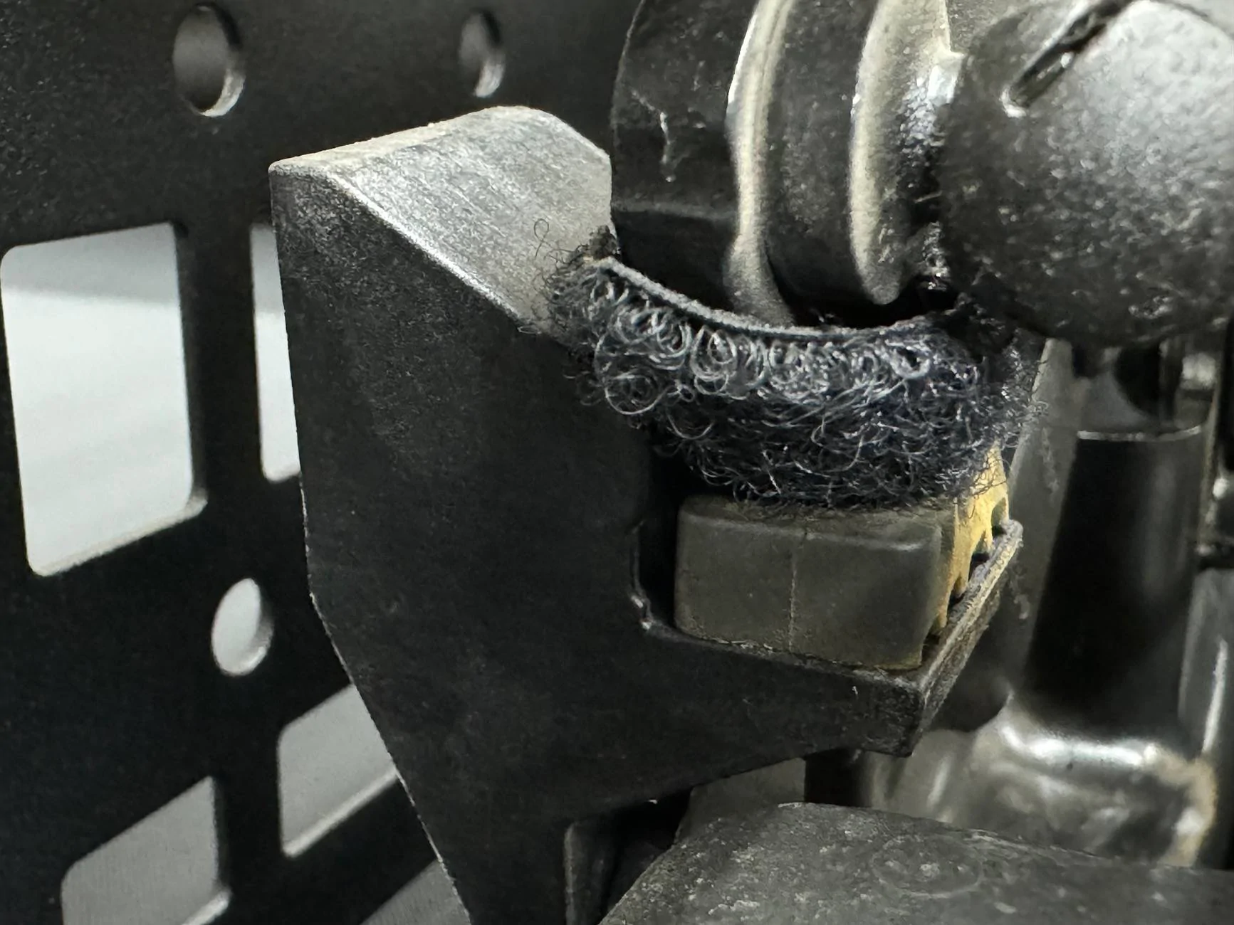

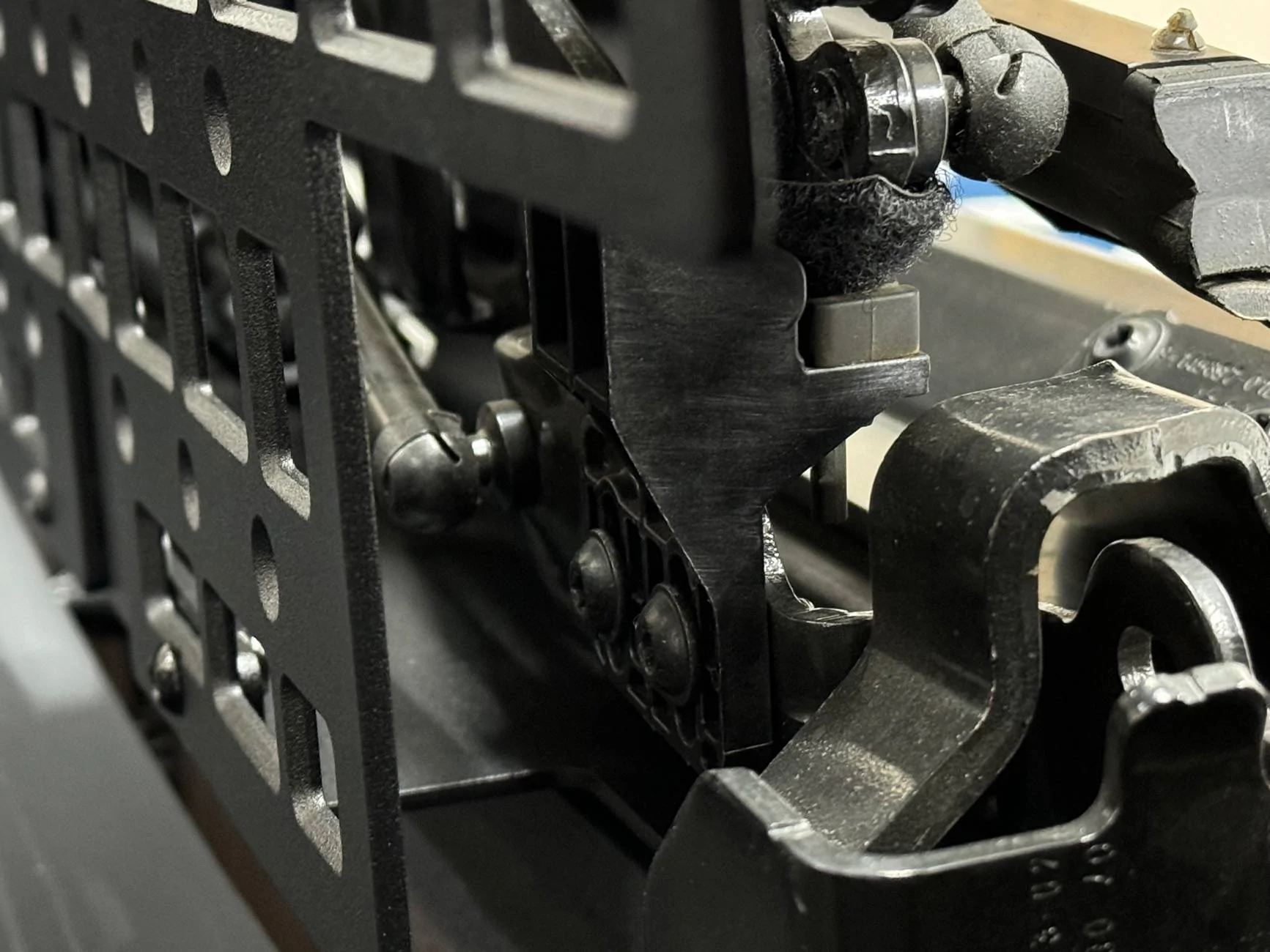

I do have the Turn offroad tailgate hinge as well as the tire carrier. If i take the spare tire off, the rattle is diminished - it doesn't happen as often or as loud, but it's still there.
I pulled the tailgate hydraulic arm entirely off - no change in rattle.
Nothing is loose in the handle or on the latch pins. Bump stop is in the right spot and hitting. No change if I move the bump stop either.
Nothing inside the tailgate, I pulled the entire thing off and shook it around - nothing is loose inside of there, except the bridges that hold the hinge bolts in place -- they aren't broken and tighten up when the bolts tighten up on the hinges.
I pulled the spare tire carrier and inspected the vents in the rear - they all looked good, nothing busted up, and nothing up inside of there.
Stuck a boroscope in all the spots I could cram it into - don't see anything at all unusual. *Edit* also the wiring harnesses in the tailgate accessible from that rear panel for the TBL/Camera - all ziptied in place and nothing loose there.

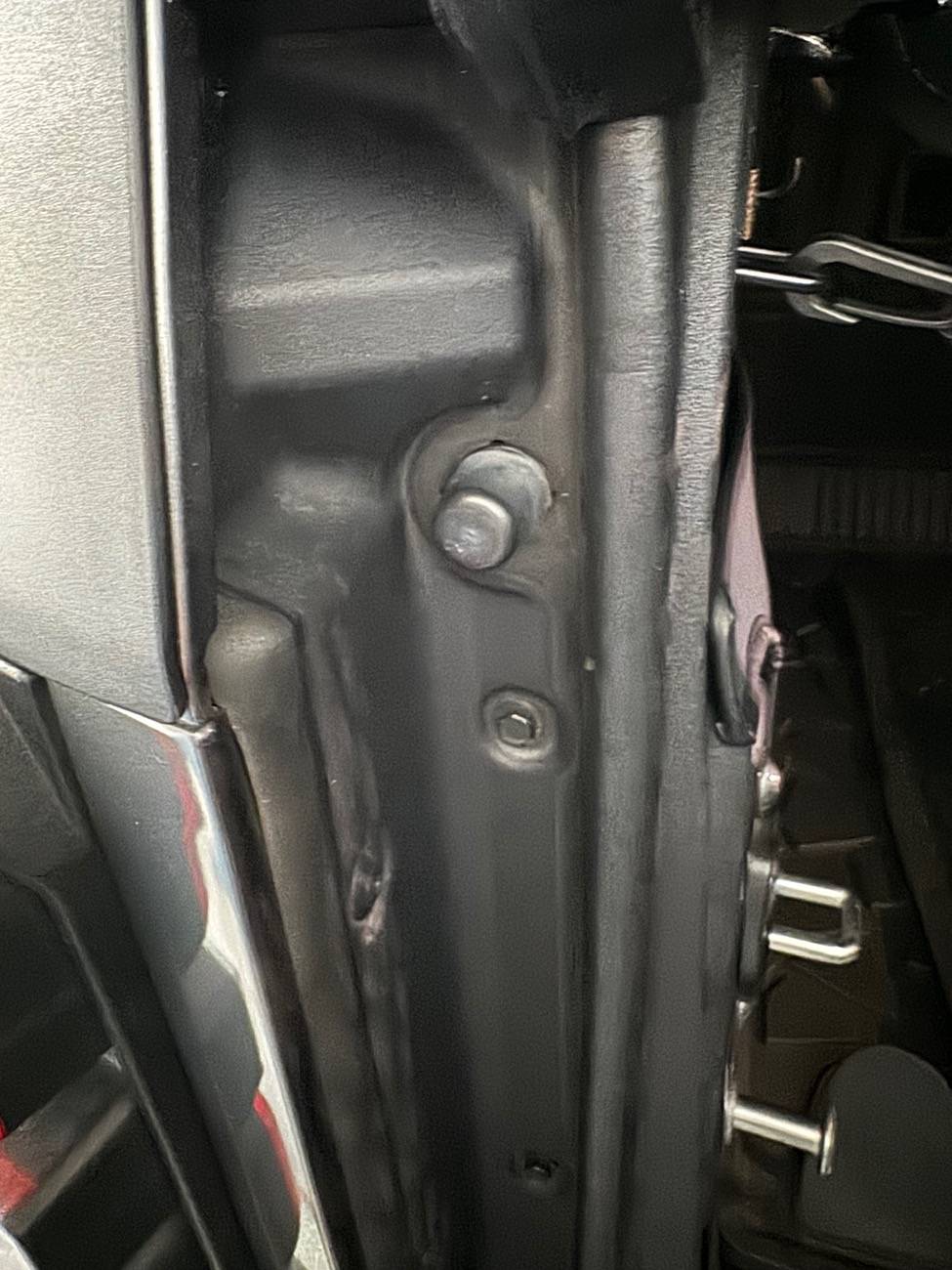

I pulled the right taillight off and checked every single bolt on the tailgate and the TOR carrier - everything was taken off and put back on. Nothing was loose.
Checked everything up underneath - the rear shock mounts, the tracbar, the control arm bolts, etc.
Checked all the exhaust hangers. *Edit* And the heat shield over the muffler.
Pulled the windows out of the soft top and rolled the top all the way back - no change.
Next things to check:
I'm about to pull the soft top off for the winter (a couple of months early, but for troubleshooting). See if it does it with no top, and again with the hard top.
While I've got the top off, I can open up the rear cargo panels. The subwoofer and associated stuff on the passenger side, and I do have the OEM 4-pin trailer module that is up inside the driver's side quarter panel to check.
Will keep plugging at it until I figure it out - it's got me stumped though, I think I've touched every single bolt except whichever the one that's rattling is at.
