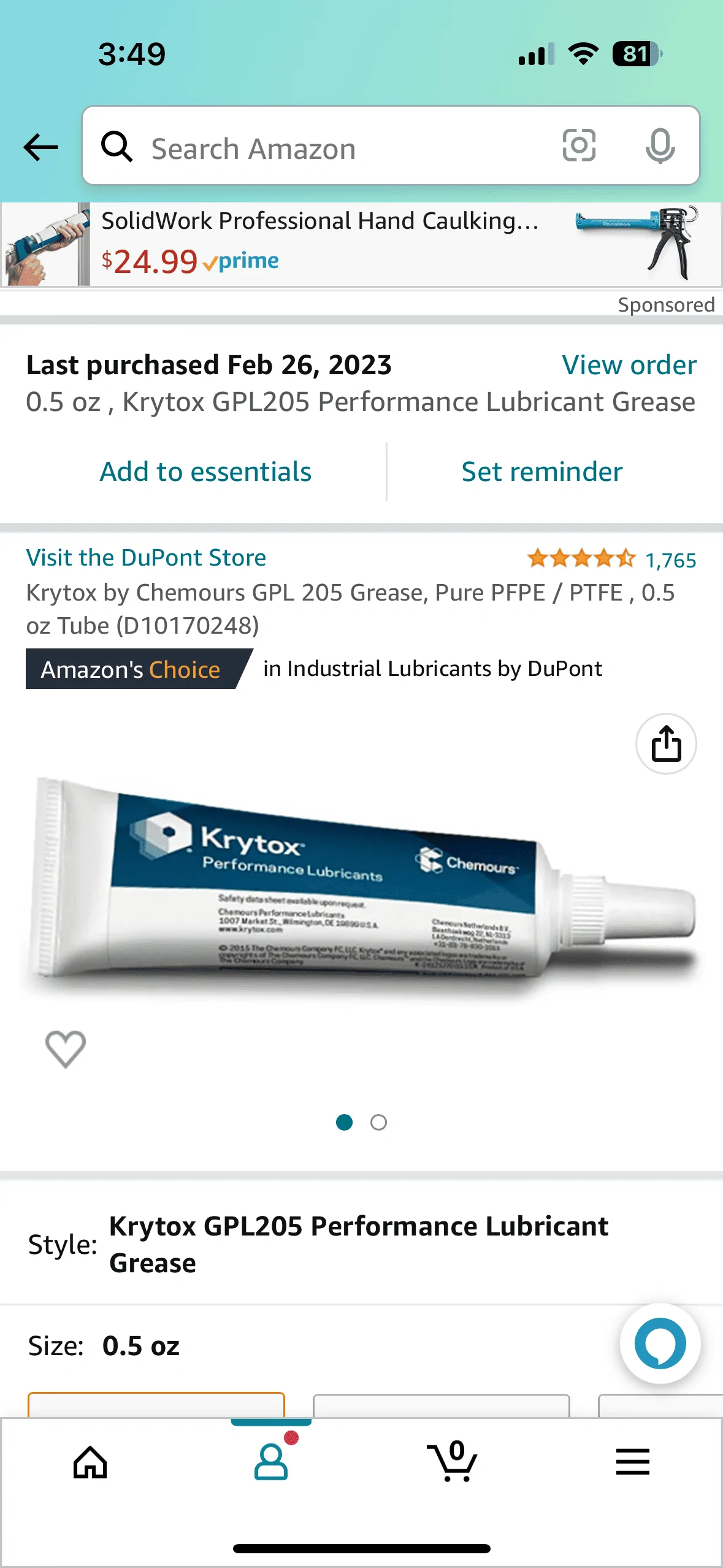

Is this what you used?
I’m going to get some Krytox to use on the tailgate seal and also the MIC seals periodically.
Do you guys recommend the .5 ounce or 2 ounce size? .5 ounces seems so small, but I’m not sure how far a little tube goes.
Thanks for any advice.
Can never have too much lube

.5 oz enough for 2 applications, each 3 mos. apart, with some to spare.

Got the Krytox and helped with the case of water squeak. I’m still getting a popping sound. Possibly from the hinges? Anyone else experiencing this? It’s driving me crazy. Listed the car yesterday because of it - been to Ford 3x with no fix.
