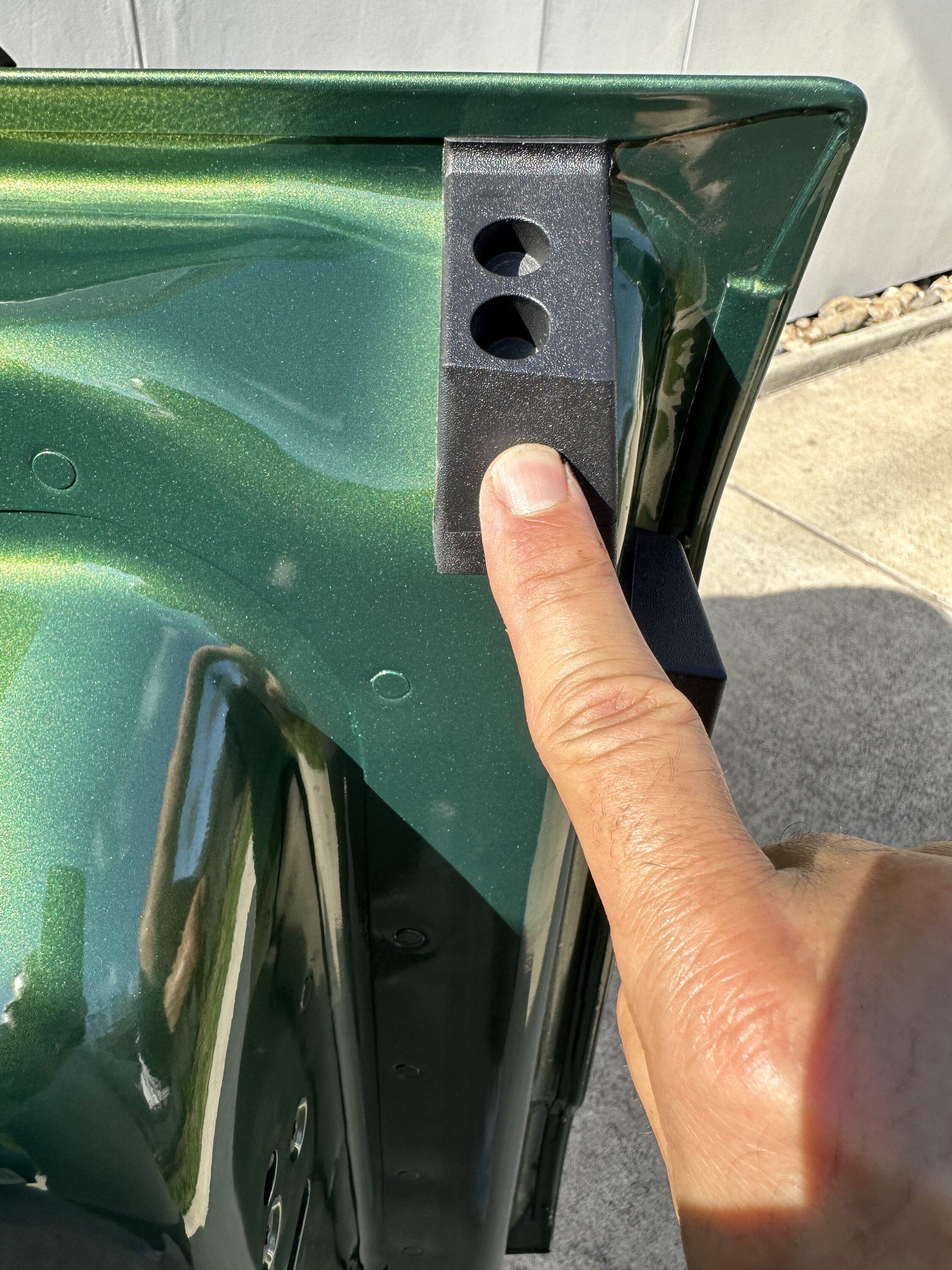

Thx, you mean this one and other just like it?

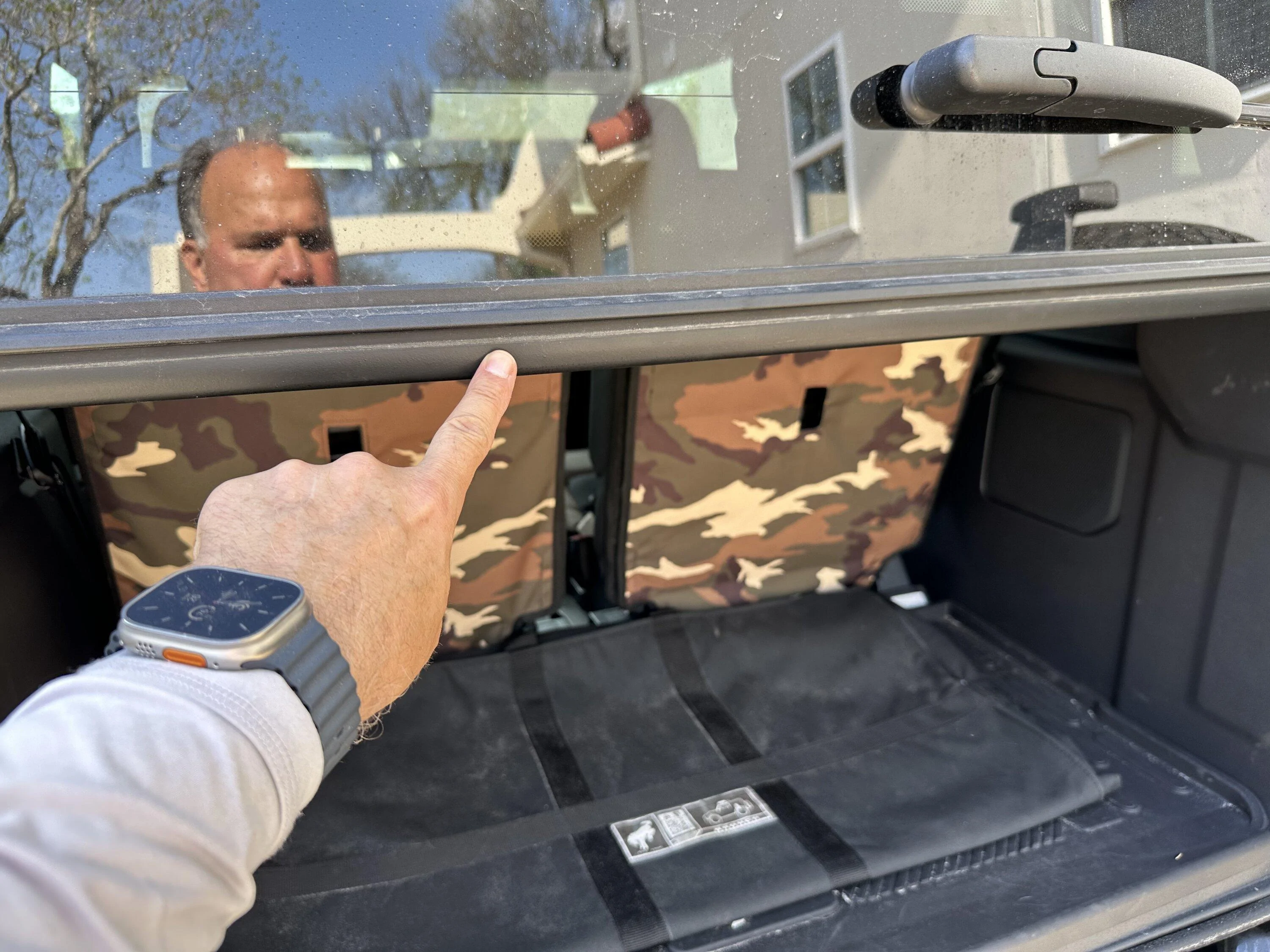

Is this what you used?

^^thx, will let u know how it turns out. Cautiously optimistic

Thanks for the reply. When you applied it, did you just use paper towel and wipe the whole thing? Just got my bronco about 3 weeks ago and it already has the noise. Hoping this fixes it. I had my wife sit in the back(her request) and she said she thought it was coming from inside the tailgate door.

I used a shoe polish dauber but a towel would work too. Let us know.
