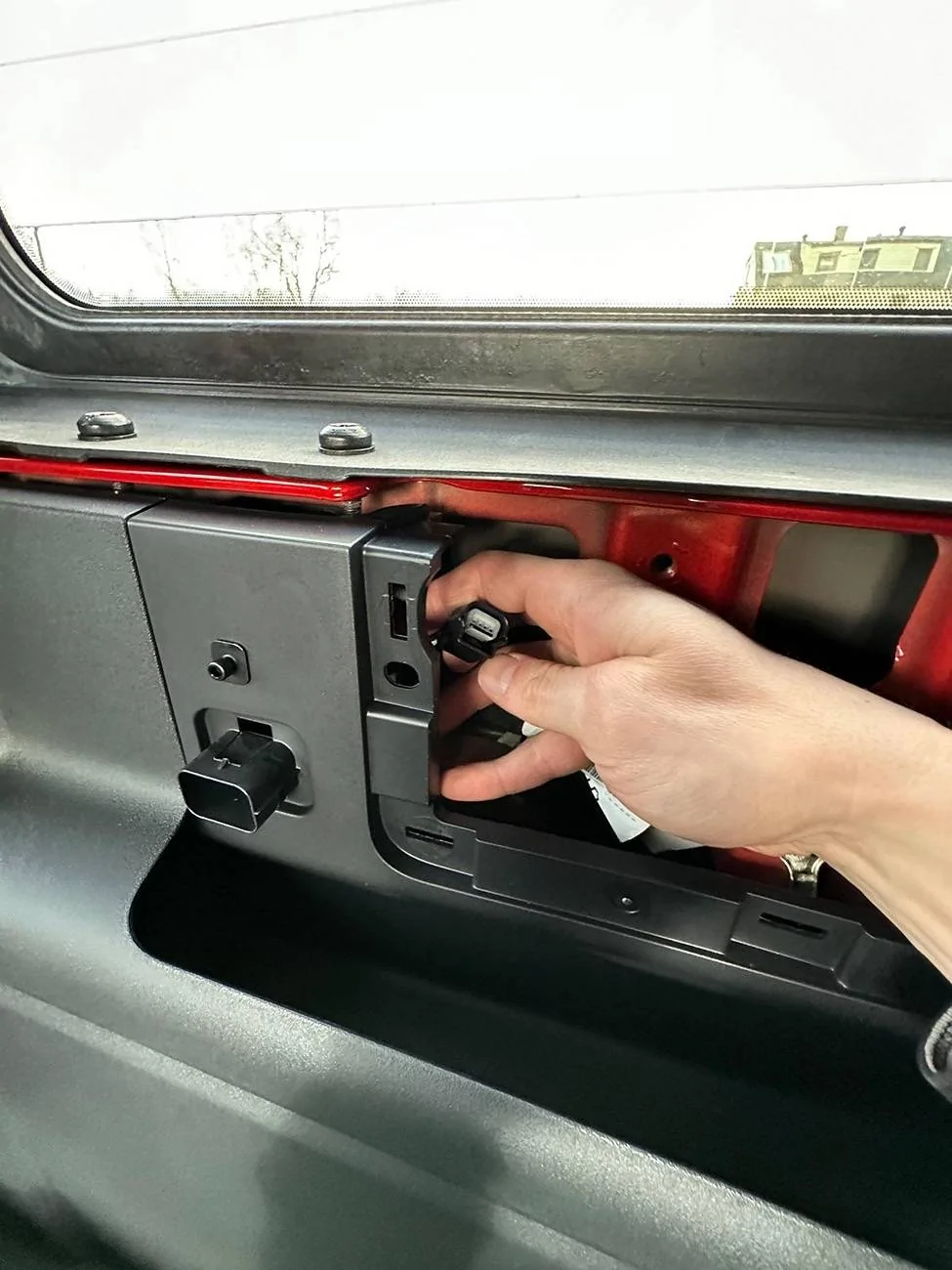

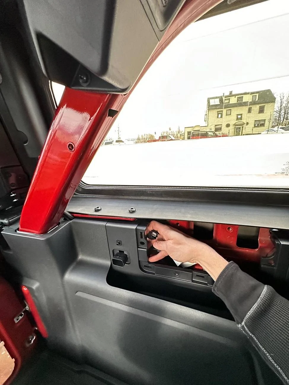

I found this to be my problem as another member posted
If you reach all the way back toward the tail light, this cable will be dangling, and it tends to make a rattle when you’re moving backwards or a little forward
I saw your post over there and that was why I got my scope back out. I stuck my boroscope back there but didn't see anything - there were cable bundles but I could see them all ziptied up - I have a molle panel that's a pain to get out of the way to just stick my hand back there or to really see back there in general.
But just because I didn't see anything with a scope doesn't mean it may not be there - I did have that side off doing a trailer wiring package about a year ago. And I'll have the molle panels off later this fall when I switch back over to the hard top, so it's on my list to dig a bit deeper.
Thanks for posting that - I'll report back if I find that, or anything else, later one. Because from the sound it wouldn't surprise me if it is something like this.

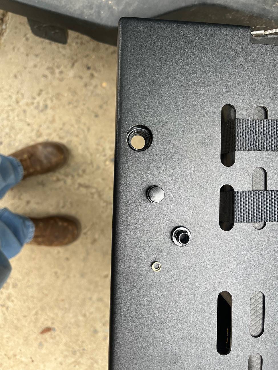

I have both the Turn Offroad tailgate re-enforcement, and the Turn Offroad tailgate table. Each were contributors to an item.
The first was the latch. Something on the latch was rattling, so I fiddled with the alignment on the latch itself. I ~think~, but I'm not positive, that it was the lower re-enforcement post that the bottom part of the latch catches on to help keep it from moving when it's closed -- like maybe that wasn't seating all the way in the seat in the tailgate. Moving it outward (toward the rear) made it worse. Moving it inward (toward the front) made it better. Finally found the sweet spot that eliminated one of the rattles this way. This was the easiest to find. This sounded like a loose body panel or something when it rattled.
The second was in the hinge on the TOR carrier. It would creak. I thought it was just the frame twisting a bit, but nope - stethoscope pointed right to the latches. The latches are fairly robust, and each latch has a single bolts that holds it all together. It would creak occasionally. Pulled the bolts off (one at a time), greased up the bolt where it slides through the hinge, and re-assembled. I may have over-torqued these bolts on initial installation, and it wasn't allowing all the bushings and everything inside the hinge to spin like they were supposed to, so made sure not to cave man it this time. Creaking gone.
Test drive after these two, but before we put everything back - had everything silent. Glorious silence. So we put the table and the trim back on. One of the nut-serts for the table stripped out, and of course, in attempting to replace that we dropped the old nut-sert down inside the tailgate. Not sure if that was a contributor to a rattle or not - the TOR table has a nice foam backing that goes between it and the table, but at this point I'm not ruling anything out.
One of the rattles returned. It sounded similar to the one for the latch - like a loose body panel or something. While taking the table back off, we noticed the latches have a large nut on the back that holds them to the table - both latches, that hold down nut had come loose. Tightened those back up - and that was it. That was the final rattle!

Part 3:
So there was one last occasional rattle that I assumed was coming from the dropped rivet nut.
Turns out it was also the Turn tailgate table. The latch fell apart the other day. I was able to find the pieces and put it back together - it’s probably been loose for a while but I didn’t realize and it isn’t obvious to check
