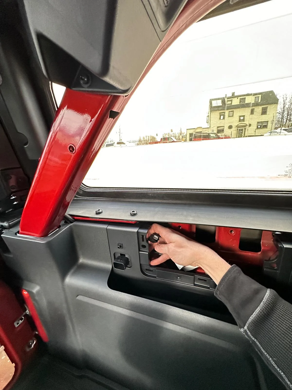

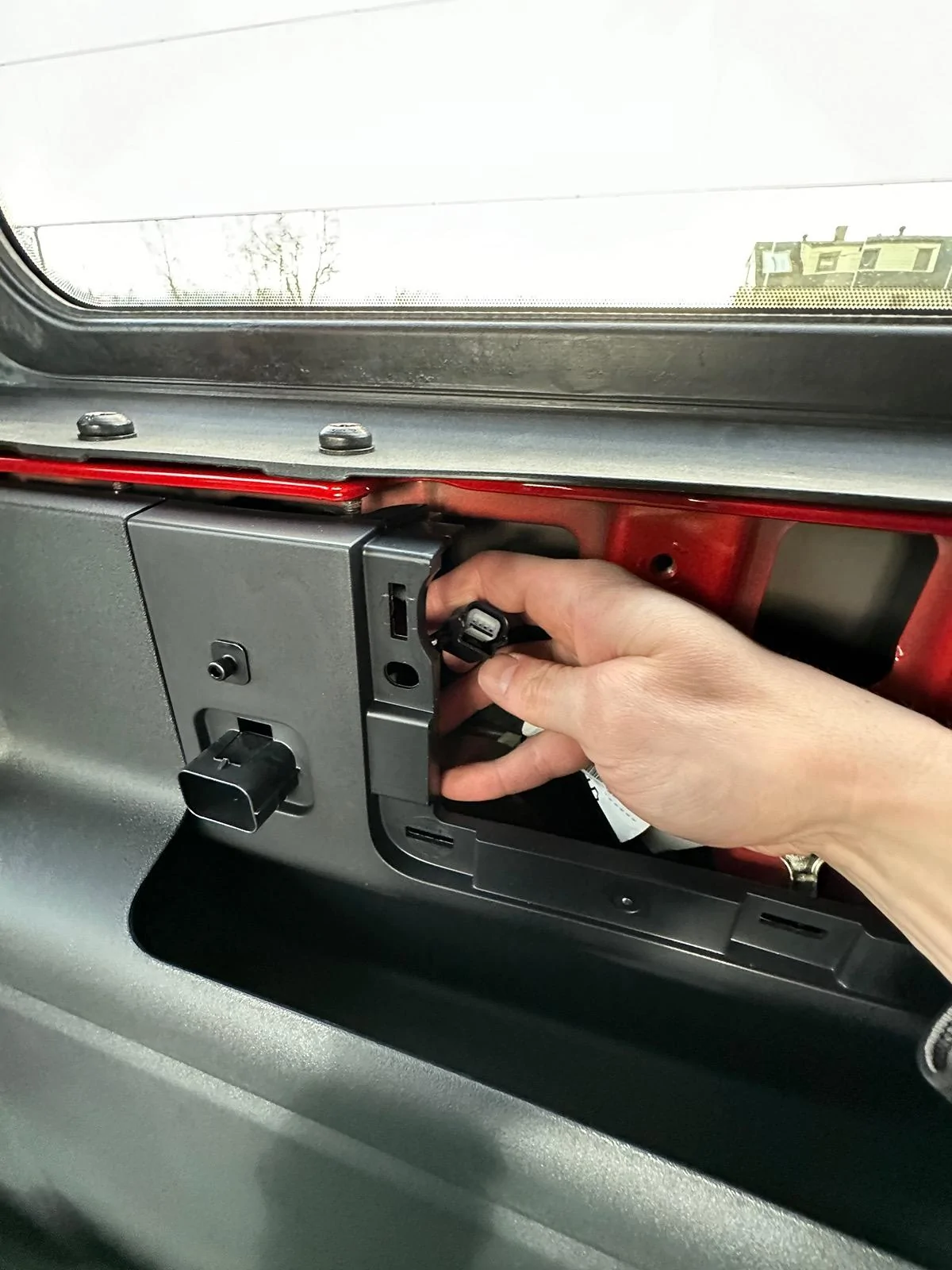

Found mine. Made my wife drive me around while I sat in the cargo. Found this dangling like a pendulum in the behind the left side back interior panels. It was dangling way toward the back and I had to reach my arm back there to reach it. Quiet now since I taped it up and zip tied it thankfully! Temperature differences, lube, and spare torque effects must’ve been my imagination.
Anyone know how to clean up a can of lithium grease inside the tailgate? ;)
"dangling like a pendulum" is exactly how my sound behaves; like something swinging back and forth, and bouncing off the body as you drive. My sound is also definitely on the left side. However I checked the spot after seeing your post and everything seems secure in there. Could you see the dangling part when you first opened the panel, or did you have to feel around in there to find it? I wasn't able to see, or feel anything loose on mine.
I had to look straight back from that panel toward the back, this cable and harness was dangling straight up and down almost all the way back at the taillight. I spotted it with a small flashlight pointed toward the tail in that opening and just sticking my arm in there and feeling around. It was probably dangling 10-15 inches behind where I am holding it in those pictures. I suspect it might've been something the dealer did when putting my trailer hitch wires on but can't be sure; that would track with about the time the noise started.
Thanks! I'll see if I can look further back.

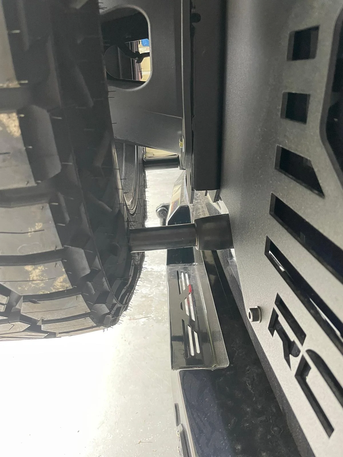

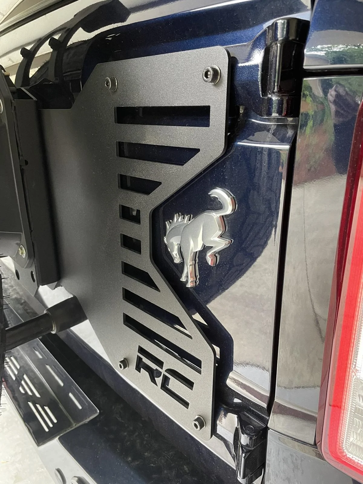

I recently purchased a 2021 Ford Bronco Big Bend and was immediately faced with this metal-on-metal rattle. Video included.
This would occur - with or without the hard top on - when riding over potholes, manhole covers, speed bumps, cracks in the road, and, I would bet, pennies. I'll preface this by saying that my Bronco has numerous mods including 20 in wheels on 37 in. tires with large neg offset. See picture.
Ford Bronco Gnarly tailgate rattle Bronco Driver Front Profile (no top)
The spare wheel/tire combo weights 125 lbs. The first thing I did was remove the spare and drive around (same potholes, speed bumps, cracks, and pennies). The rattle was completely gone. My first solution was to install the Rough Country tailgate reinforcement (and relocation) bracket. This did nothing for the sound, but is probably a good thing to do given the weight of the spare. See picture.
Ford Bronco Gnarly tailgate rattle Spare Tire Reinforcement Bracket
The next thing I did was spray 1/2 can of lithium grease in every nook and cranny in the tailgate (as some suggested). This did nothing for the sound. The last thing I did was extend the tailgate bump stops using wooden dowel rods. This removed 99% of the sound. I now only hear the sound when I hit decent size bumps while turning (typically 90 degree turns in town). My guess is that I fixed the problem when the Bronco goes up and down, but not when the chassis experiences torque.
Due to the wheel offset, I needed my spare tire bump stop to extend 5.5 inches. I couldn't find anything available online so cut a 1 in. diameter dowel rod, notched a small recess in the end to accommodate the screw head, lubed it with dish soap, and inserted it firmly into the stock bump stops. I then wrapped it in Flex Tape (the leftover as-seen-on-TV tape that didn't fix my garden hose) to hopefully slow the wood rot process. See picture.
Ford Bronco Gnarly tailgate rattle Extended Tailgate Bumpsto
Just did the same today, hope this is the answer, any idea what the connector is used for?
BEW119
May 5, 2024
NJ
F150, MUSTANG,
It was exactly what you identified as the issue

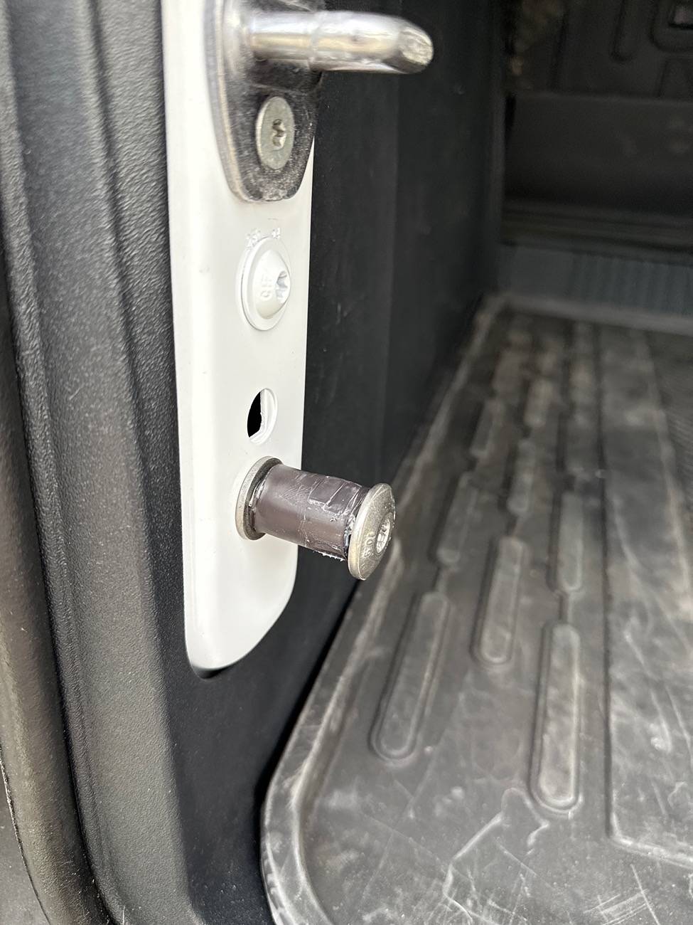

prcdude
Mar 23, 2025

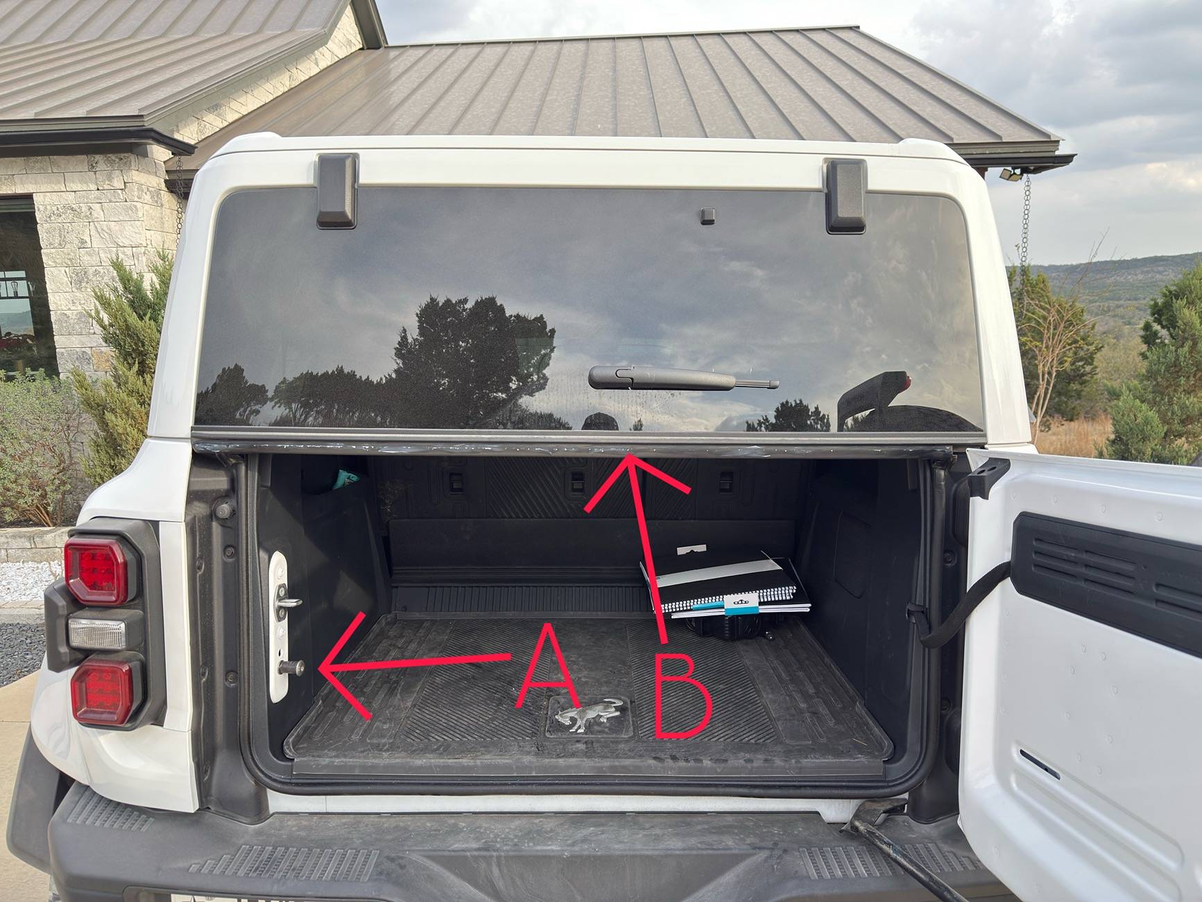

Been dealing with a tailgate rattle on my wife’s 2024 Raptor. Solved the issue 100% today. She would get a decent metal clunking sound when going over anything bigger than a small bump. I road in the back to pinpoint the sound and found it to be coming from the bottom post where the tailgate latches onto body (labeled “A”). I was able to remove 100% of this sound by doing 3 layers of heat shrink over that post. Made the tailgate much more secure.
However, once I did that, we then had a creaking noise coming from the rear tailgate area. I was able to remove this sound completely by applying Krytox GPL205 to the bottom window rubber (labeled B) (thanks to another member’s post recommendation).
Ford Bronco Gnarly tailgate rattle image
The Bronco sounds like a much nicer vehicle with both of these sounds completely gone.
I did not find a solution when looking through the threads so wanted to show what worked for us. Hopefully this helps someone.
Heat shrink https://a.co/d/1x5AcbJ
Krytox GL205 https://a.co/d/ebrQL7W
Ford Bronco Gnarly tailgate rattle 5A2957EF-565B-482F-8ABB-82DF064C5705
obes22
Matt
Mar 19, 2025
Cape Cod
2024 Bronco
