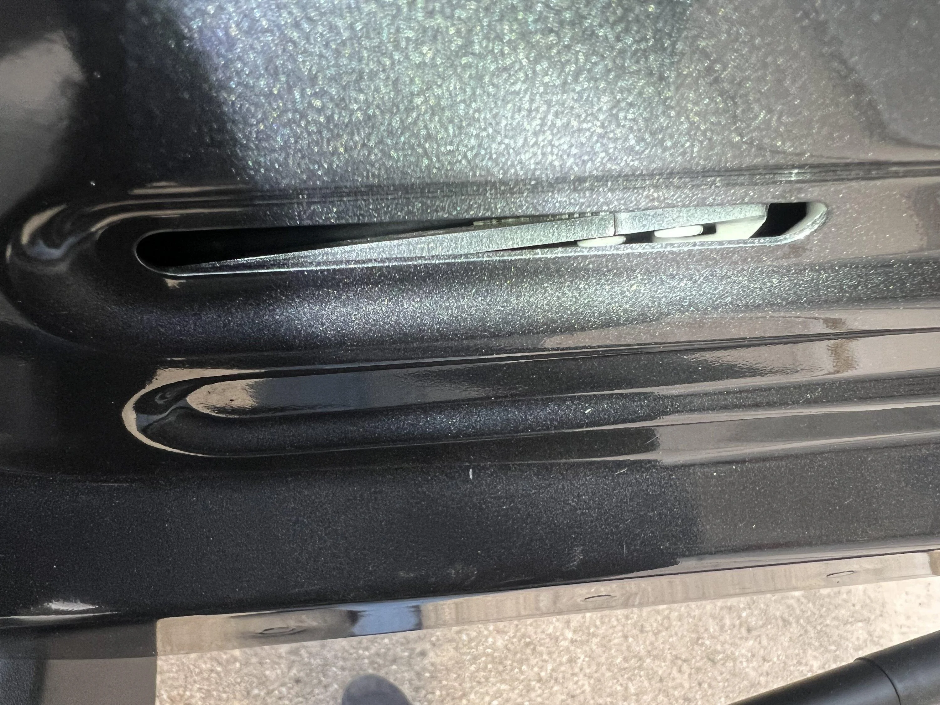

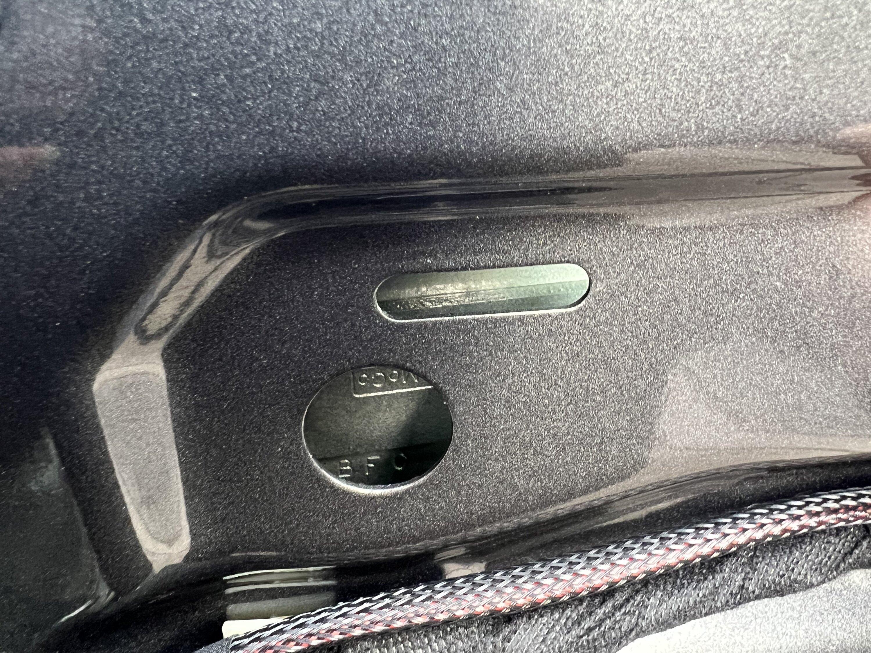

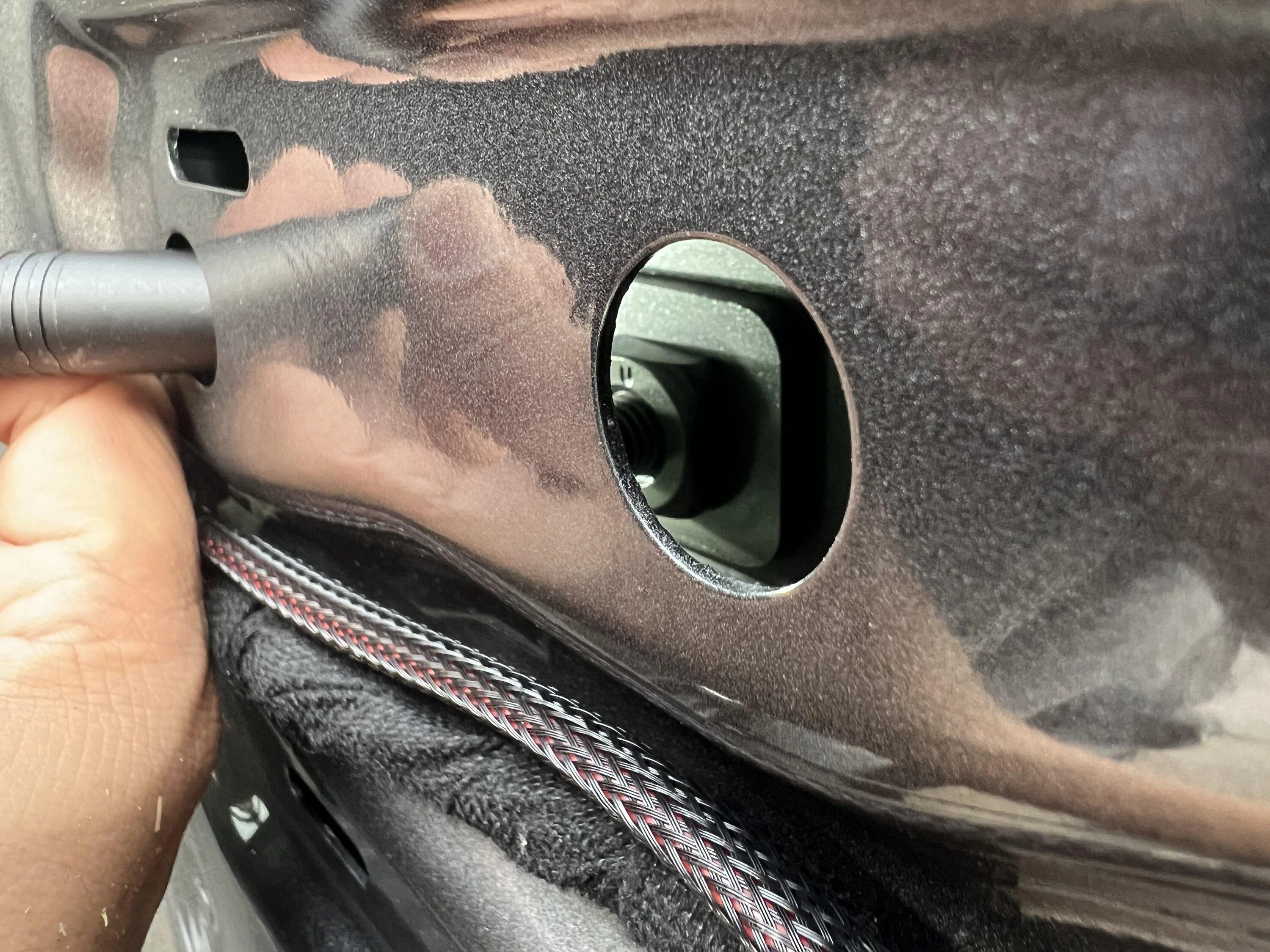

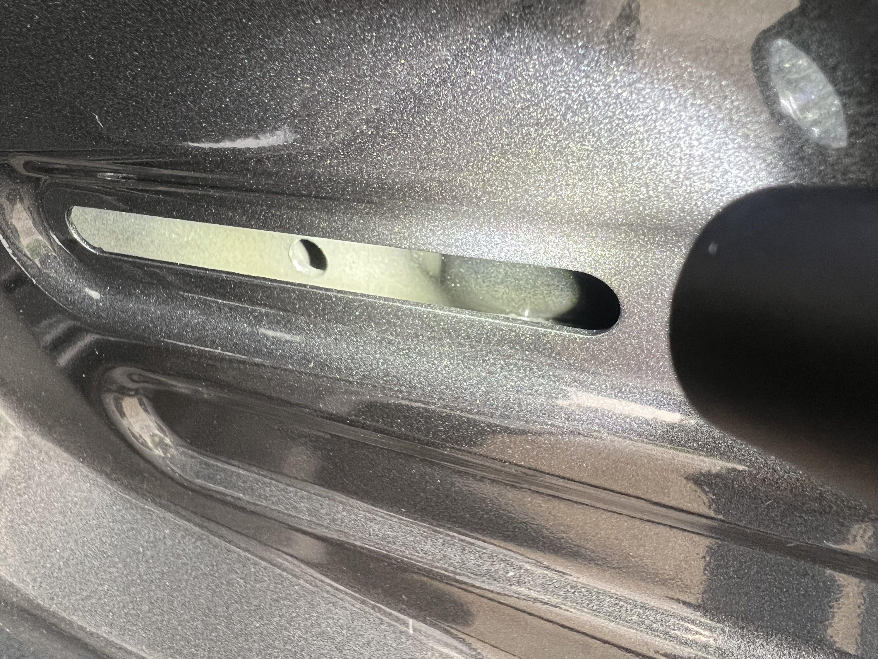

Yea the top one you have to remove to see the hinge. The bottom hinge you can see no problem.

Thanks for taking the time to post these pictures.
I can track what the last two photos are showing, but the first two are harder for me to orient to. (Admittedly, I haven't taken off the black plastic panel yet.)
I assume the first two photos show what's behind the black plastic panel?
Is the grey tube you are holding in your hand the "straw" you used to spray in the silicon?
And in the first photo, what is that behind the circular opening in the middle of the picture?
Thanks for any info you can provide.

In the first pic I’m holding a flashlight and shining it from the backside. Your seeing the nuts on the backside of the hinges, inside the tailgate.
The last two are the lower hinge. You cant see the nut or backing plate for the lower hinge so you have to aim your straw in the direction you think i it is and just spray away.

Got it. Thanks.
Any issues with removing the black plastic cover?
