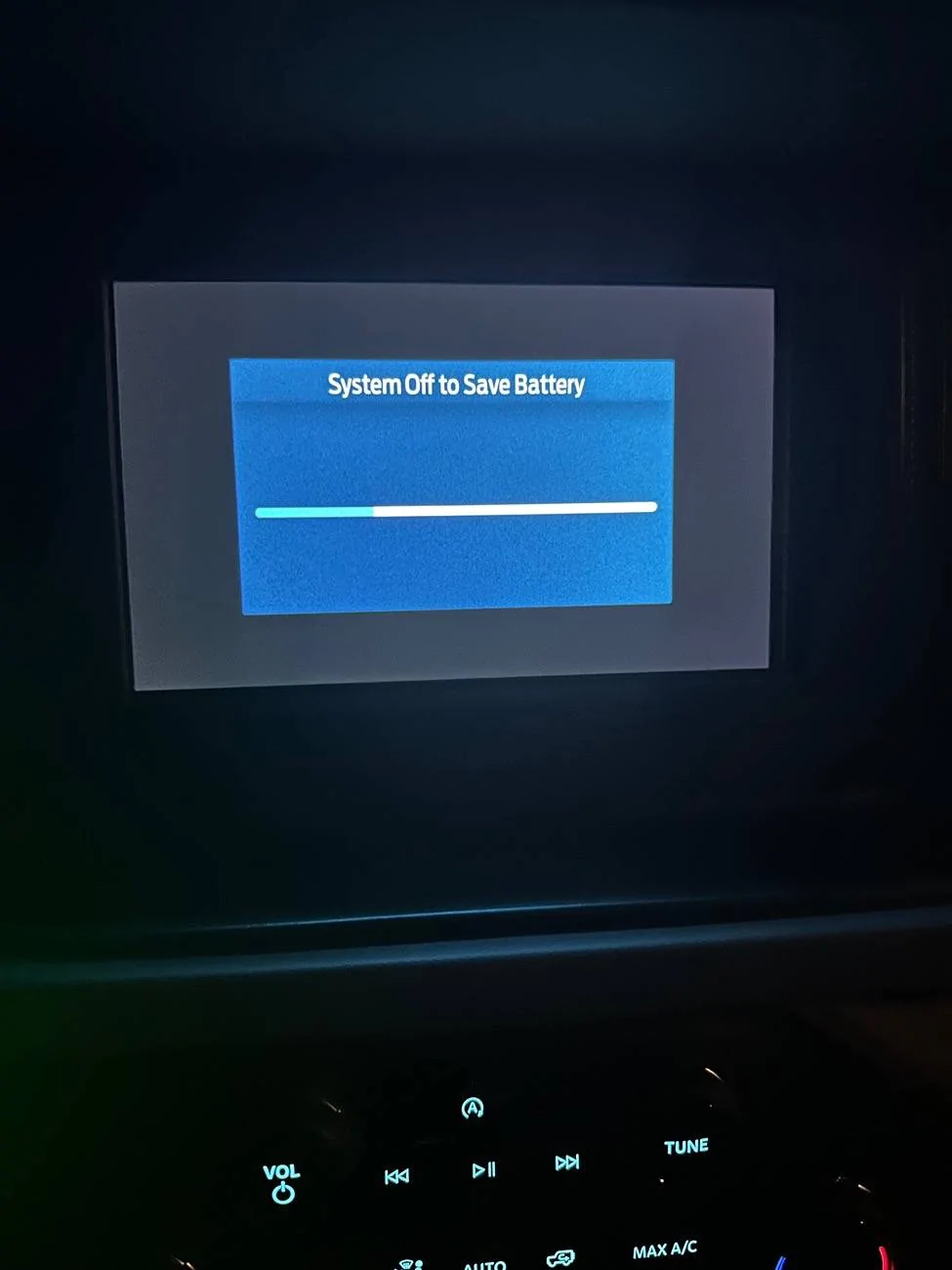

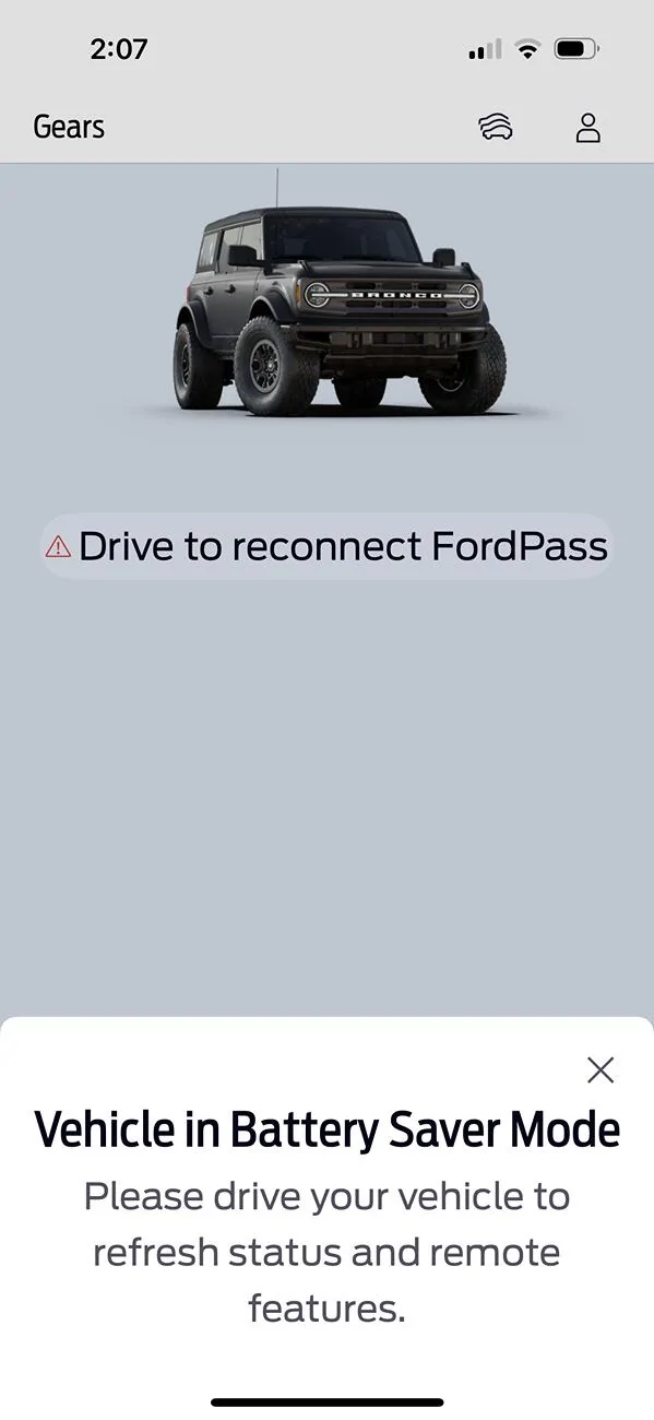

Has anyone experienced this? It just started 2 days ago (right after I removed the rear speakers). I left the wires hanging while I wait for replacement speakers. Other than that nothing else changed. Also ford did a software update last week for a safety recall (something about the rear facing camera).

My guess is that when you were working on the truck you had the doors open and interior lights, etc. on for a long time w/o the engine running and ran down the battery...
Charge the battery or drive it...

I would check the battery voltage with a multimeter. If it's below 12v at rest then it needs to be charged. There have been alot of problems and warnings lights fixed on broncos by just simply checking and charging the battery. Vehicles today can do some crazy BS because of a low or bad battery. This maynot be your problem, but it's a good place to start. Hope you get it fix.

Did you try driving it like it recommends?

The Bronco's instrument cluster screen will also tell you the voltage. It seems accurate enough to tell if your alternator is working or your battery drained. It would have to be on to drive it vice the center screen too.
Like OP found out, though, driving the Bronco for a bit fixes a lot of the electronic gremlins. I had some issue where I had to drive over 20-25mph for 2 miles straight and it was almost a week before I got a smooth stretch to do it.
