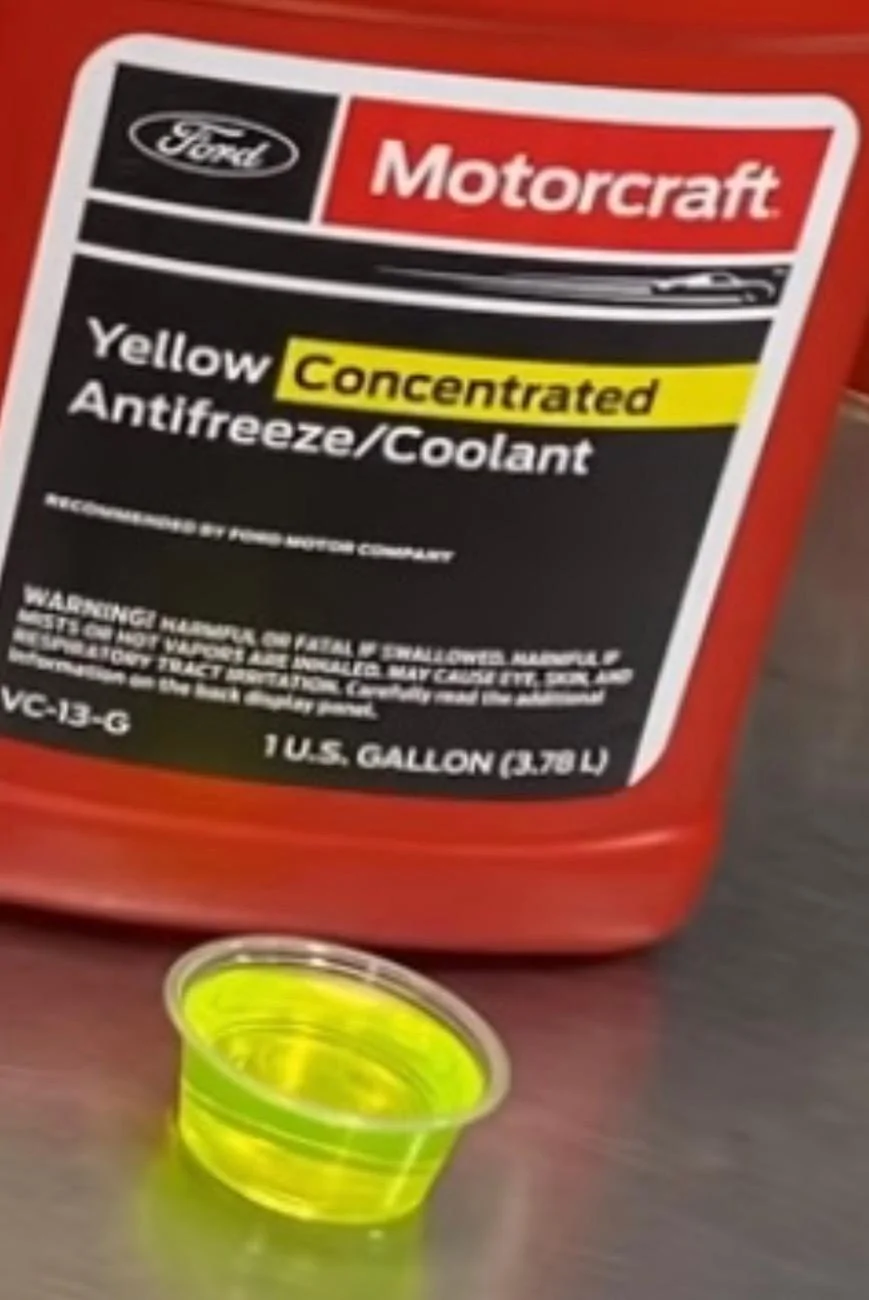

Here’s the coolant out of reservoir. It is brighter but ford yellow coolant is almost Neon color. Do you think the dealer didn’t do a good job for a full flush?
That pic is of straight, non mixed, non diluted coolant. It’s usually mixed 50/50 with water when you put it in the vehicle.

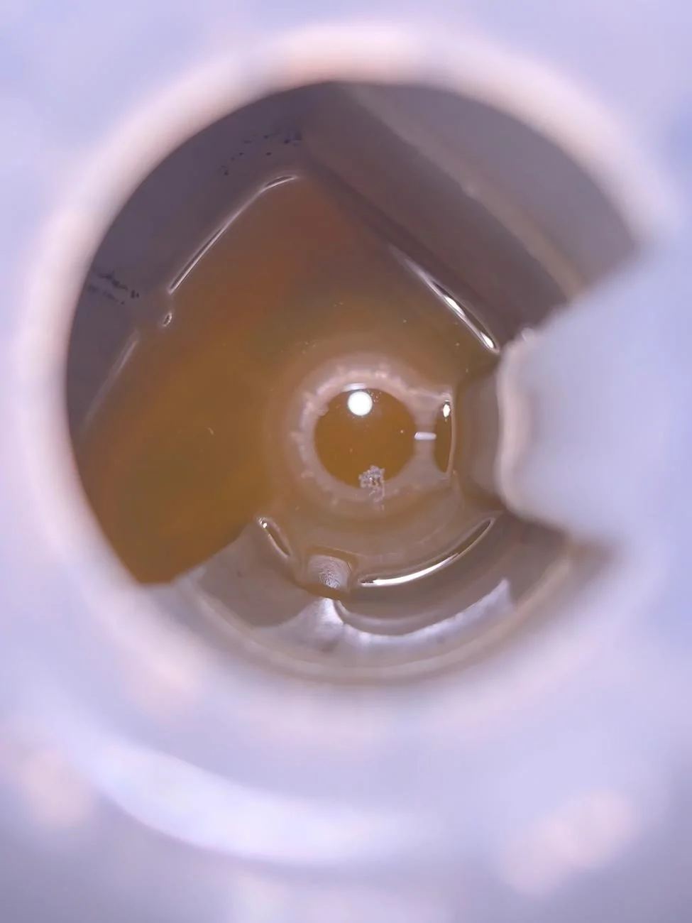

So this isn’t good? (Had to use an inspection mirror to take the pic since the air compressor mount blocks my view…
I don't know this for certain, but if I were to guess it's just from some of the oil from machining and flushing the block was still in the coolant passages and it floats to the top of the reservoir and makes a ring around the tank. I don't think it will harm anything or is any indication of anything bad - so long as it doesn't get worse or anything.

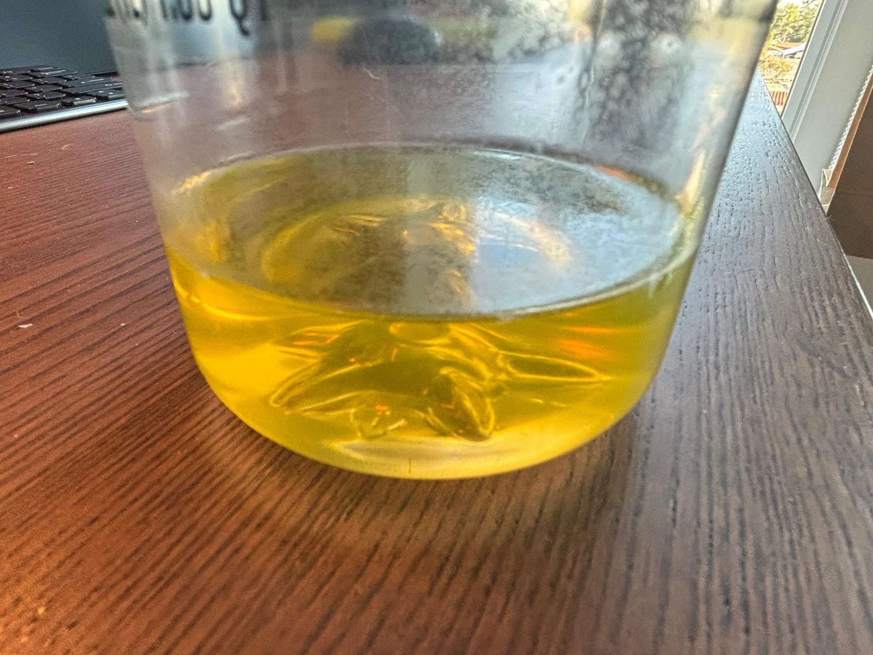

I found this under the oil filler cap yesterday when I changed my oil.
Ford Bronco Concern about my coolant IMG_1664
So several people said check my coolant level... That’s when I noticed the reservoir. But none of that stuff under the oil cap was on the dipstick or in any of the oil that drained. Vehicle hasn’t been missing or running hotter than normal.

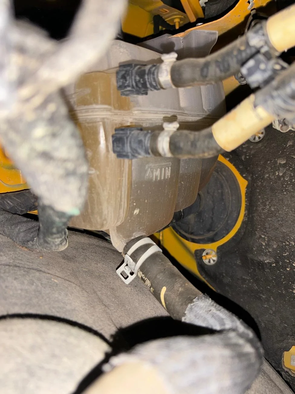

Hi all,
My bronco is reaching 50K. When I check the coolant it is sitting at a low level, but before I add more I wonder if this is a normal color of it?
Just in case it needs a flush/change, is it under warranty?
Thank you!
Edit: Could it be a symptom of something is wrong with the engine?
That does look like something got in your oil.
If the level in your reservoir hasn't changed though - it could also be water or something - the dipstick not in all the way or fill cap loose.
