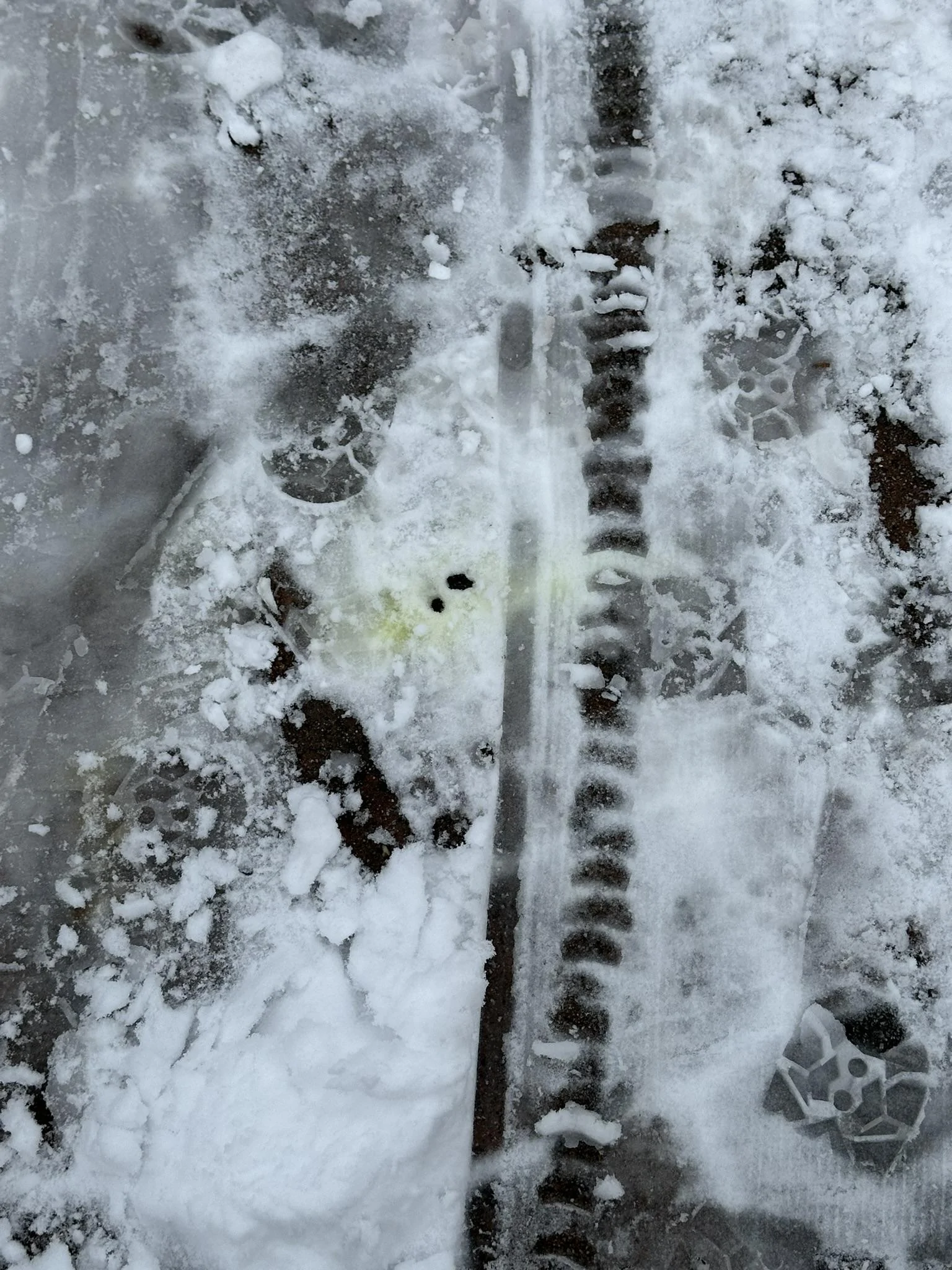

I just woke up to this
Ford Bronco Slow Coolant Leak IMG_1784
meh
Jun 23, 2023
NJ
23 Eruption Green Wildtrak
The dealer is now telling me that it has "passed the pressure test" so it isn't leaking. I feel like I'm being gaslit - I saw coolant on the ground and the level is below the minimum in the expansion tank. Clearly I'm losing fluid - but they are telling me it's fine.
