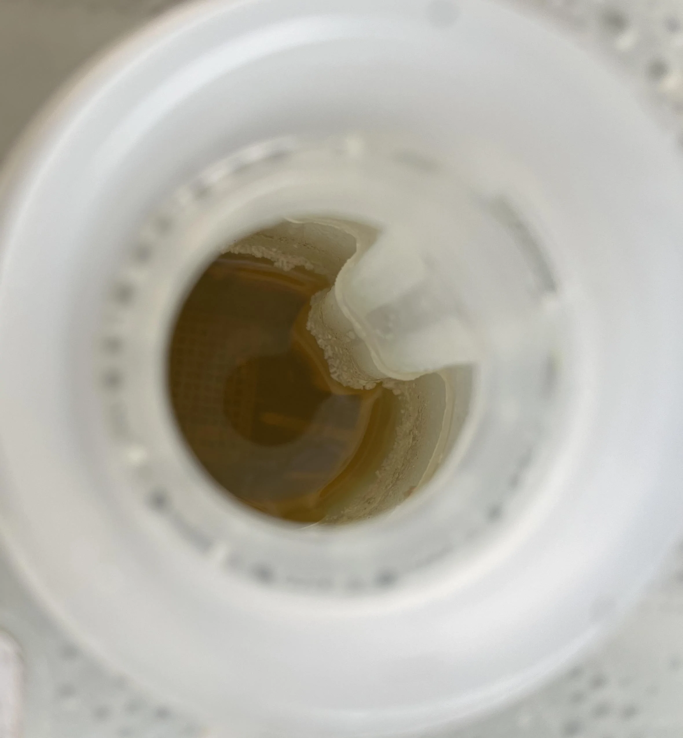

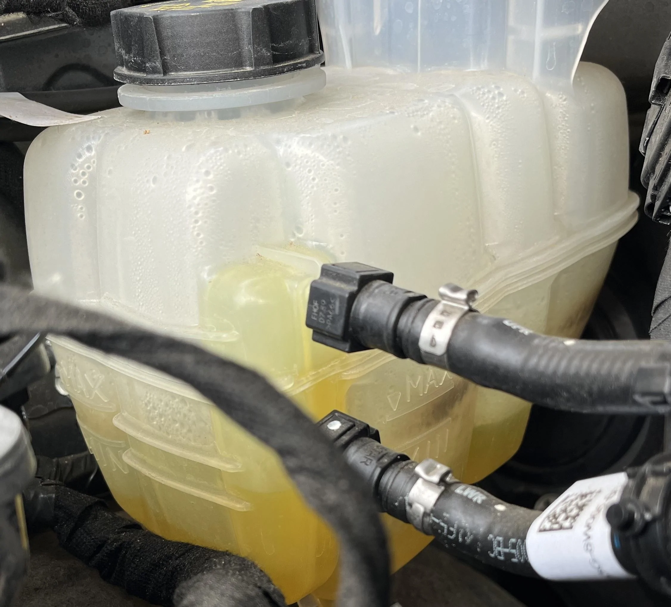

22' 2.7L with 12k miles.
Very slight coolant smell coming from the passenger side but no visible leaks.
Coolant is below the min mark. This does seem to be a common issue from reading here and else where.
Brown residue in the overflow tank and crystal like build up.
Factory fill, I have not added to the system.
Ford Bronco Coolant issues coolant1
Ford Bronco Coolant issues coolant2

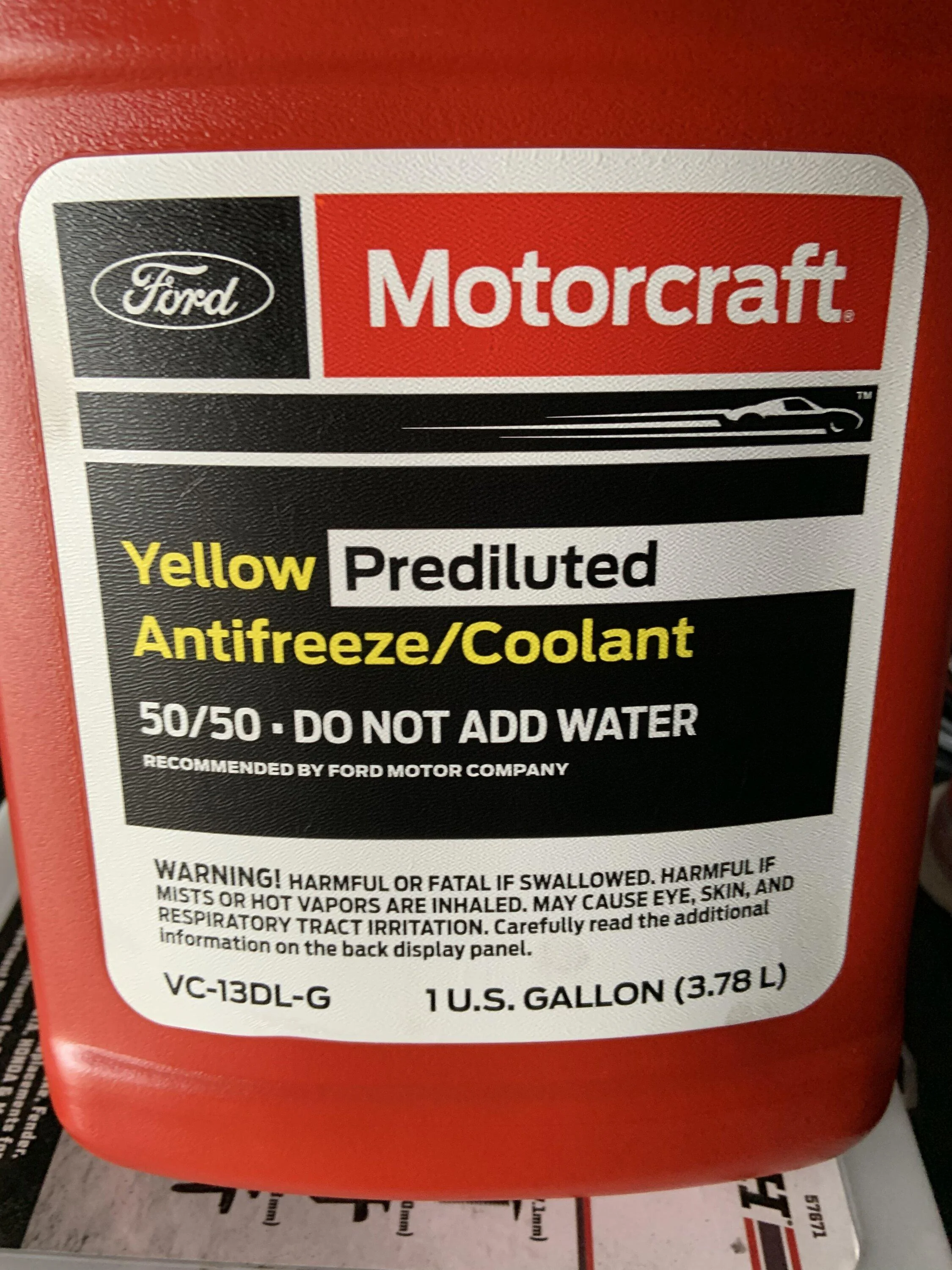

Here’s what you need to top it off
Ford Bronco Coolant issues F6106BC4-99E9-442A-B514-46FEF79B403F

I've had to top off approx. 12-16 oz. of fluid throughout my 18k miles.
However, I don't have the brown residue/crystal buildup that you're showing. My fluid still looks relatively new.

any cause or resolution to this?
Trail_Runner
Me
May 27, 2022
77
124
MI
2021 F150, 97 Jeep TJ, 2022 Bronco
The level didn’t go down anymore.
The dealer did pressurize and check for leaks. Non were found.
