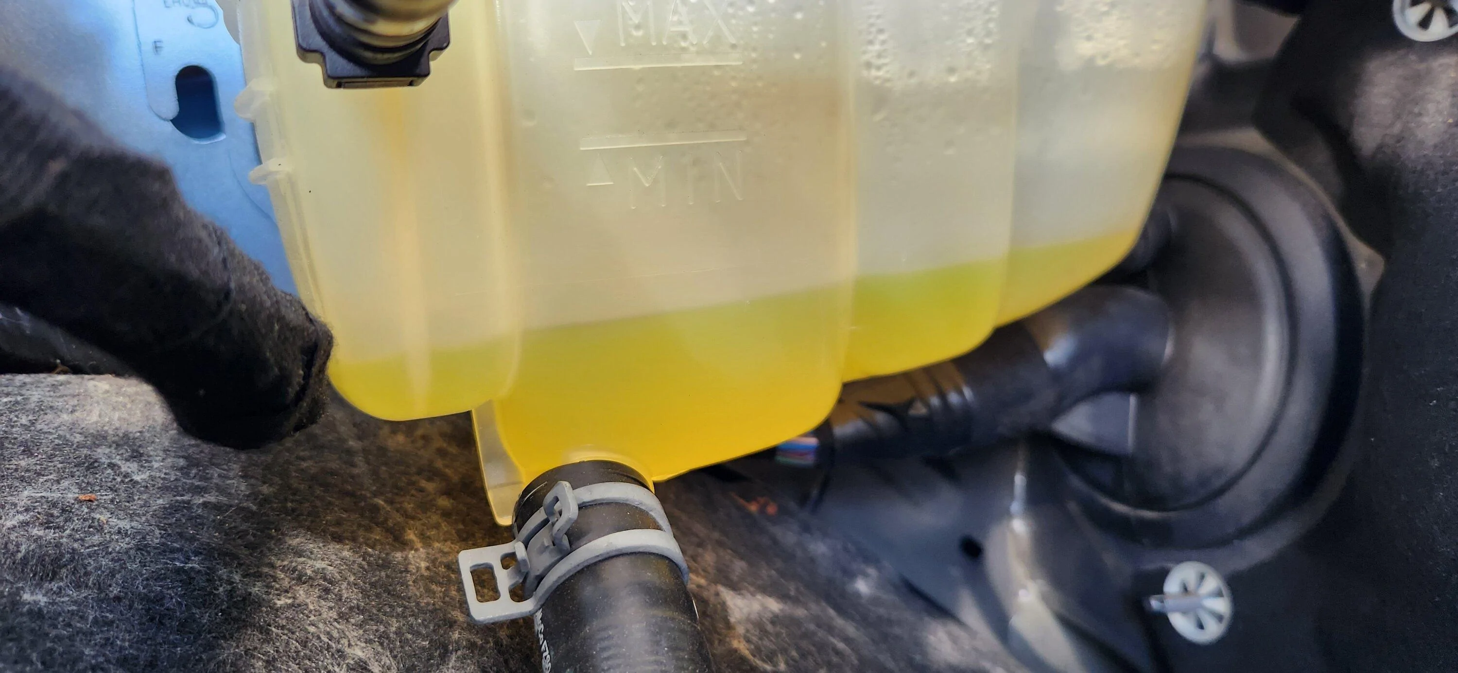

Anyone have any resolution? I just found my 40k mile 22 2.7 with an empty reservoir (cold) when warmed up it came back in a bit but still well below min line. I've topped it off but not sure what the loss rate is yet if at all. I have an appt in a few days to get it checked at the dealer. Not sure if the techs topped it off at last oil change or not.
