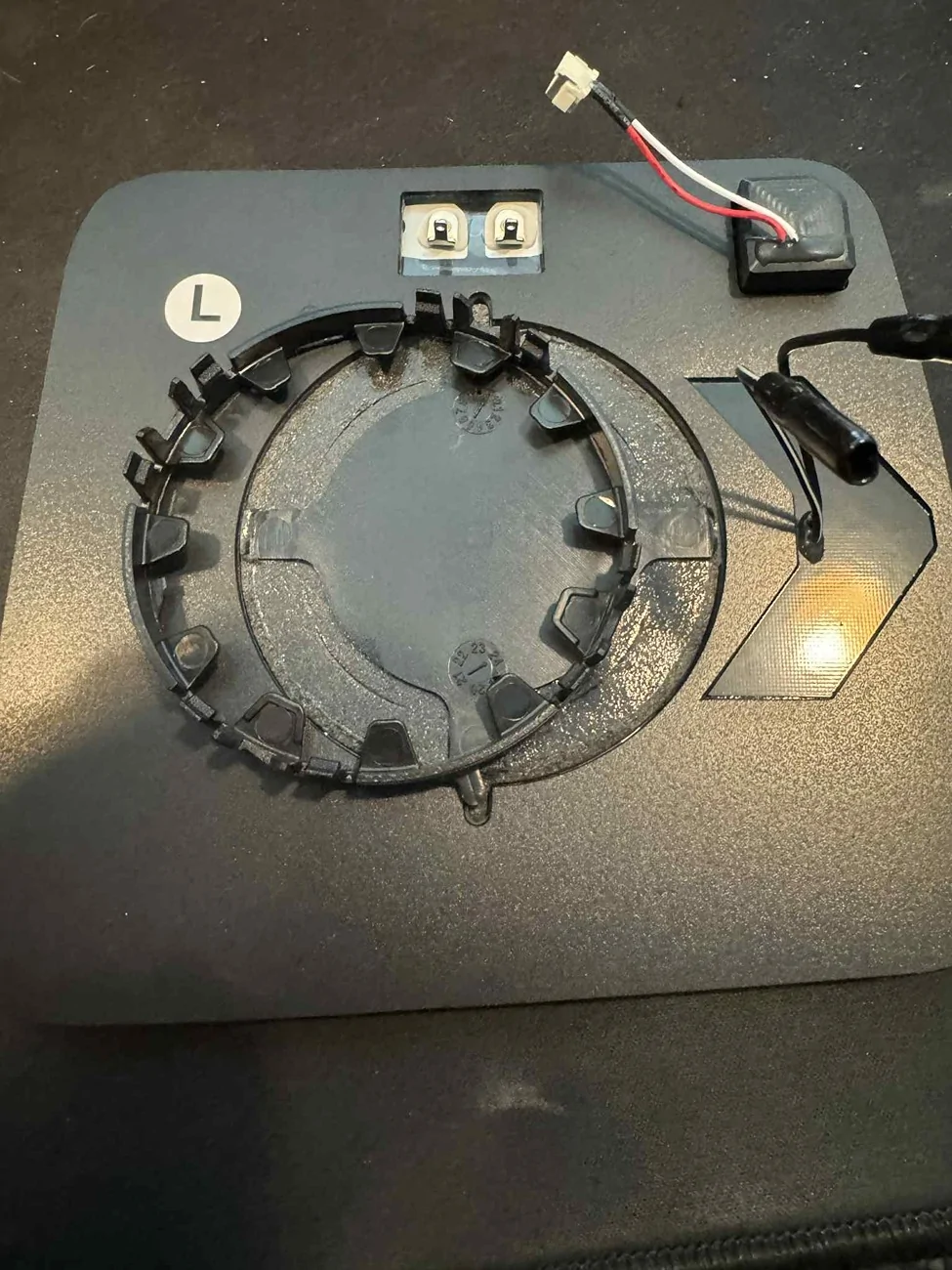

Did the mounting ring break off from the mirror base? These Wolfbox mirrors are much better in that regard because the base and mounting ring are molded as one piece like the OEM. It just needs BLIS fixed.
How'd you guess? lol!

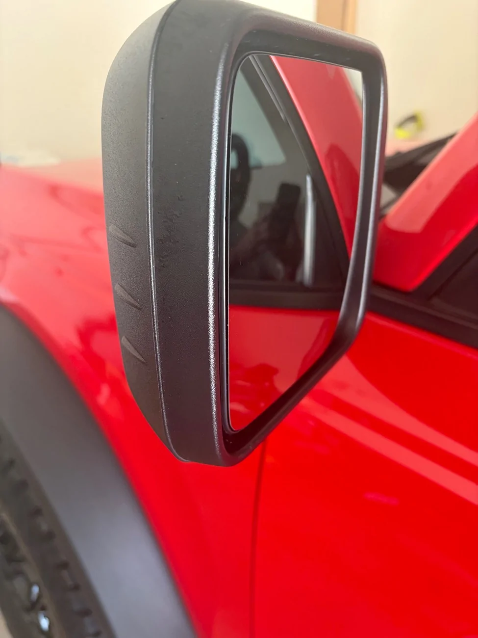

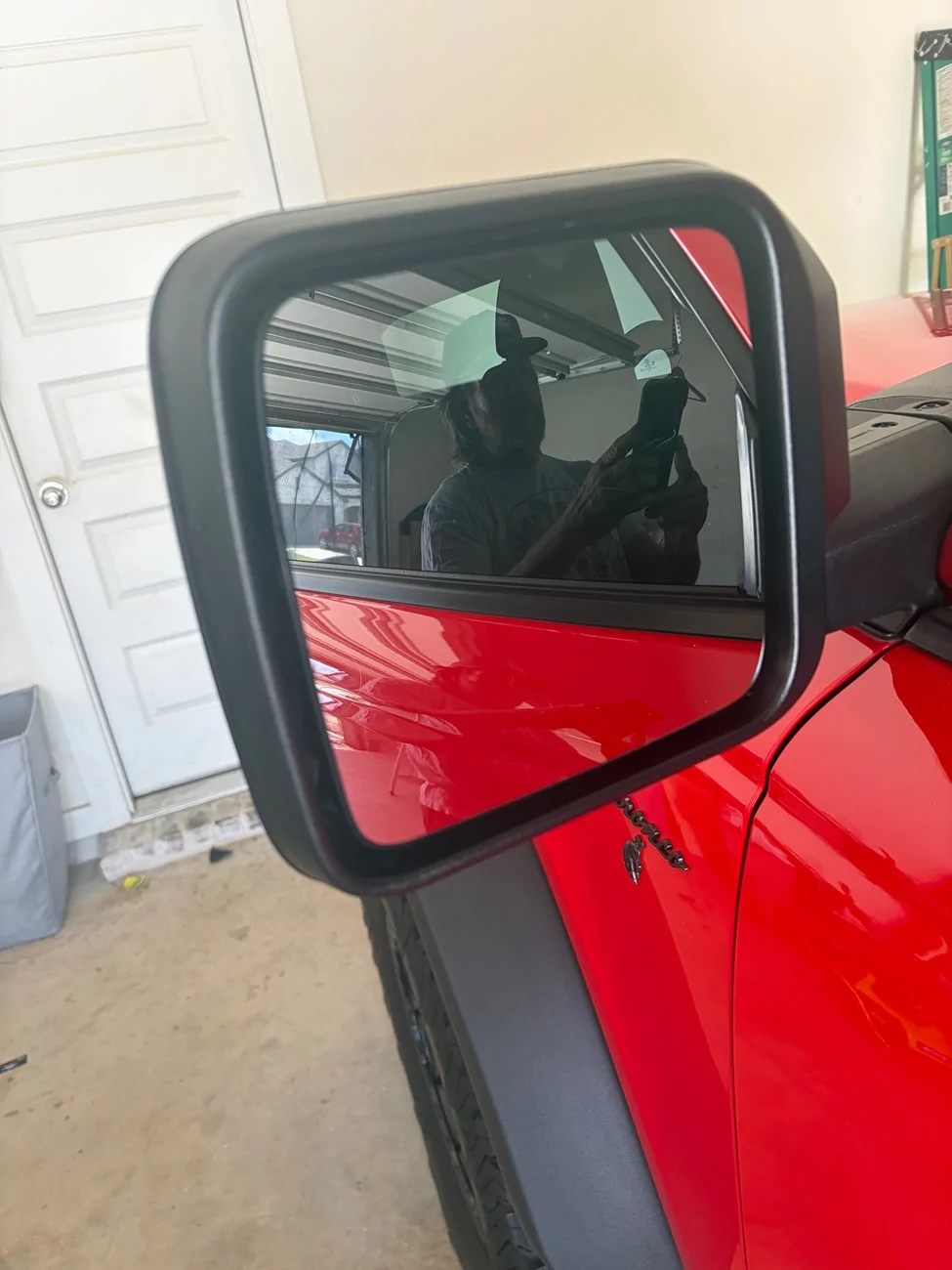

Just installed mine in 4 minutes.
No, OEM lane change lights do not work, it doesn't matter because these are so good.
Leave lane change harness plugged into its female receptor, electrical tape it to inside of mirror housing.
NO CODES!
If left unplugged, codes everywhere.
For the money, these are a no brainer.
Should have come from the factory this way. SMH?!?!
