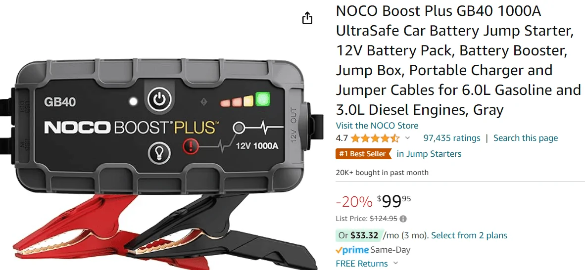

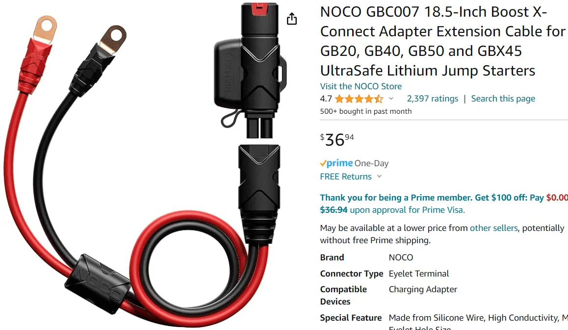

I will never ride around with jumper cables again. I've been using NOCO's power boost for years along with the adaptor cables that I attach to the battery and leave on forever. Nothing is easier.
EDIT for clarification: I leave the extension cable on forever, as it has a cap to protect it from water, dirt and mud. I do not leave the Boost plugged in. The cable just makes life easier, especially if you have a car that the battery terminals are hard to get to. It does away with the need for the alligator clamps (unless you are jumping someone else - so I still have those in the case).
I keep the case with the boost inside - usually under the seat but it gets moved around.
End of edit.
The adaptor plugs right into the jump box. That black adaptor plug piece is for a trickle charge that they also make.
I've also created other connectors to make it plug and play with an air compressor so I never have to use the allegator clips, at least on my vehicles, I carry the clips in case I have to jump someone else.
Edit again: By this I mean, I spliced plug connectors to my compressor so I can plug it into the extension cables hanging from the battery terminals, again so I don't have to use the clamps.
End of second edit.
The point is, these things are life saviors and you don't need anyone else to jump you. As far as the Wolfbox, I would think it works, but I've only owned NOCOs and have bought several others for people in my life and will swear by them.
Pics from Amazon.
