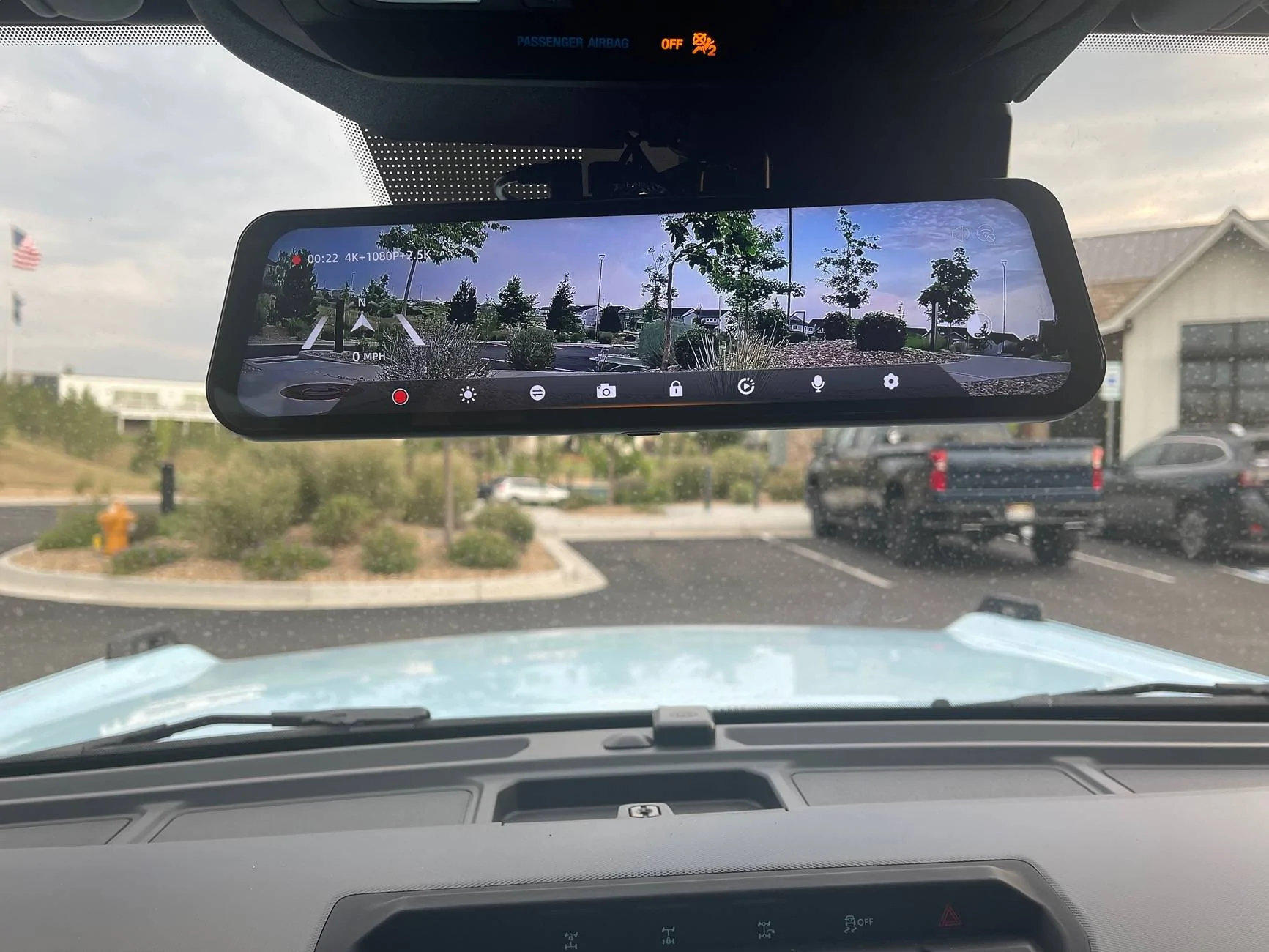

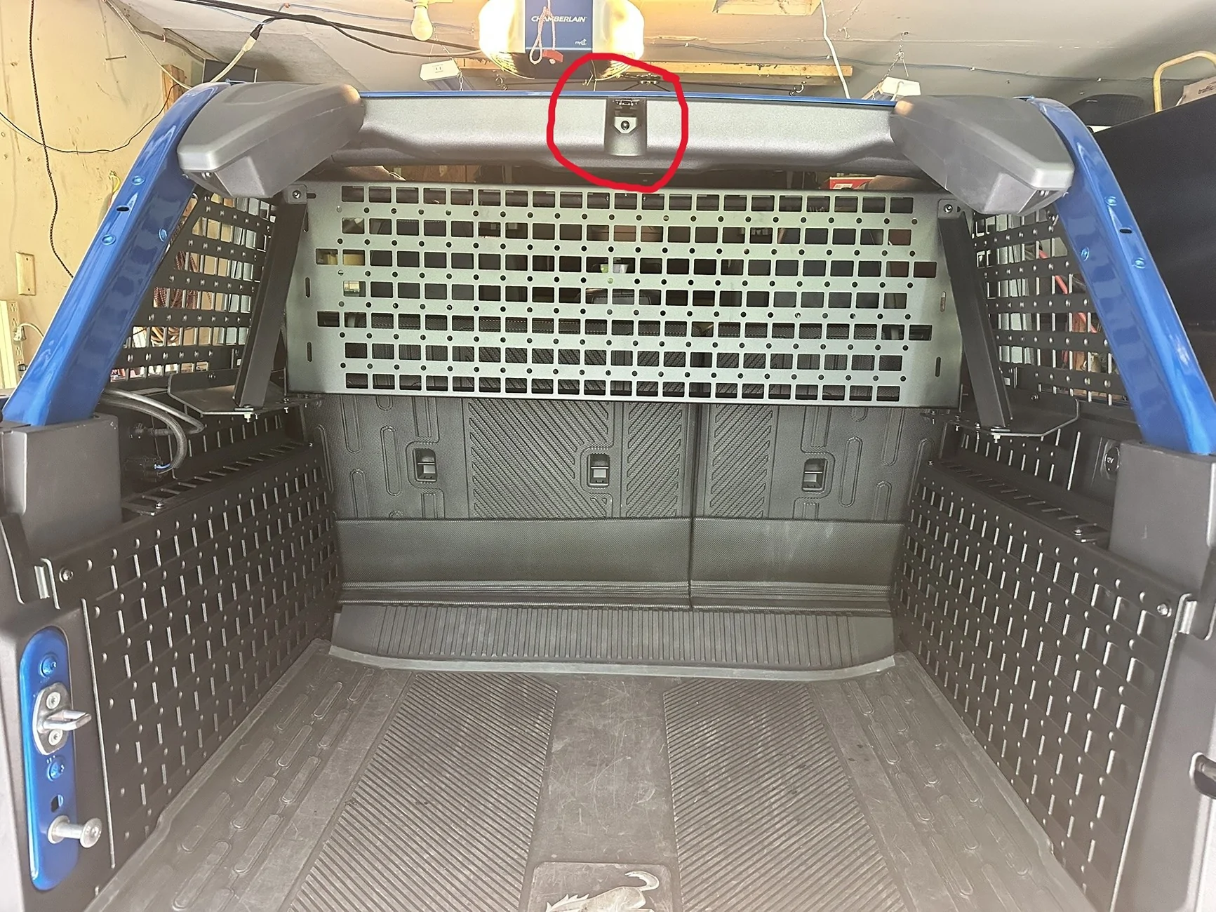

This is a good idea. Are you able to zoom in the instance of getting a license plate behind you? Was it easy to hide the wires?
Haven't tried to zoom in on a plate, but since that is a function of the mirror, I assume so. Picture through glass is plenty clear enough. I can see people's faces through their windshields without zooming so I'm sure. Wiring was a breeze. I have wired other items through the rollbar/airbags path such as in-cab lighting so it wasn't the first time I had done it. Overall install was an hour probably.

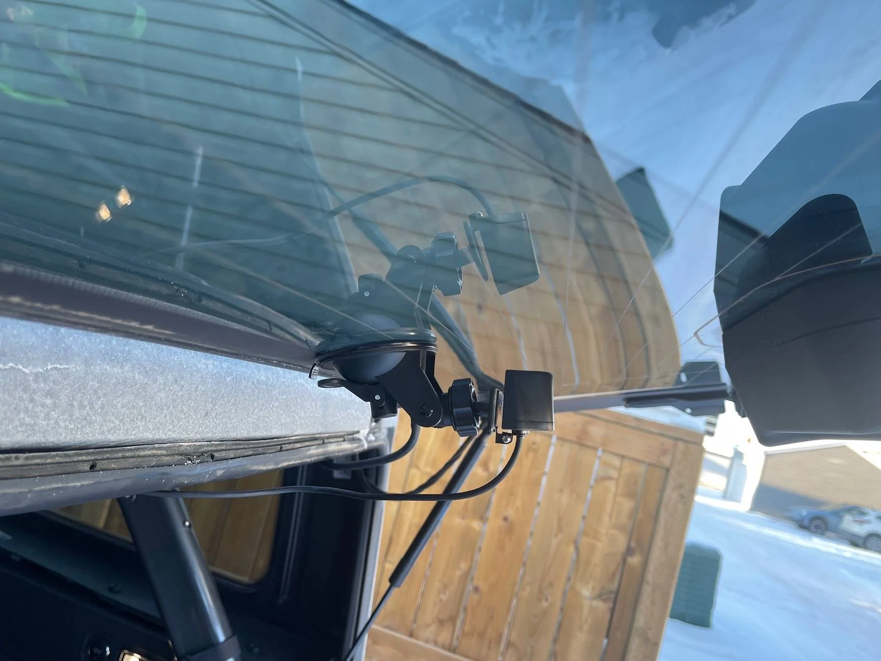

I got a suction cup mount on Amazon and stuck it to the rear window.

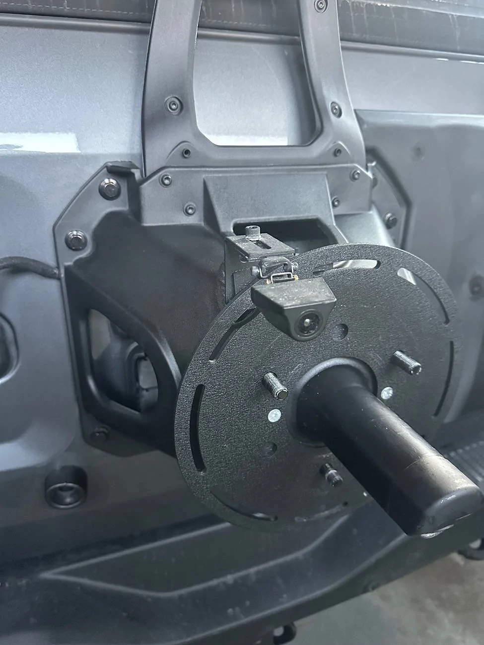

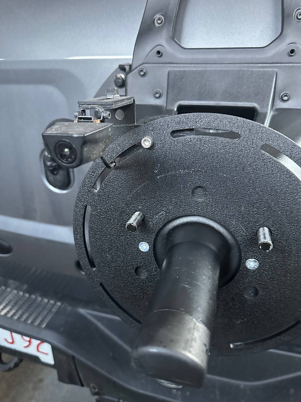

I just sent you a response with links to the products I used but adding here to share with the community.

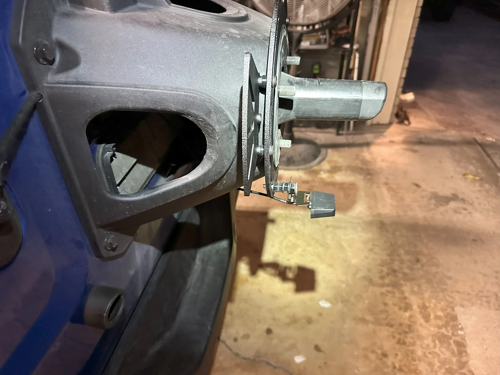

At first I purchased an EchoMaster mount that I thought was going to work.
https://www.soundoftristate.com/echomaster-phdmount
Unfortunately it did not fit the bronco spare tire carrier bolt pattern.
I bought the AGS light mount but just used the circle part.
https://agsoffroad.com/products/2021-ford-bronco-in-wheel-light-mount
I then used the EchoMaster adjustable pieces to mount the camera so I could adjust it once attached it to the AGS mount.
It works great - solid. No bouncing when driving around and the camera stays in place - doesn’t fall or need constant adjustment.
Perfect solution since I have a soft top and you cannot see anything g when the top is all the way down.
My only complaint is when it rains the camera gets wet and the view sucks. I recently tried to put a cover over the camera but it hasn’t help much.
Still 99% better than no camera and worth the money and install effort.

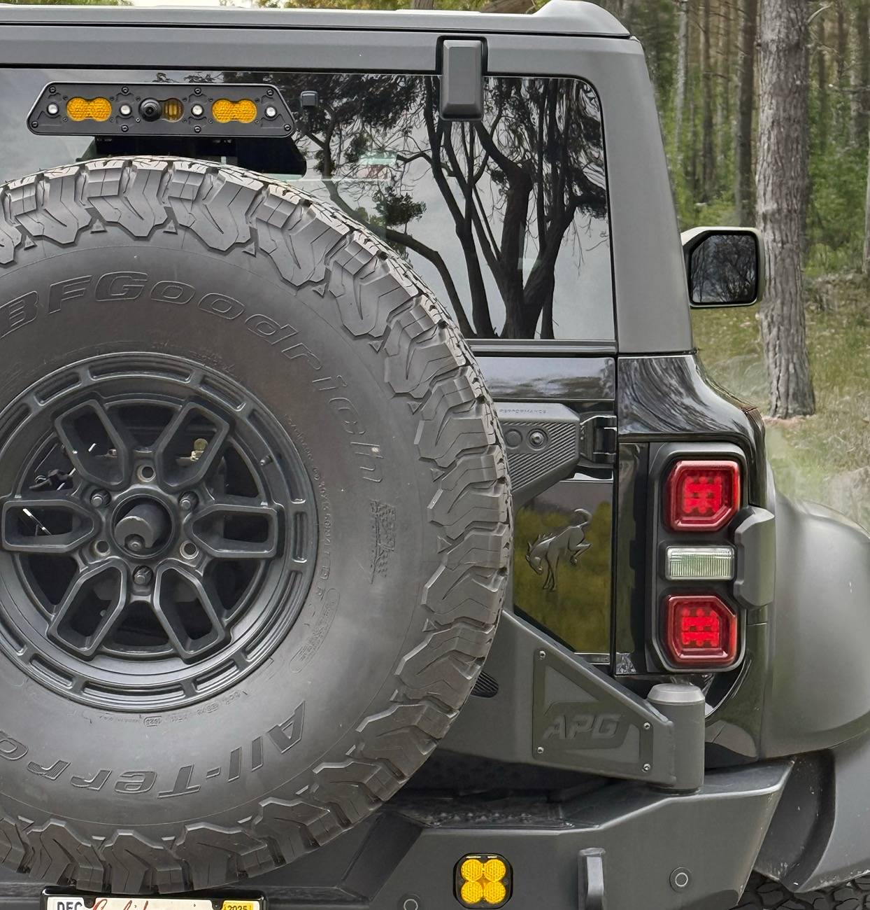

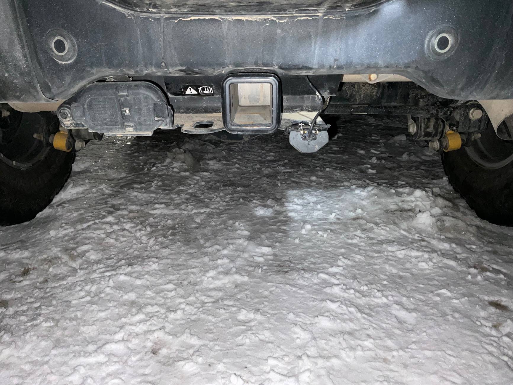

This is working great for me.
Make sure you put heat shrink tubing over the rear camera connector. It is not waterproof.
And big thanks to WolfBox customer support who had a replacement sent out asap.
With my setup you can also have a ‘rock crawling’ mode by flipping it down with the included bracket. No need to re-mount. It swivels.
Can you share a pic of what both views look like from this position (rear facing and rock crawl use)? This mount option is intriguing, since I don't pull a trailer....

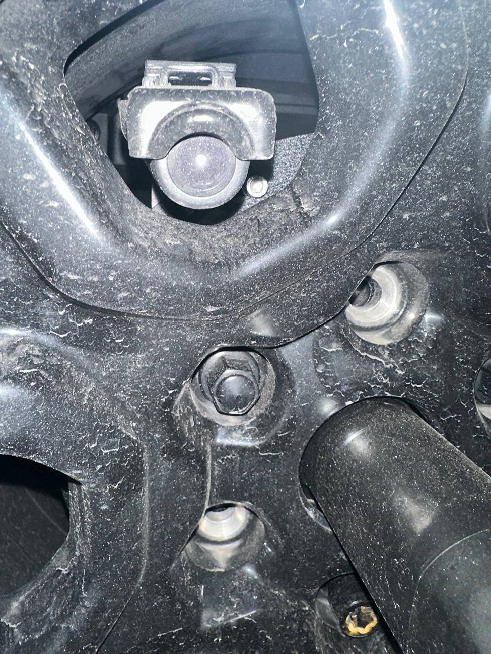

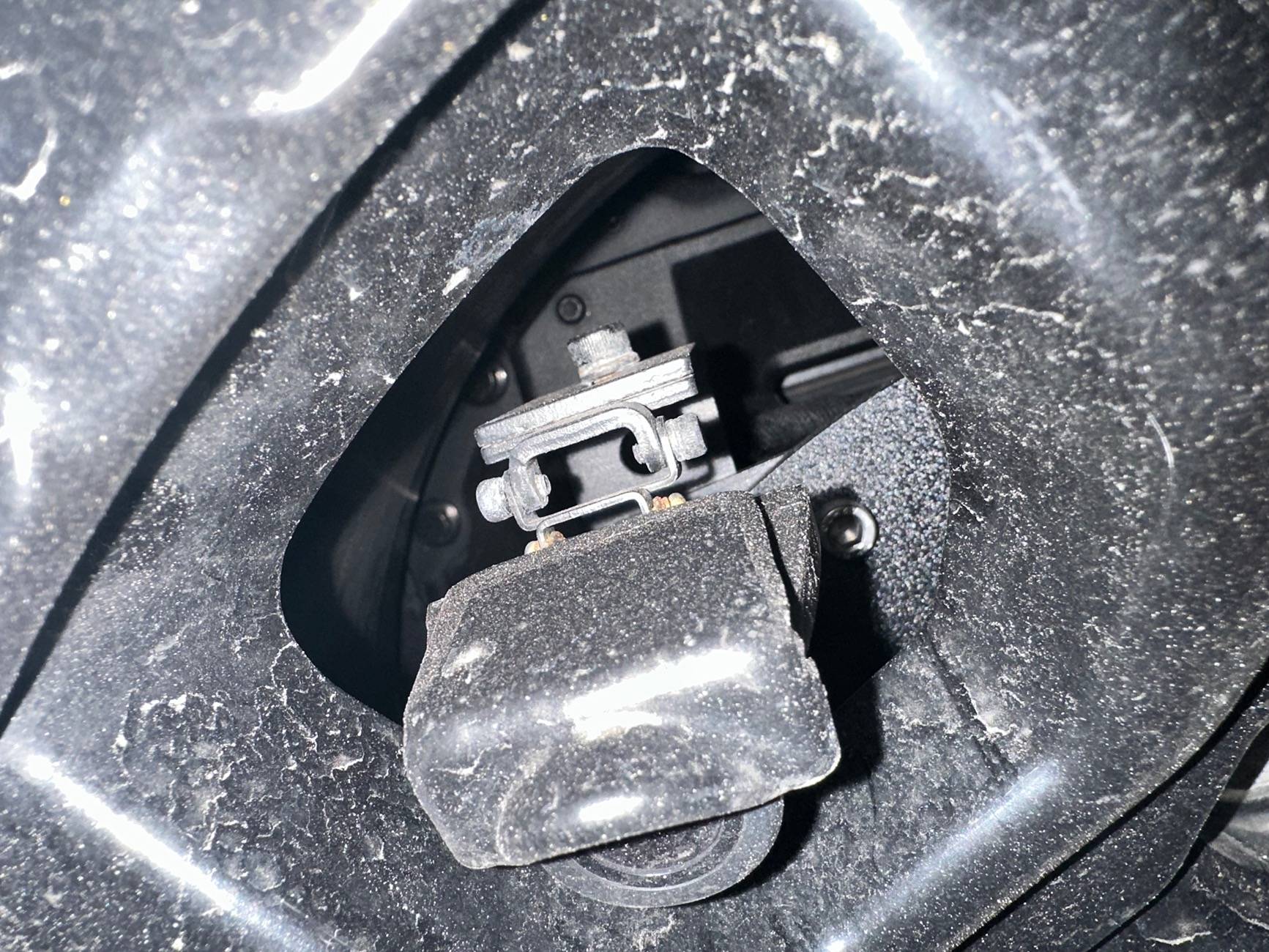

I just went with the same approach as some have already shown, inside the spare. Only difference is I modeled it and printed in PETG-CF, yes, I'm too cheap to spend the $100+ for what others used. Next I'll modify it again to have a spot for my air chuck.

How much to print me one?
If you want, just pay for shipping and cover the cost of filament... probably like a $3-$5 print. I'm still tweaking it slightly as it hits by like a 1/16" when putting the tire back on. But if you don't mind it being dead nuts I can probably print one this weekend. Just picked up a spool of ASA (black) for printing this as it has better properties for using in the elements.
Edit: Forgot to ask, I assume you have the Sasquatch wheels? That's what I designed this for, and it probably won't work with other wheels.
Edit #2: According to Wolfbox, the camera isn't meant to sit how I have it. Sure I can flip the view horizontally so it appears correct in the mirror, but then it records backwards. So in order to get it to record and look the same in the mirror, I need to flip the camera, therefor will need to raise it up a bit.

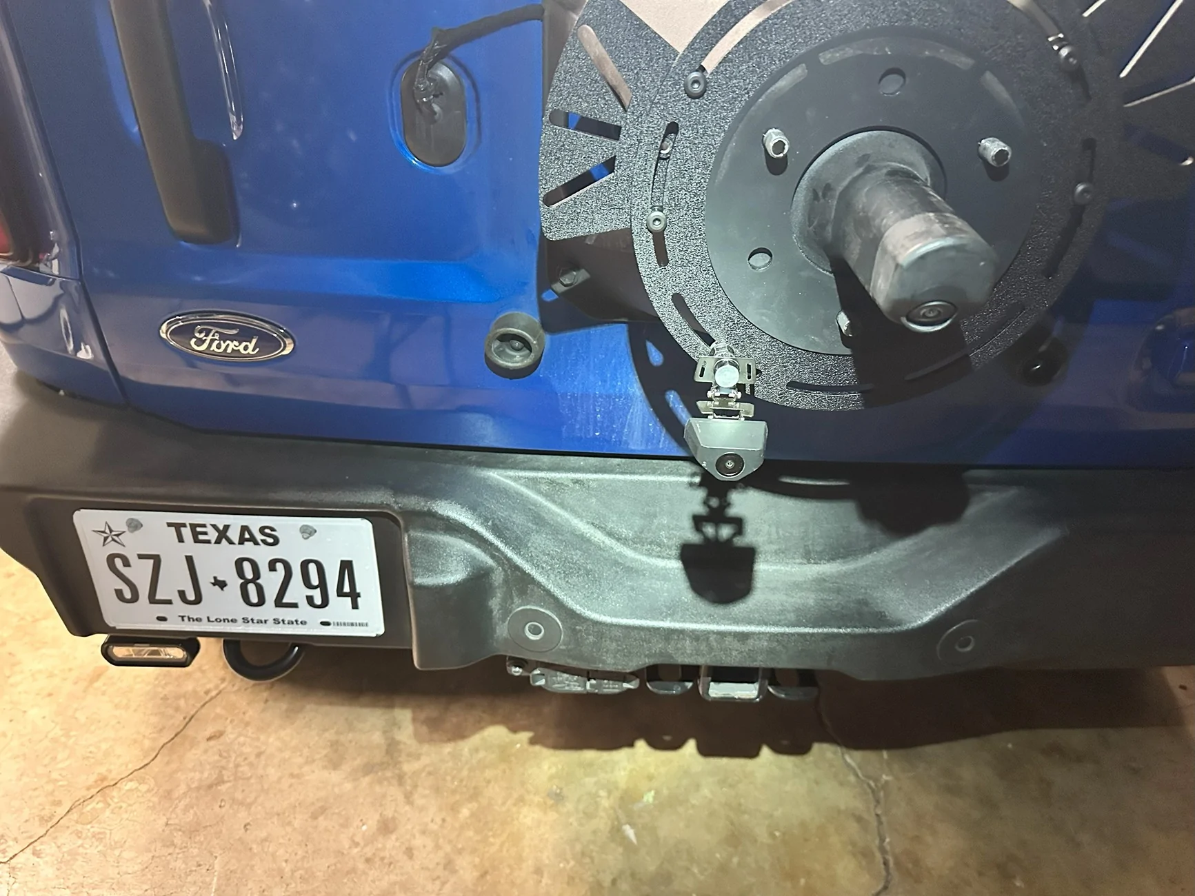

I originally mounted mine on the roll bar. This worked excellent until I put my top on. Then I couldn't see more than one car length behind me. So I relocated it to the spare tire with a AGS mount. I"m going to change it, right now it's more of a semi permanent mock up done with what was handy at the time. I'm also moving it as high as possible. It just looks weird seeing cars that low.
